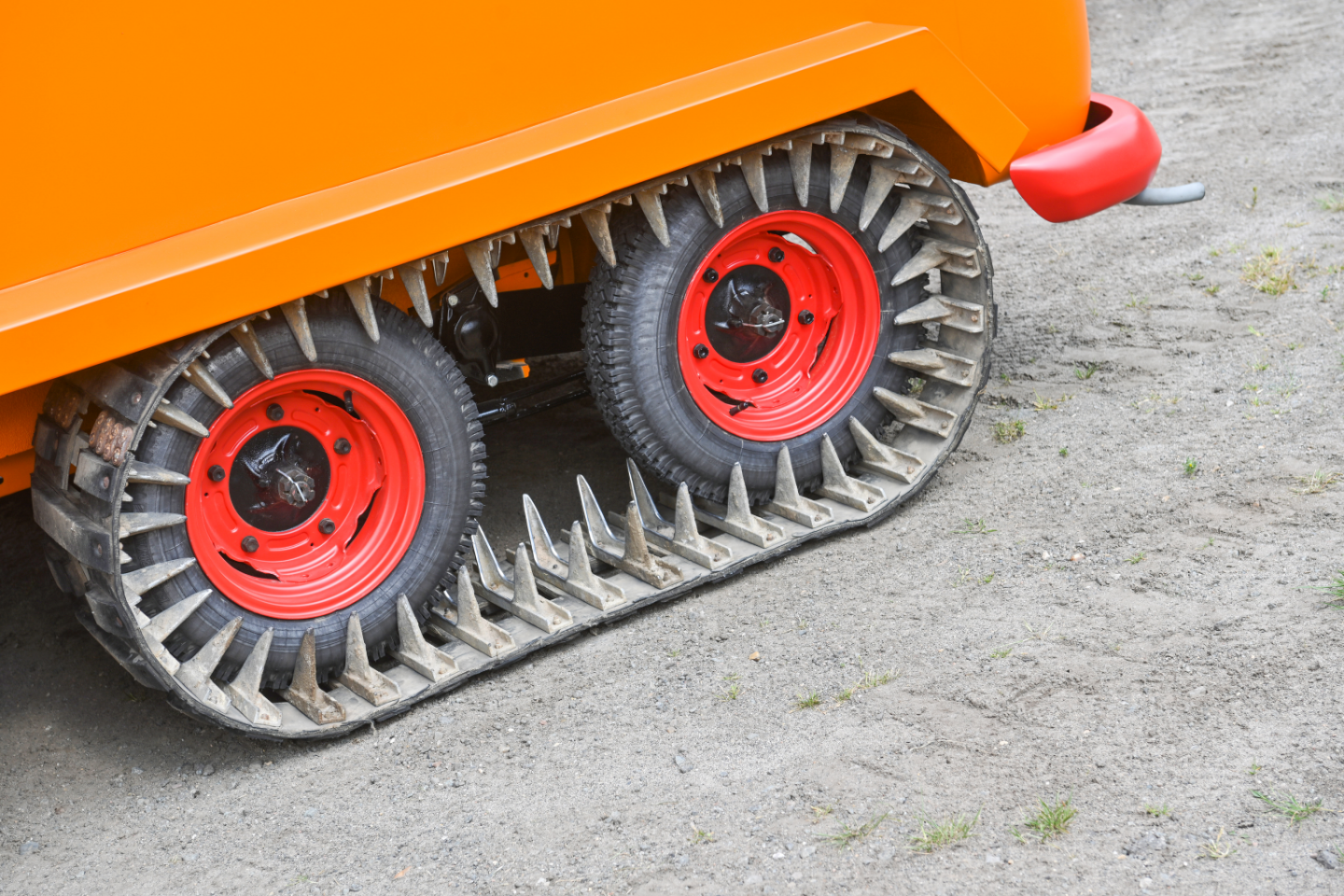

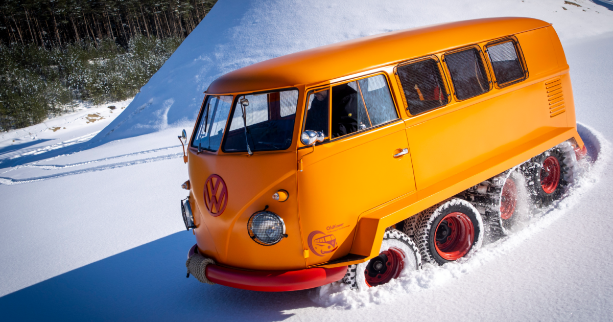

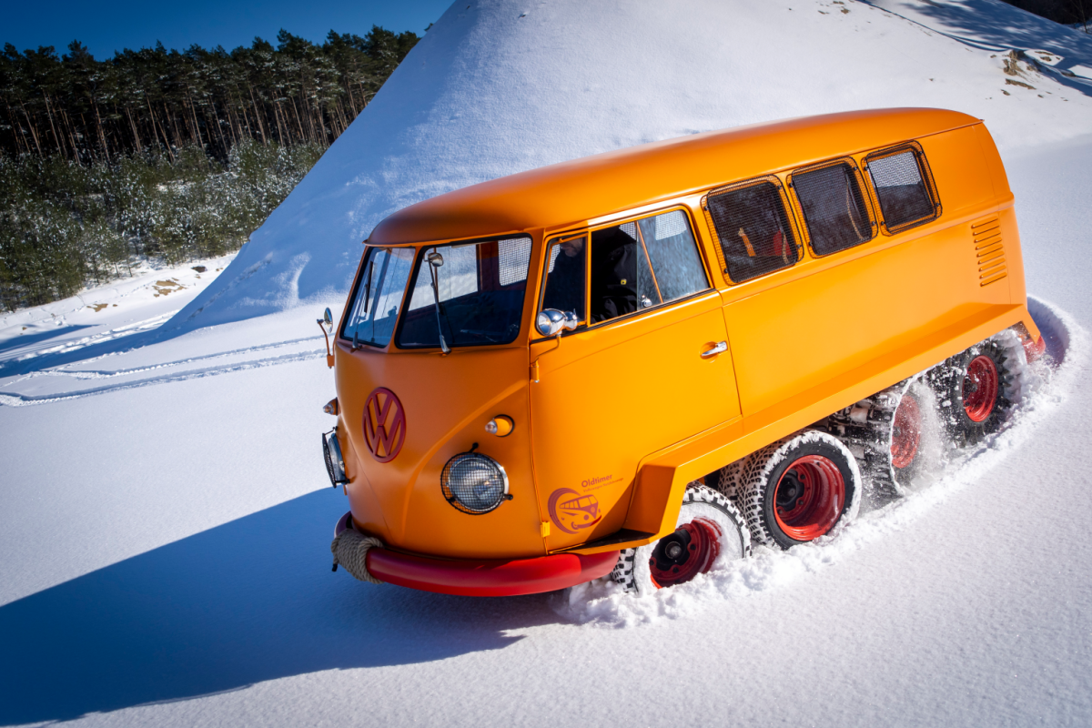

What the Viennese mechanic planted under the orange-painted Bulli body was, at the front, a steered double axle with dual rough-tread 14-inch tyres and, at the back, another double axle with chain drive. The chains were mounted on 13-inch wheels and a construction of his own design made of aluminium elements with rubber blocks two centimetres thick to spare the asphalt. As a result of the dual front-axle steering the turning circle was less than 10 metres – so it could almost turn within its own circumference. Each wheel was fitted with a brake. An automatic limited-slip differential ensured evenly distributed forward propulsion even in deep snow. The T1 drew its power for this from its standard 25 kW / 34 PS flat engine with a cubic capacity of 1,192 cc. The Half-track Fox reached a top speed of 35 km/h and was thus only slightly slower than the animal kingdom member from which it got its name.
Kurt Kretzner wanted to build a tracked vehicle that would be very easy to steer. It was precisely for this reason that the mechanic opted not for steering via chains on every axle as is found on a bulldozer, but instead for a half-track solution (with chains only on the drive axles) and an almost standard, albeit doubled-up front-wheel steering mechanism. And that’s also how the inventor used to promote the Half-track Fox: “The new, ideal, easy-to-drive Half-track Fox that lets you safely and comfortably master all difficult terrain. Snow, sand, stony ground, mountain meadows, small streams and woods can all be driven through in this vehicle.”

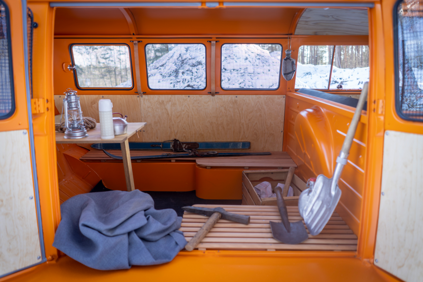

The VWCV Classic Vehicles team also got the mechanics back into as-new condition. The interior, too. The team was able to give free rein to their creativity there, as there were no onerous specifications. Wood components in beech and pine were individually adapted to the space inside the Half-track Fox, and practical tool holders installed. In February 2022, the time had then finally come – the Half-track Fox again channelled its way through the snow. And did so, indeed, with unusually good uphill capability: following the extensive restoration of the four-axle T1, the team of VWCV Classic Vehicles could see for themselves that the driver was more likely to capitulate on steep climbs than the Half-track Fox!
