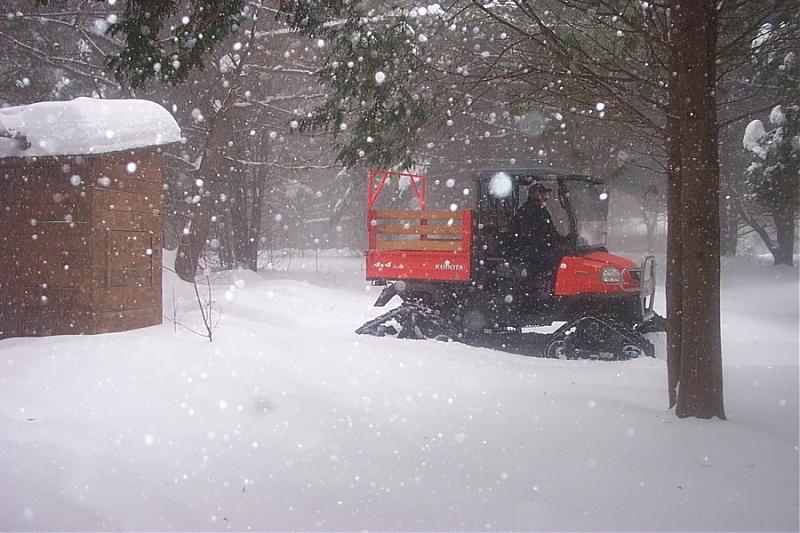

This is what I am using
Biggest problem I could see with longevity was the track sections. They appear to be made of some form of super plastic. But they did have cracks and rips in them. I added a 3 ply rubber band all around both edges to strengthen the weak spots. Lots of bolts and holes to drill. I could find replacement track sections no where. UNATRACK is out of buisness I believe, the phone number and address on the back of each track section does not work any longer.{Quote}
If I am not mistaken, those look like some of the earlier snowmachine tracks that were converted/used to be used on your Unatrack by the manufacture. If you check the length, width and pitch, I would bet a dime that you can still find new replacement tracks for it.
http://www.camoplast.com/en/tracksystem/replacementtracks_snowmobile_all.php
http://www.tracksusa.com/
Anyway, just a thought...
Was just out with that and I still can not beleive where the tracks will take me. It is totally unbeleiveable to me. 90 % of the time I was in 2 wheel drive with the differ locked. For the last hour I have been in snow 24" deep and dragging bottom all the time. Only once did I have to use 4 wheel drive. I will tell Santa that I need a heated cab. The sooner the better.
I have had the RTV for a couple of years and only just got the tracks. We use it for gathering maple sap to make syrup and it is usually in March before it sees much winter use. By Mar things are starting to warm up. We don't have the below 0 temps any more.
The whitetail deer are having a hard time finding feed so I just went out and cut a few cedar for them. In the spring I will go back and get the wood that is left in them.
