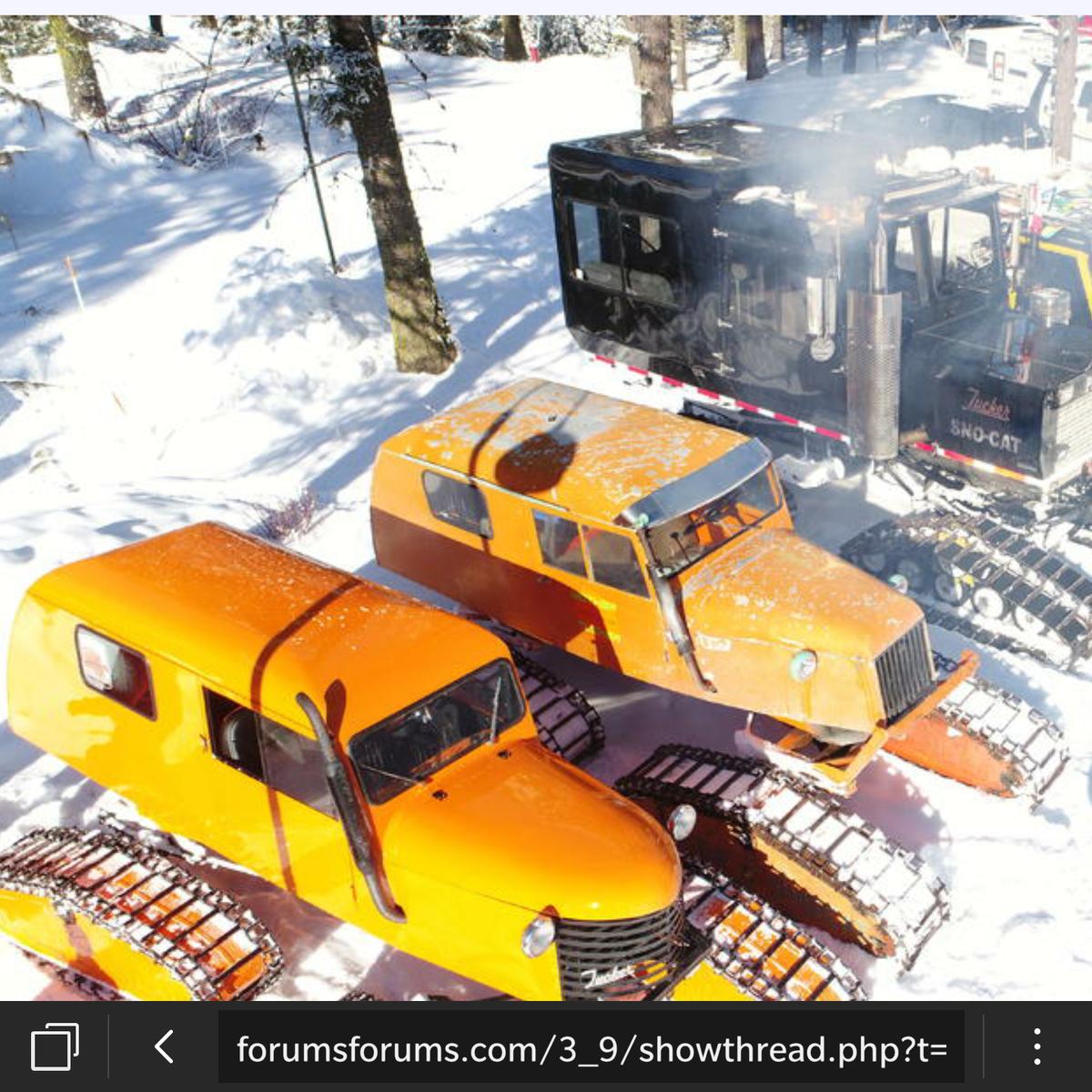

Found this picture on the forum, I believe the bigger cat is a 543 and the smaller is a 443. Hope this helps[

The black machine is a 1700 series rubber track and the two orange machines are both 443's. The early 443's only have one window on a side. I believe the 500 series started in the mid 60's.

My bad, I thought that was user Tucker's 543 but it's missing and exhaust pipe and a window.

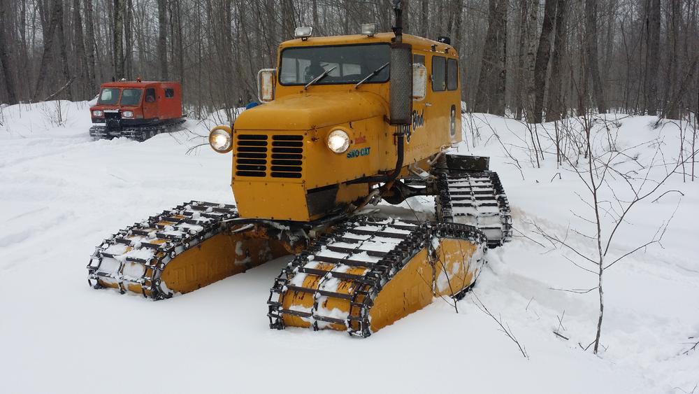

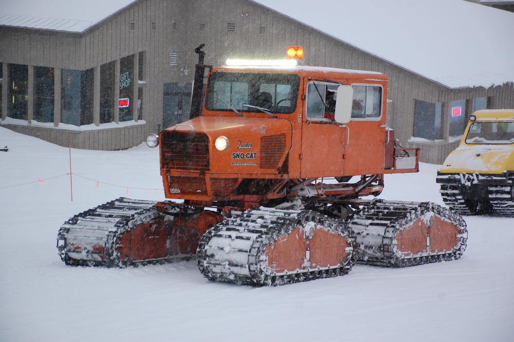

No worries... No one except yourself seems to be chiming in to help him out. The 60's 500 series machines have a center link to strengthen the grousers. The grousers are triangle in shape. The later 70's machines have a different style of grouser without the center link and are a solid steel bar. Both styles are 28 inches wide. Both 400 and 500 series have hydraulic steering.
The 544 (4 door) has a mix of both style grousers and the 543 has all with the center link.

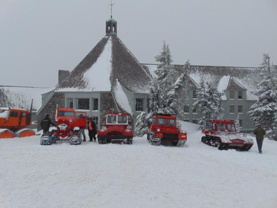

if you have not experienced a Tucker personally, up close, why not fly up to Portland, on April 22, Sunday, and come on up to Timberline Lodge on Mt Hood for a couple of days, would be happy to pick you up at the airport and get you up the the mountain. I will be at the Portland airport at 9:30 picking up another snow catter on Sunday.
Happy to let you drive my Tucker and do know there will be serval other makes and models up there for you to check out, a little knowledge can be dangerous
