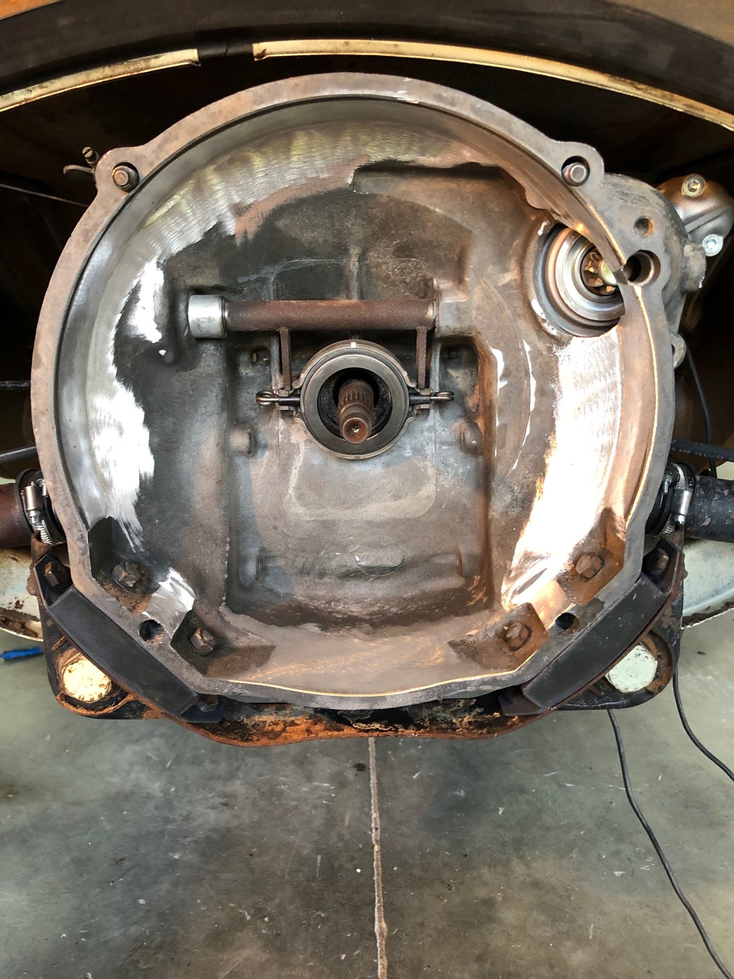

I ordered a high torque starter the other day and then see one with a gear to work with a 6 volt starter ring. I would prefer not to modify my transmission bell housing. How do I know if I have a 6 or 12 volt starter ring?
do yourself a favor and grind the tranny for a 12v flywheel, it takes about 10 minuts with an angle grinder and a 60 grit 3" rolock sander disk
careful that sander digs in hard and fast, i did it to one of my buses a while back, a nice even grind all the way around and blend in , i got a little too close to the starter bushing on this one but i run either automatic vw starters or the aftermarket reduction unit so that doesnt matter;)
