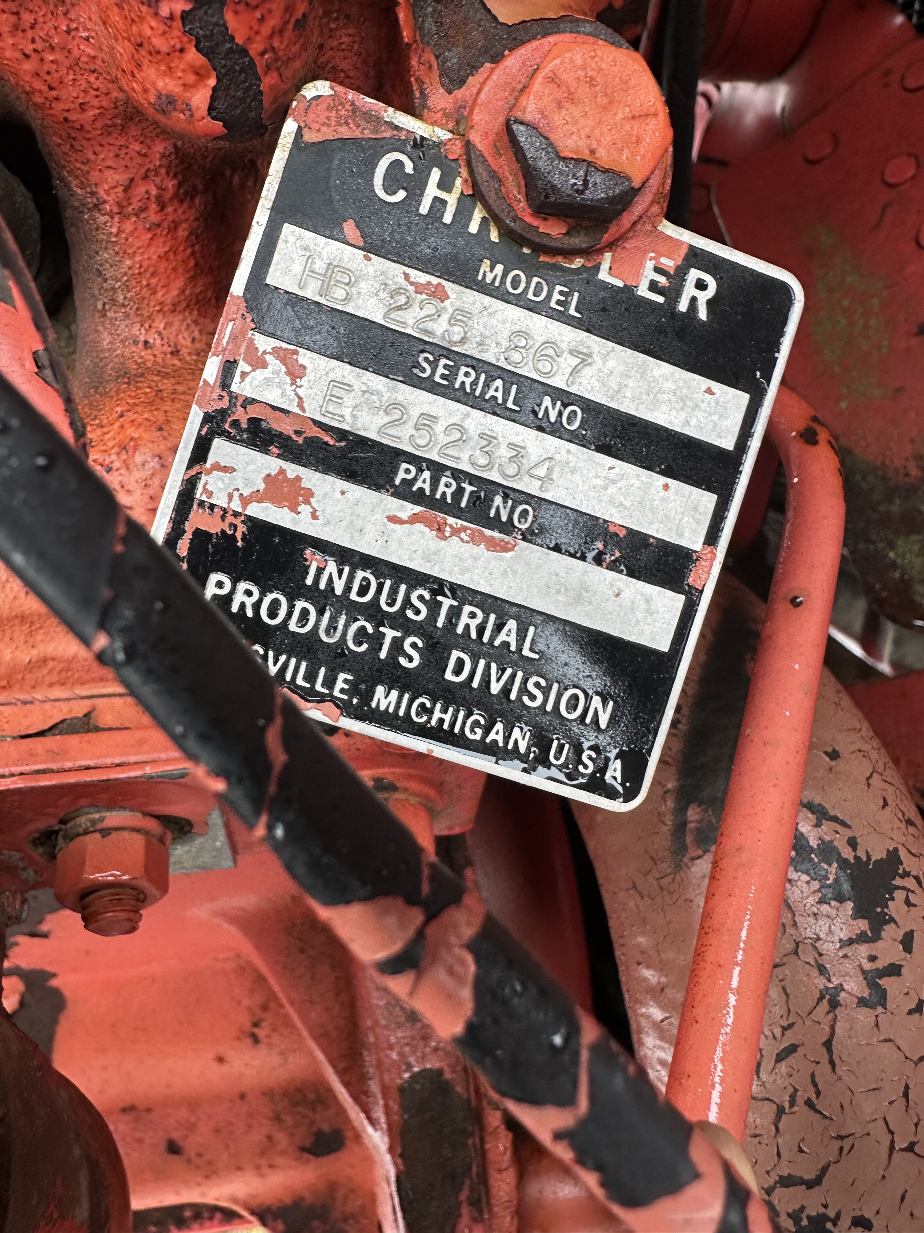

What year is your 601? I was under the impression that they all got the 240 (military spec) or the 300 (civilian spec), though given the parts-bin nature of their construction who knows. I have so far been unable to positively ID the engine model in mine from the data plate and since the cat is a 4hr drive away I can't use physical clues on the engine to ID it, but have always assumed it was either a 240 or a 300.
Mine is a 63 or 1964.. the 223 has the intake and exhaust on the drivers side. The 240 has the intake and exhaust on the passenger side. The 240 wasnt produced by by ford until 1964 which probably means it wasnt available till 1965.

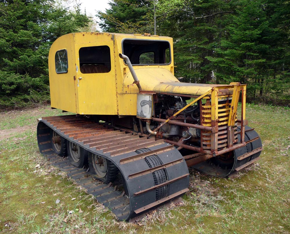

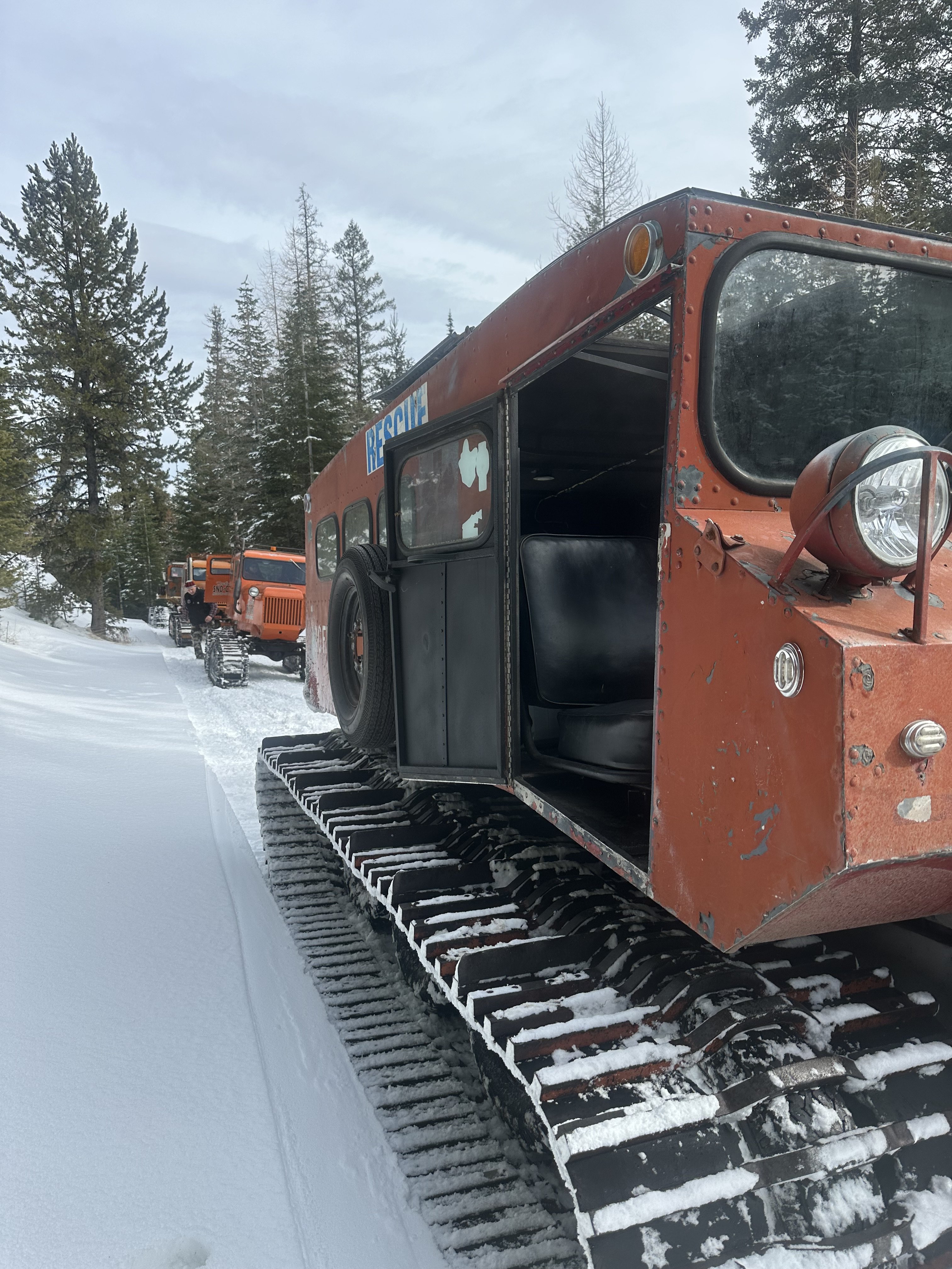

I have a Thiokol 601B RangeMaster and a spare one for parts. I have owned them for about 40 years and at one time stripped the usable one down to the last nut and bolt. I can tell you a LOT. Early on I counted ~15 601B thiokols in the state (They are the ultimate hunting/off road rig.) Years have passed and people have passed leaving me with some parts that I needed that are made from UNOBTANIUM (un available or findable). however the major components are able to be found out on the open market if you knew where to look.
Tracks and Grousers-Unobtanium.
Drive Sprockets- FallLine Manufacturing Reno Nevada.
Rear End-Only the OC15 was used from Oliver tractor- Unobtanium.
Steering Slave cylinders-OTC Powerpacks available at most hydraulic stores.
Transmission-Ford 4-speed (Got mine from a UPS delivery truck as a complete replacement powerpack).
Engine-Original was a ford 240 in line six, mine came from above as a ford in line 300 six.
Radiator -I found the right one at Modine radiators.
Axels-Pryor Axel, horse trailer #2500, a common weak point as the spindles kept breaking off, replaced with a #3500 and still lost a few next will be to cut off the axel stub and weld a small flange to it and a mating flange to the stub shaft for easy replacement in the field.
Wheels- Horse trailer or farm implement wheels, (Get the heavier ones that don't bend as easily).

A little information on tires, the front tire is the very hardest to replace as you need to split the track. usually I have found that a stick or something poked its way thru the rubber sidewall or rarely the tread. When I rebuilt my RangeMaster I bought 10 new rims and 10 new tires. I had the tire shop mount them as tubeless but then had an innertube installed with the stem oriented to the stem hole but then abandoned there. they were aghast and didn't want to do it saying that it wouldn't balance! I don't know about others but I usually travel in 3rd gear and with the gear reduction of the OC15 at 23-1 that tops out at around 20mph so no problem. it goes like this, you get a flat, you pull out the foreign material and use a pair of pliers to rip out the rubber tubeless stem and fish the tube stem up through the hole and inflate it. Presto you are back in business! After I came upwith that ALL the rigs up on the North Slope (Mostly Nodwells) did the same, everyone wonders why they didn't think of it before.

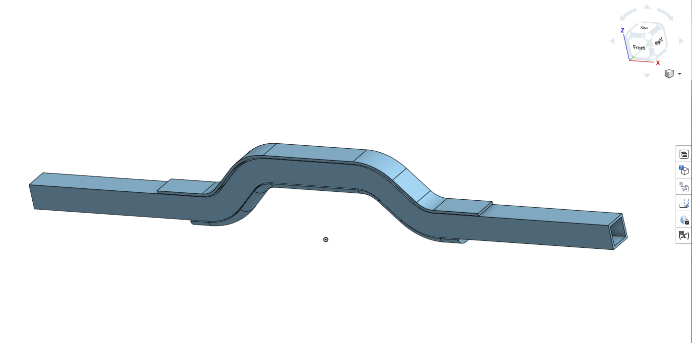

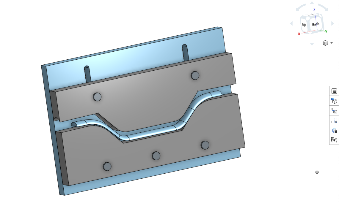

It is my understanding that grousers have been NLA for a long time, except maybe for some random folks who have built their own. I'm going to need a full set eventually, I've been working on designing a set of press dies to make them, but haven't gotten beyond the design stage since I'm still a few years out from needing them. Also having a somewhat difficult time finding a source for 1-1/4" half oval steel stock for the tire guide portion.
The belting holes will probably have to just be drilled rather than punched like on the factory grousers. Also planning on putting a couple of beads of hardfacing along the outer surface of the flat wear bar to limit wear when running on hard surfaces.
