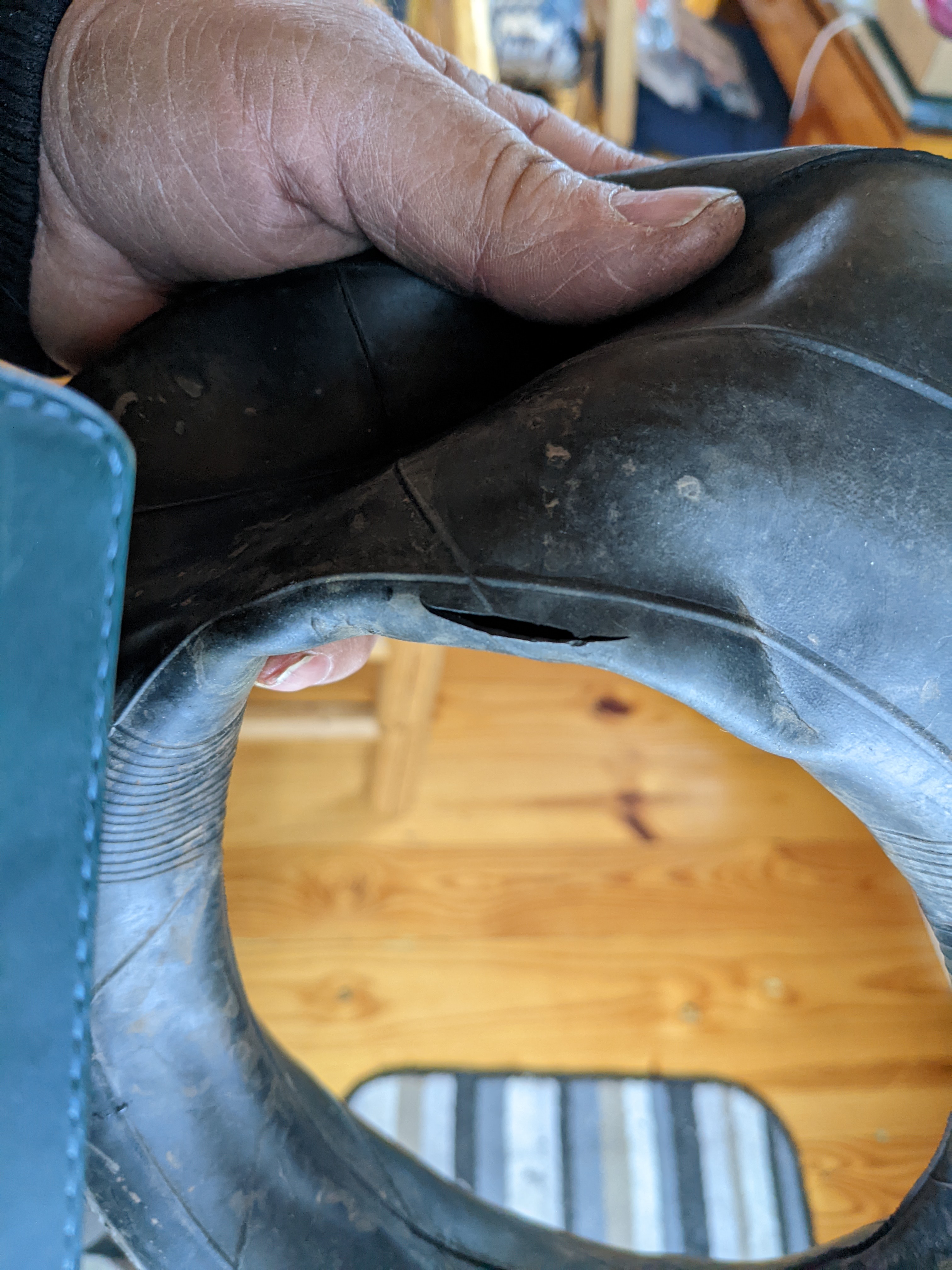

I got the tire and track back together this morning. The tube I put in last month was split near the valve stem. I hope the new one does better. I have to make a run down the hill late tonight to pick up my son and his wife. It's 12 deg right now.

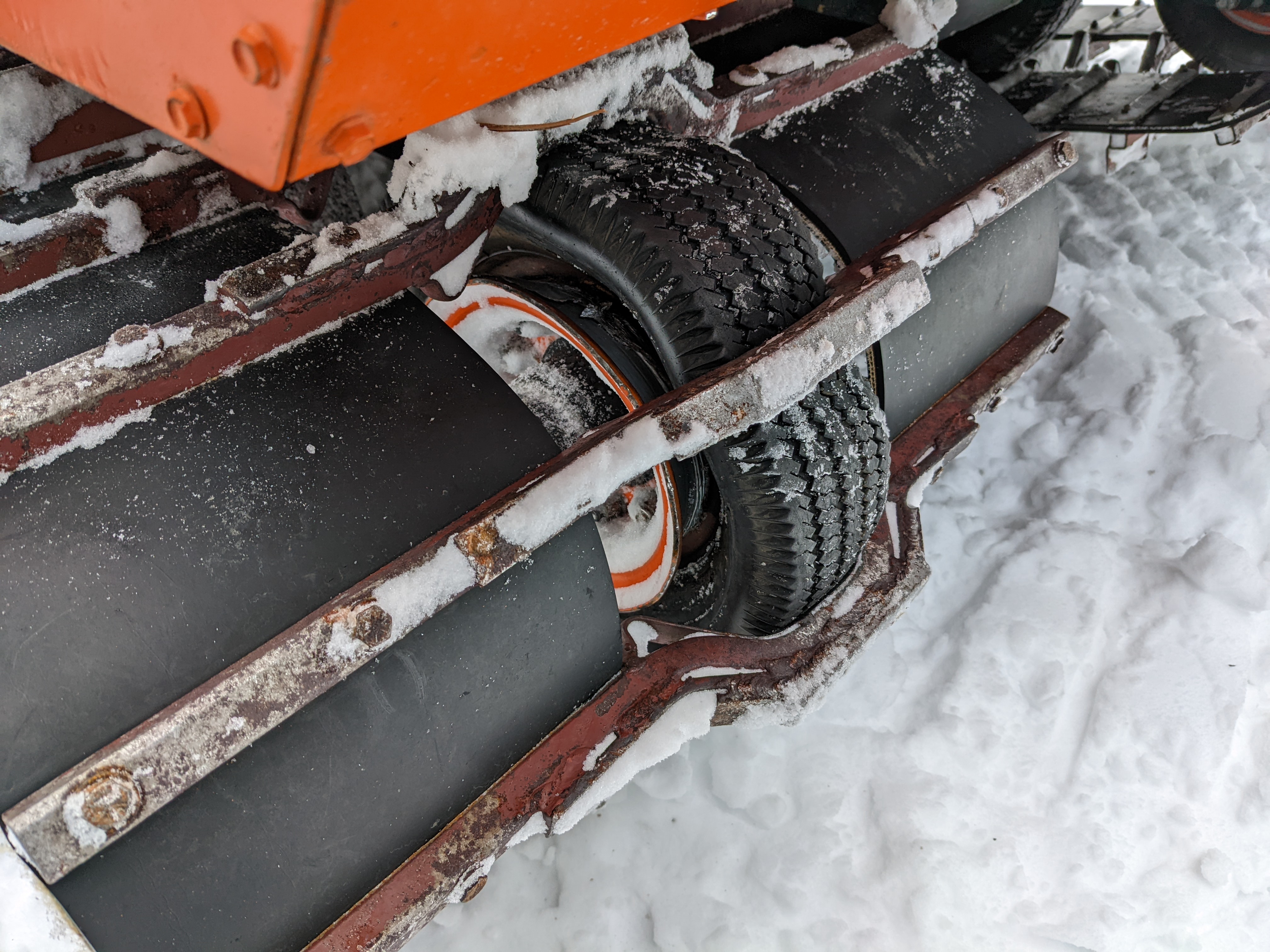

Pulled the cat out last month for summer maintenance, oil change, tire pressure check, etc. I found the right front bogie behind the idler (the idler went flat last winter) to be completely flat. In order to get the wheel off, you have to take the nuts off the 2 axle bolts on the outer spring pack and remove the U bolts that hold it to the cross member. Then you can pull off the spring pack, and after letting the air out of the idler, spread the track enough to get the wheel and tire out. The other way is to remove the track, jack it up real high, take the axle bolt out completely and drop the wheel out the bottom. I chose the first method. Since I knew I would be working alone, I needed a way to hold the inner axle bolt head while I removed the nut. (Unfortunately, I don't have Orangutan arms) With the track off, you can reach through to hold the bolt head which is how I did it on the original assembly.
Before we went over this weekend, I made a tool to hold the bolt head while I turned the nut. It is a 3/4" combination wrench with the open end part cut off, the box end straightened, and some 1/4" holes drilled in it. I made a hook bolt from a long 1/4" bolt bent in a u on the inner end to hook over the spring leaf and a knurled knob threaded to be able to tighten it. The other end has a piece of 1/4 X 3/4 flat bar with two screws that span the thickness of the spring to limit rotation. You could use this tool on the 1402, 1404 and maybe the 1450.
It beats scraping up your arms trying to reach in there from the outside.
Put in a new tube and all the tires appear to be good. I'll check it again in the fall.

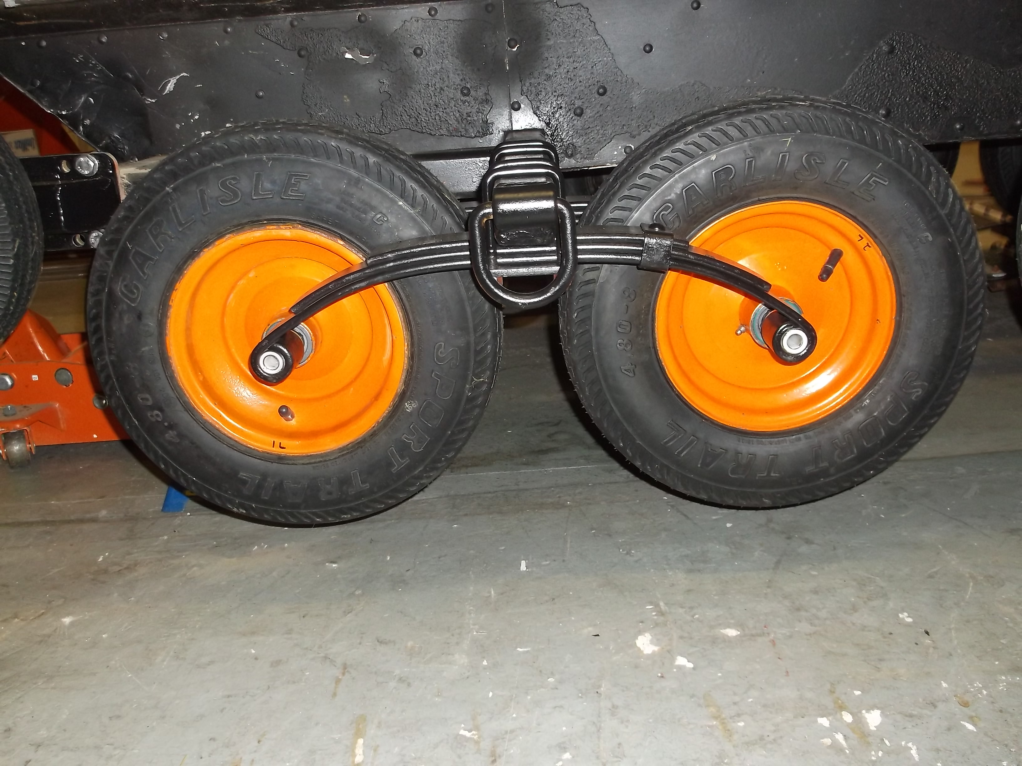

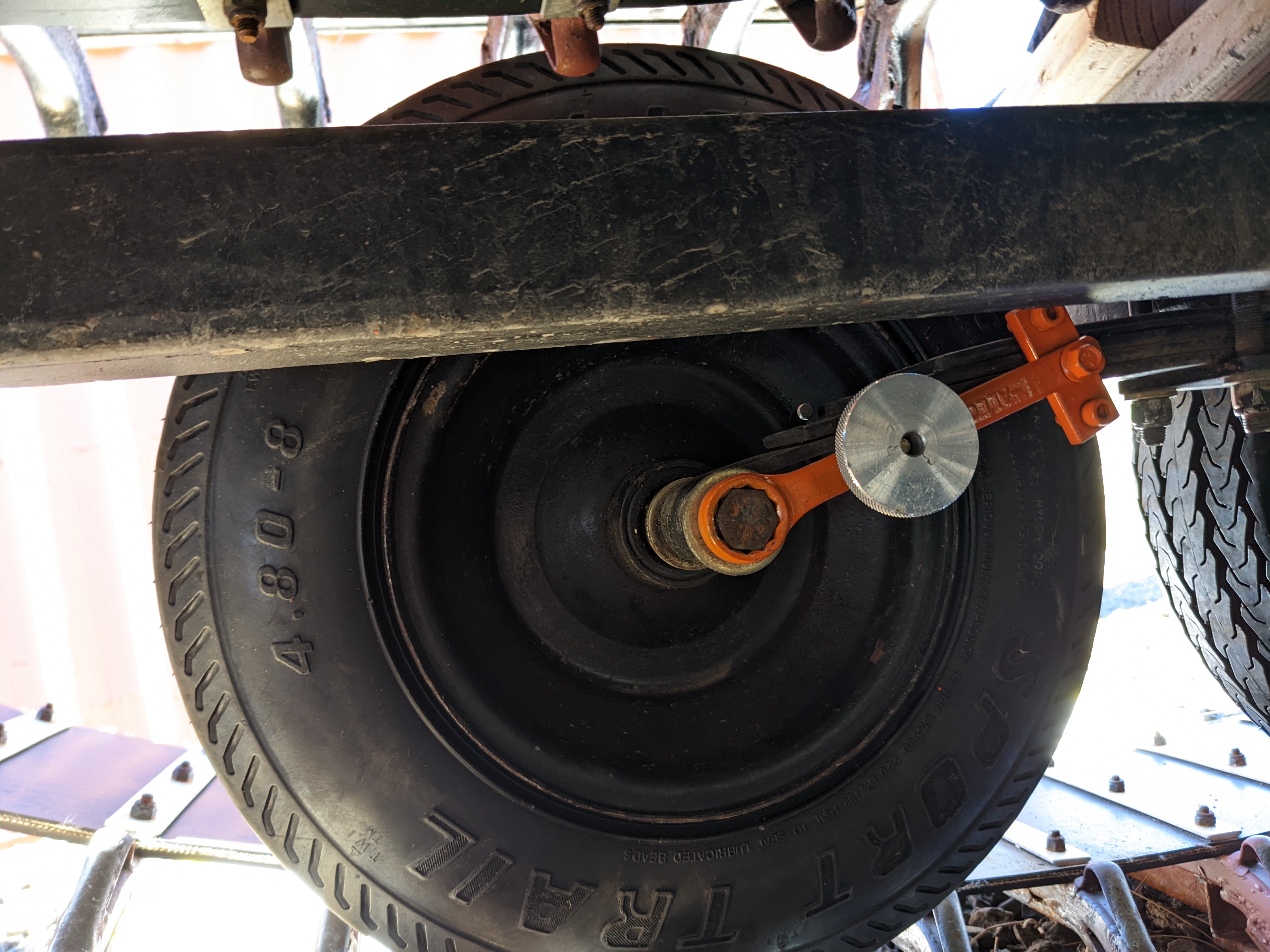

At some point in my cat's past, 2 of the bogie wheels were replaced with units that are different than the other 6. It really isn't noticeable until you try to assemble them onto the spring packs. When I had the running gear apart while redoing the springs, I found that 2 of the wheels are wider than the others. The 2 wide ones, with the tire installed, barely clears the edges of the springs, (1/16") while the other 6 are 3/4" clearance or more. The wide wheels are about 5 inches between the beads, the others are about 3 inches. The tires are the same. There was nothing I could do about it at the time, so I made it work. I was always concerned about something getting jammed between the tire sidewall and spring.
You can see the difference between the wheel on the left and the wheel on the right in the first picture. The formed stampings are different. The hub is the same. The valve stems come out at a different angle as well.

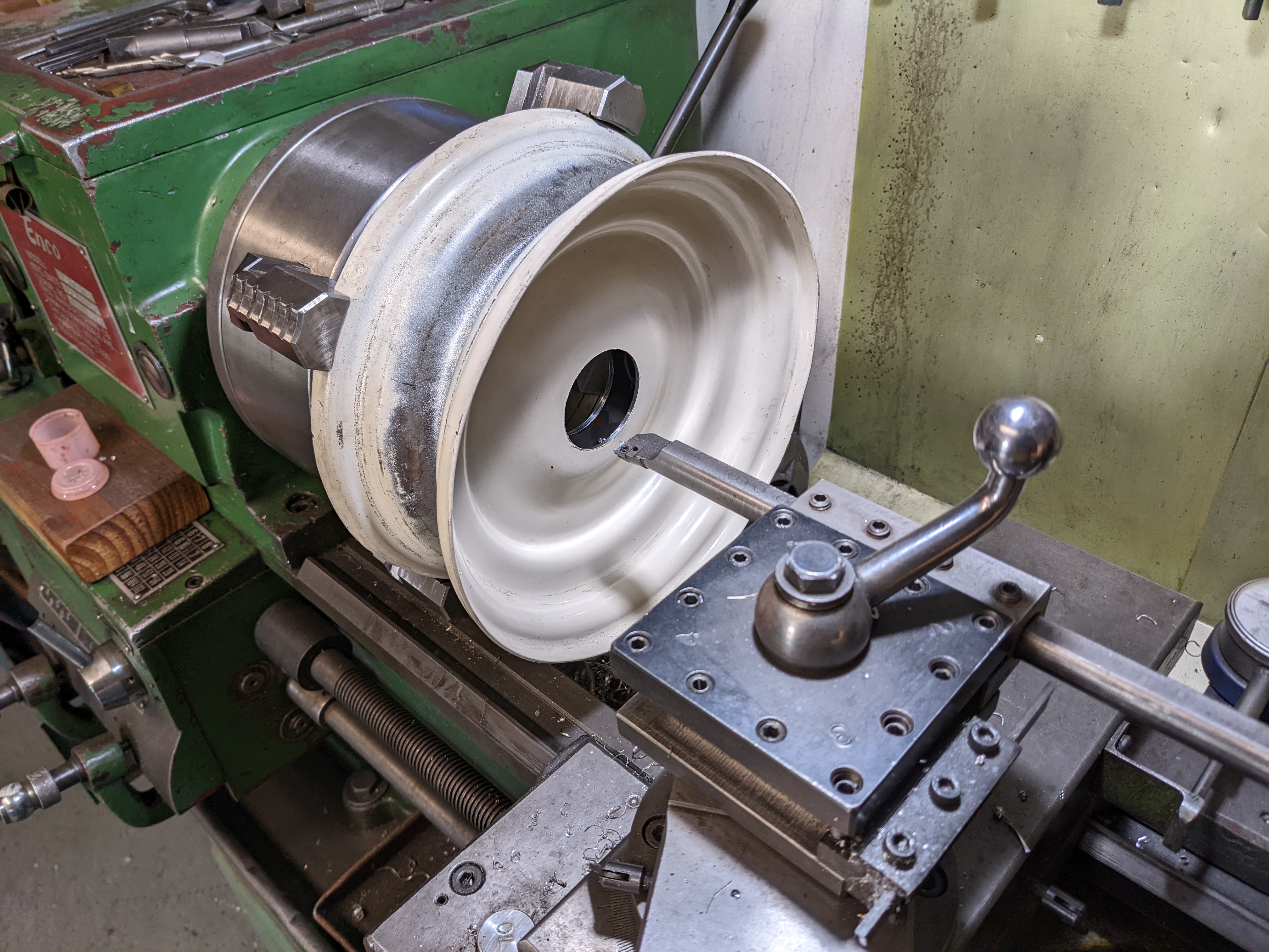

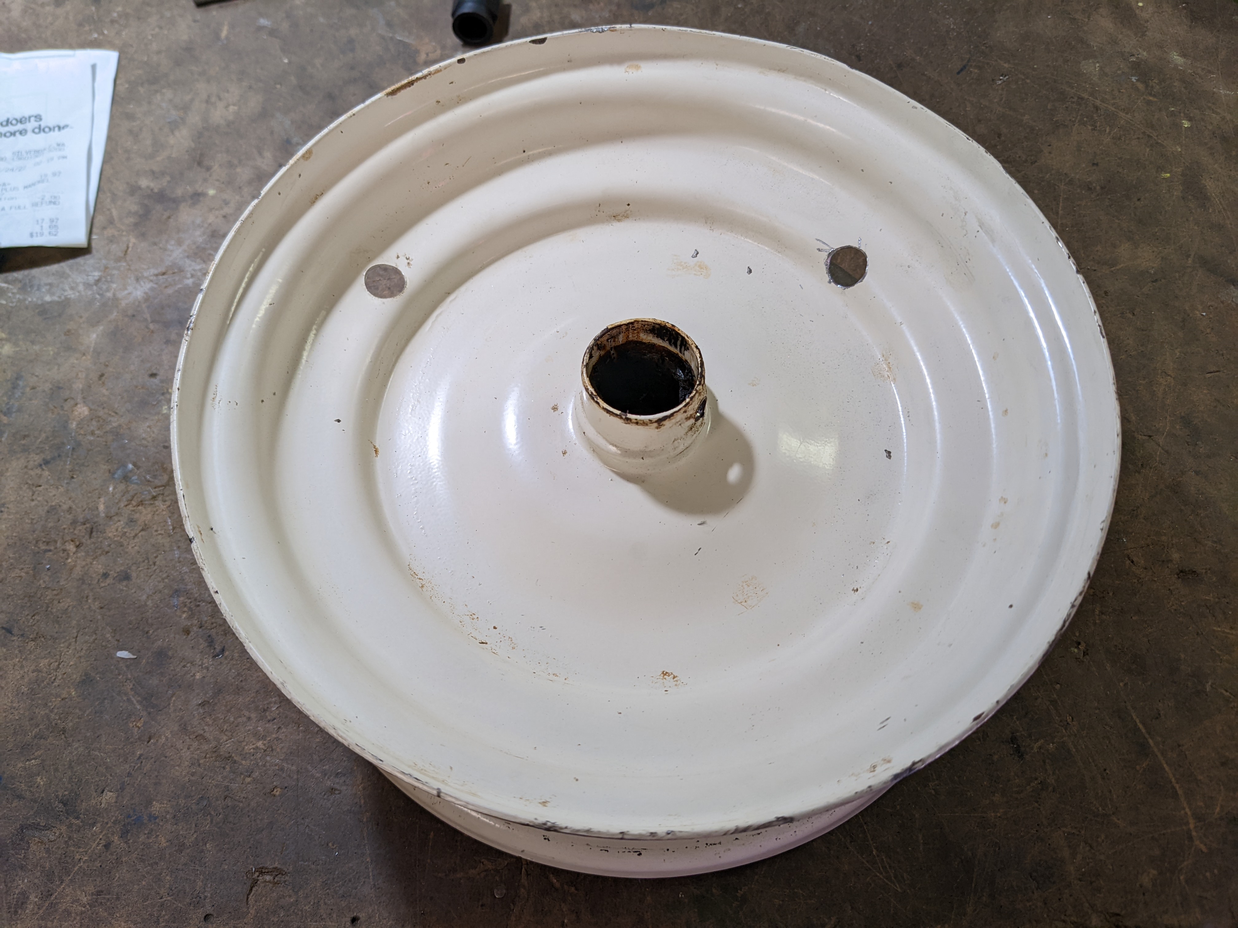

I have a garden cart that I pull behind my 4 wheeler at the cabin. After 20 years the tires (wheel barrow type) and sleeve bearings went bad, so I replaced them with wider ball bearing wheels. I got to looking at the old wheels and they appeared to be the same stamping and wall thickness as the narrow cat wheels with the exception of the hub. After some thought I decided to try to modify them.
The first step was to remove the old hub. I made an aluminum bushing to act as a pilot for a 1 3/4 hole saw and cut the hubs out, then chucked it up in an 8" 4 jaw chuck in the lathe and bored the holes to 1.875" which is the OD of the original hub. Trying to dial in a stamped steel part was time consuming. The best you can do with something like this is about .030 TIR, but that should be good enough for a slow turning wheel. The new wheels were tubeless, so I had to relocate the valve stem hole so that an inner tube can be installed. I will weld a plug in the original hole.
I have a length of 1.875 X 1/8 wall 4130 tubing for the hub. (left over from the landing gear on my plane project) We will be going to the cabin for Labor Day and I will remove the 2 wide wheels, and bring them home so I can get accurate measurements on length, bore etc. A single straight bore for a press fit of the bearing race and seal is all that's required. Then weld it in the wheel, paint it orange mount the tires and hope it works!

I got the new wheels modified for my 1402. I ended up using a 4" piece of 2" dia. 4130 tube with a .188 wall. I bored it to 1.781 X .940 deep for a press fit of the wheel bearing race and seal. I centered it up in the bored hole in the wheel and tig welded it in. They rotate within about .030 runout which is pretty good for a stamped steel rim.
You can see the difference in width between the 4" and 3". I know these were used on small boat trailers from the 60's but I'm wondering if maybe they fit a 1450 since they are a heavier rim. The 4" was made to use a tubeless valve stem.
Hope to get them installed this next weekend when we go back to the cabin.

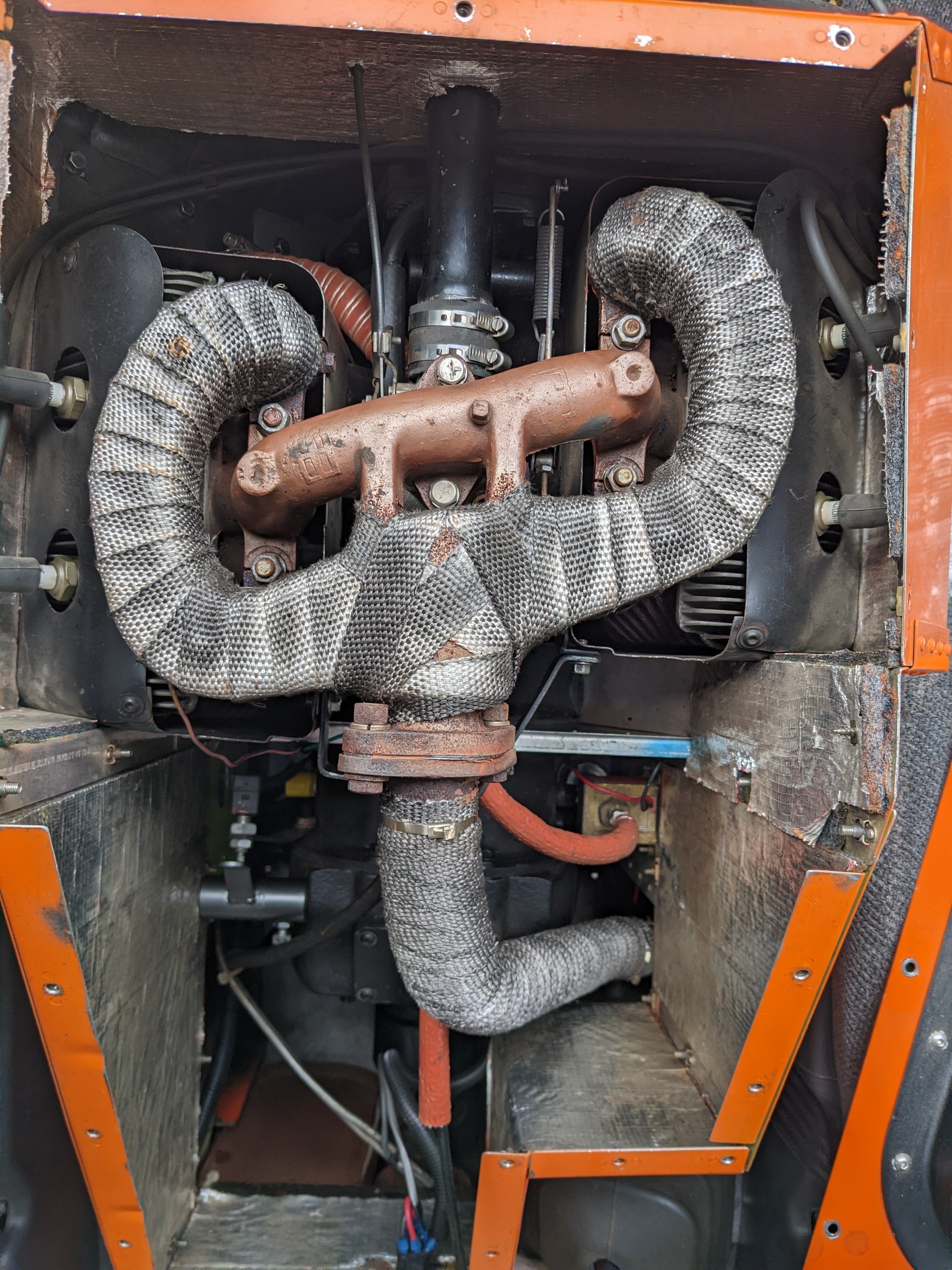

Just finished inspecting the engine on the cat. I had planned on doing it last month but didn't get over here due to covid. So I got to do it in the snow.
Every thing was clean with no oil or exhaust leaks. My CO detector keeps chirping though, even with new batteries. Do they have a limited life? Mine is 10 years old already. (Time flies). Last picture is this morning's sunrise.
