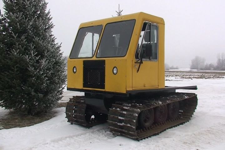

Sure, now that I've got a chance to test-drive the SV200, we've had a bunch of melting. The pictures I'm attaching were "staged" on the north side of a line of evergreens. Lots of dirt and grass showing through in most places. I don't know if I dare wish for the amounts of snow parts of the nation are getting.
1. The first picture shows the nearly-completed project. I might want to put some Bombardier decals and striping on (if they're not too expensive) and I'm still trying to figure out the windshield wipers. I might need to consider adjustable lights facing forward if my recessed lights don't point the correct direction at night (not had an opportunity to drive it at night yet).

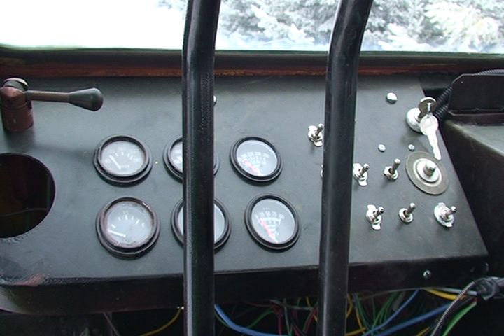

6. I'm too cheap to try to replace all the original guages. I think I got the major ones: water temp, ammeter, and oil pressure.

Really nice looking job you did there. I was suprised how big of an engine that had for the size... My Imp has the V-4 Ford and it gets along pretty well and pulls a good load. With that, you should be able to drag houses around....:thumb:

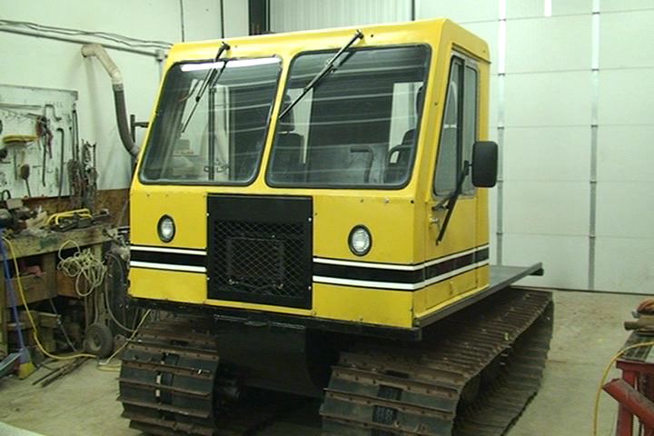

I got a little fancy and put some stripes on the SV200 (tried to copy the zerox copy of the manual). Now I suppose I'll be hunting for logos and the other graphics. We got about 5 inches of snow Monday so I can maybe take it out for a spin later today.
