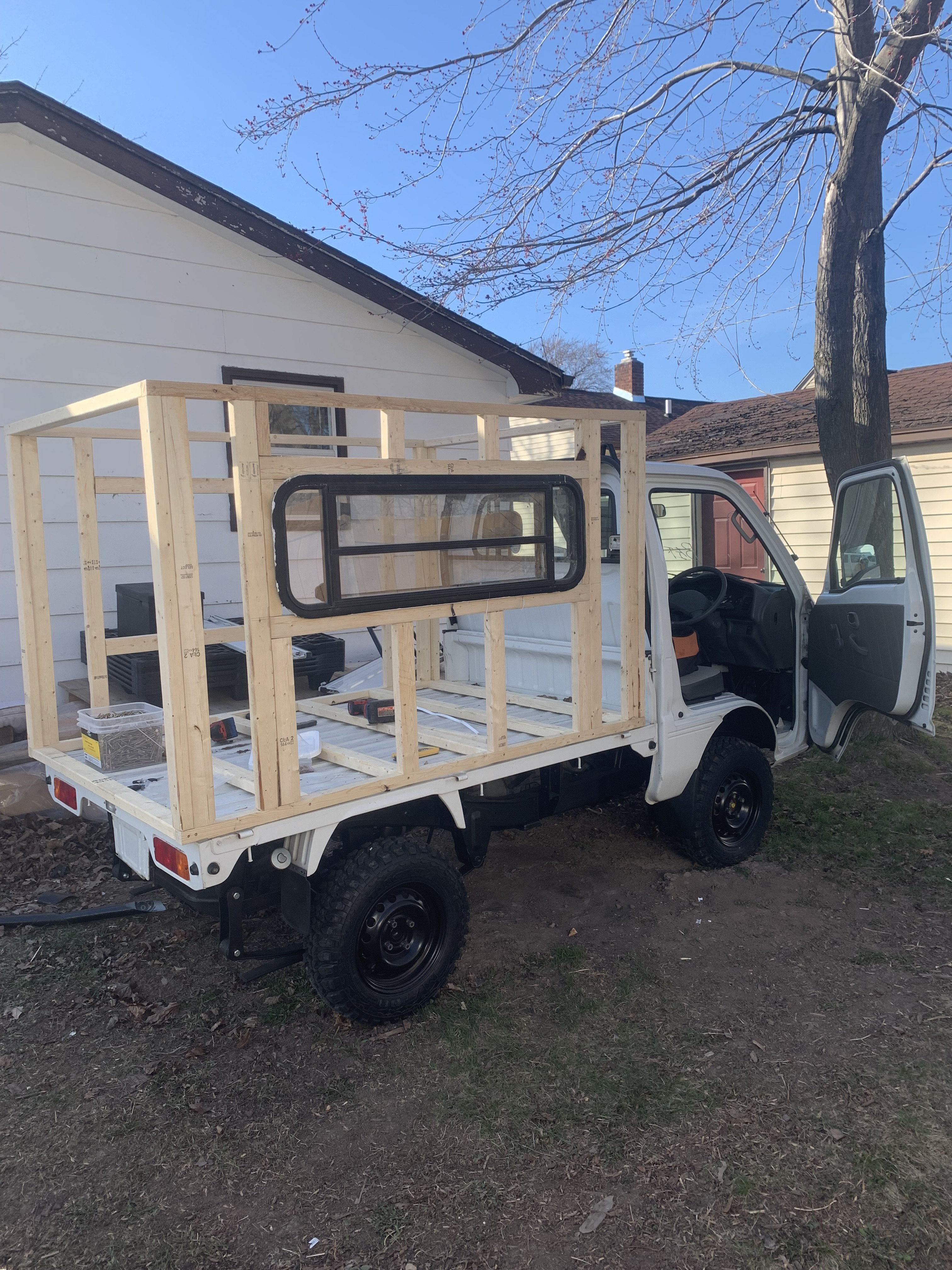

It’s not terrible. I have both pushed all the way in. We I remade the lift, I made those slots longer. I bored out 2 inner holes and put machine screws in, so I could slide it all the way in. Also added washers to try to help but didnt do much. I almost feel like the lower control arms are holding in place.
Has the clunking noise in the axels gone away?
I think I’m going with monroe 31000s. From my research online this should do the trick. I dont know what I’m doing when looking for the air shocks.
Just pick an air shock that is close to the factory shock or a touch longer. Don’t worry about the attachment stud being smaller than the bushing in the mounting eye on the shock, you can make a secondary bushing from poly tubing or rubber hose to take up the slop.
work in progress
