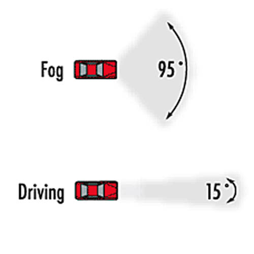

  2. For rear facing lights, my thought is to illuminate the widest area possible behind Snow Trac, so does it make sense to use "fog lamps" instead of driving lights. . . or is it smarter to illuminate a long distance behind the Snow Trac and why? See the second photo showing the light patterns.

#2) The lighting on Lyndons roof is what I believe for just lighting up the general area around the Track Master. These lights need not be top dollar since the beam and pattern is just for a relativley small work area. You can get Hellas I believe for about $40 bucks a set. Maybe more for a harness. I have several of these that came with no harness and were freebees from my brother. We used these to place on or 4x4s for working on them or help getting them or someone else unstuck. I use to have a set under my jeep to help spotters at night to help in seeing objects under the rig. They work great and those are cheap by design anyway. Lyndon really needs to state what he used them for though.
AND YES you want a wide diffused beam for the rear.

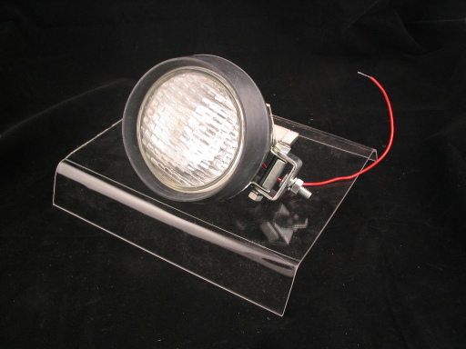

Lyndon, I went to Ebay and punched in a search for "cheap-ass rubber fog lights" :whistle: and came up with this auction. I think they look like the same ones you use. Can you tell me if you just set the screw into one of the roof gutter bolt holes? I'm presuming the base acts as a ground?
Here is a link to the ebay auction.
Bob,
I'm using those on my RTV for the rear and side lights. They work well.
BTW - With shipping, that one on e-bay is more expenseive then getting at a local auto parts store. A tractor dealer should have them also.
Brian
PS, if you don't torque them down super tight, you can set them up to swivel, which is what I do. I then twist them into the "stow" position when I don't need them.
Bob: that's them. On the front I enlarge one of the exsisting holes, same on the sides, in the rear I center them up and they get their own hole. It's a area that can use strengthening up anyway. the guy ahead of me is right, cheaper at the auto parts store. Unless the E bay seller gets less than 10$ including shipping. anyway you can't go wrong with them. And yes they ground thru the mounting bolt. The writer above also has the right idea about leaving them so you can adjust them in the field.

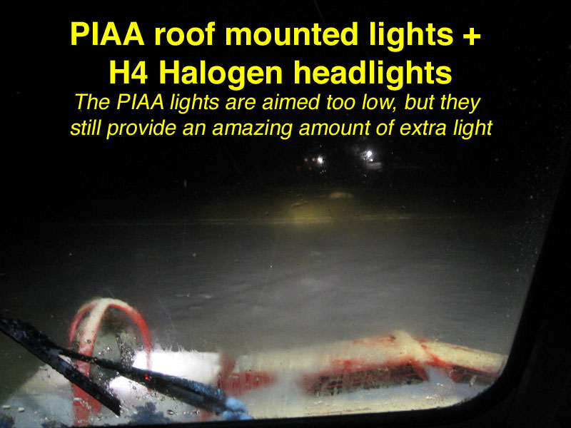

I installed a set of 525 series PIAA hi/low bean headlamps on the roofline for forward facing lighting. They are high quality automotive lamps suitable for on/off road use. http://www.piaa.com/Lamps/Lamp-pages/525.html

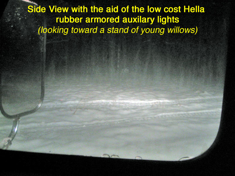

I also have one rubber armored Hella light on each side for some added side visibility at night. Facing the rear are 2 more rubber armored Hella lights. The PIAA lights were expensive, their light output is impressive and while I still need to adjust them a bit, they easily double the forward visibility distance, but I believe they will actually triple the visible range when set to the proper elevation. They also have a nice wide beam so they increase the field of view in addition to increasing the range.
The Hella lights cost under $10 each and provide some general lighting. They are not well focused, but really do not need to be for their intended use.
-- these photos were also posted in my Snow Trac restoration thread, but figured they also made a good follow up to this discussion.
