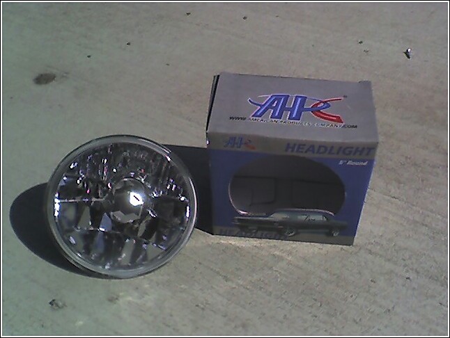

I finally got around to downloading the images from my cameraphone of the headlamp upgrade.
This was a very simple project. Pretty much just plug & play.
Photo #1 shows the new reflector assembly. It is sold without a bulb. A standard automotive H4 Halogen locks in place of the reflector assembly from the rear.

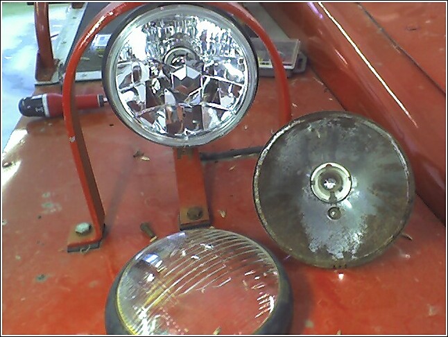

Photo #2 shows the orignal light assembly and the reflectors from both of the headlamps. You can see how badly these are corroded. The headlamp assemblies will both be completely restored this summer, but really all they need is a little surface clean up and some fresh paint.

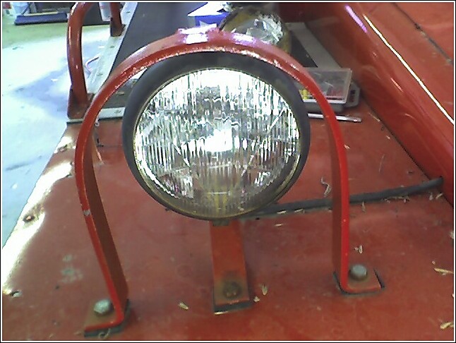

In the next two photos you can see the installation of the new assembly.
The new reflector sits perfectly inside the original housing. :thumb: It was nothing more than an amazing stroke of luck that it fit so well.
In the final photo you can see the headlamp reassembled with the orignal lens in place. It is impossible to tell the difference between the orignal components and the new upgrade by looking at the headlamp. UNTIL YOU TURN THE LIGHTS ON. :D Trying to see ahead of the Snow Trac with the orignal bulbs/corroded refelctors was about as easy as holding a candle up in front of you while driving a car. The new bulbs/assemblies are as bright as any modern car's headlamps. A phenominal improvement.
