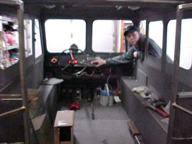

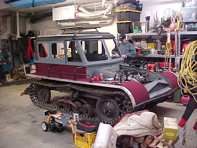

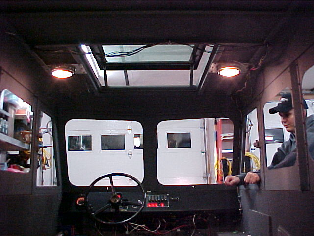

Finally, some new pictures of Dave and Chris Lace's SNow Trac undergoing restoration after spending a couple months on the bottom of the Tanana River. It has a rebuilt VW 1600 CC engine now. Dave has covered the interior with that interlocking puzzle piece rubber matting stuff. It now has digital gauges, a new aluminum gas tank, and a reinforced rear door and fender support area. Have a look! THe red head guy in the pictures is Todd Evans, the other guy is Joe Brown, they are both aircraft mechanics who work on DC-6 and C-46 birds for Everts Air.

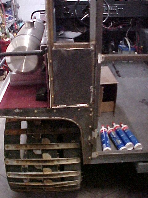

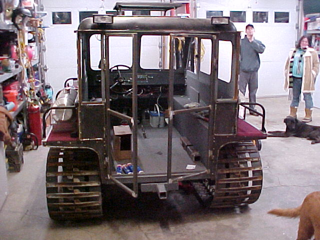

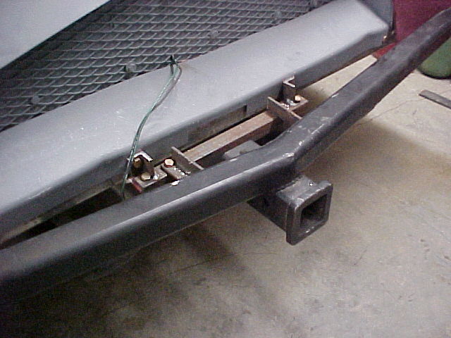

Here is a look at Todd's mods to the rear. Check out the steel reinforced corners, and fender. There are also bumpers front and rear, if you can see the rear receiver, that is what supported the rig during recovery.

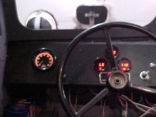

here is a look at the rear lighting, and new digital dashboard. All wiring has been replaced.

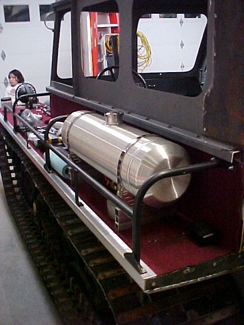

Here are some pictures of the new tank on the left side, and inside shots.

Interesting modifications/improvements during the rebuild. I really like the double rear doors to open up the entire back end of the Snow Trac. When the seats go in will they be fold up seats to allow for more cargo storage?
Is that carpet on the fenders? If so, why? :confused2:
The marine grade switch panel on the dash looks like a nice upgade too. :cool2:

Just saw a couple of other comments. We used outdoor carpeting on the fenders to help with rattling. Ditto for the inside. We used interlocking foam squares on the floor and walls to keep the noise down. Our neighbor Dale said that it would help it float too :yum: kidding. (This is Dale, Arcticracer. I just noticed on the instrument panel that Dave installed, as a marine panel, is labeled with the various devices one would find in a boat. I told Dave I hoped he would not be needing the BILGE PUMP OR ANCHOR LIGHT!!!!)
