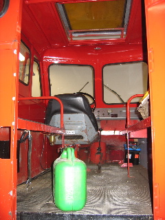

In your original post you also mentioned that the Snow Trac you looked at on Ebay had a marine tank mounted outside the cabin.
When I got mine, it didn't have any fuel tank installed at all. For initial testing and playing, and just to run the engine every once in a while I used a plastic marine tank that I bungied into place with the rubber fuel line just dropped into the open container. Not safe, I know. But it was suitable for my short term needs.
I've seen several photos of folks who removed their fuel tanks and mounted them outside on the left side of the cabin over the tracks. If you follow the link and look at the thread that shows the Mountain Home Resort's Snow Trac, you can see he moved the tank outside the cabin. He also made another common modification in that he ran the exhaust under the Snow Trac to the rear of the machine.
