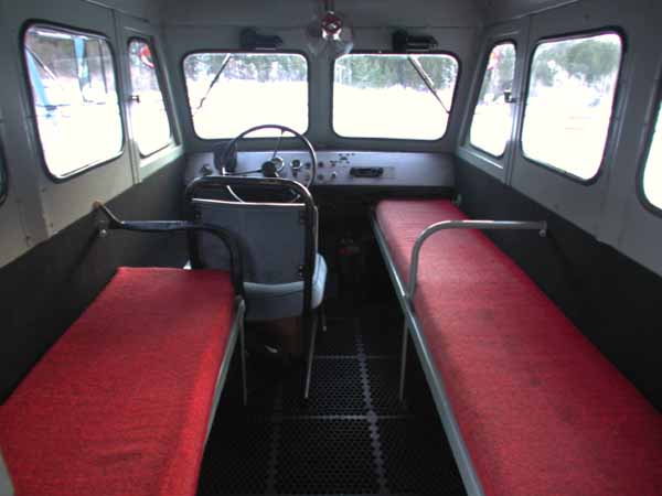

You will notice a couple things different about this Snow Trac. On the inside his driver's seat is differnet than mine. And he actually has his passenger seats padded!

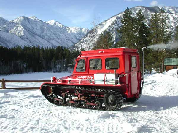

Take a look at the tracks. These tracks have one large rubber tire at the rear, the other style has 2 large rubber tires, one at the rear and one near the front, behind the drive sprocket.

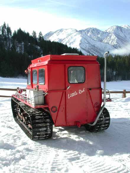

The fuel tank was removed from the inside of the Snow Trac (normally it would be directly behind the driver's seat, under the passenger's seat. He relocated his fuel tank to the outside and it now sits over the left track at the rear of the Snow Trac.
The exhaust, as it come from the factory, is front facing and you drive into the exhaust fumes. He ran his exhaust system under the Snow Trac, and to the rear of the machine. Also on the rear of his unit there is no rear bumper, I've seen them both with and without so I don't know what is historically correct.

schmidt, I've noticed a couple other things and wonder if you can enlighten me about them.
The roof of your unit looks to have either a box on top or perhaps it was raised a few inches? What is the handle for that is located on the drivers side in the center of the side of the raised area?
I noticed your windshield wipers are at the top of your windows, mine are on the bottom and basically worthless. I also noticed the fan you have pointed at the windshield, does that help with fogging?

Looks to me like someone added a pop-up roof.
Re: schmidt's Snow Trac at Mountain Home Lodge
Sorry for the slow response. The original top was canvas and was basically trashed by the time I saw it. We made a wood top that can be removed on nice days. I also placed one of those flip up ceiling vents like you see on RV's to help move more air. The windshield wipers have always been on top and do work. The fan does help, but the fan itself is kind of cheep. Its the second one I have gone through from NAPA. I believe this SnowTrac is about a 1965 or 66. Apparently they went to the larger wheel in the front in the early 70's.

What do you actually use your Snow-Trac for? Is it for giving tours to your guests or to get the guests up to the lodge? I noticed you don't have any ski carrier or anything like that on the rear so I'm guessing that you don't use it for snow cat ski adventures or similar things.
Also, with the exhaust pipe routed under the Snow-Trac all the way from the front have you had any problems with it getting dented on rocks or uneven ground? Is it stainless steel because I don't even see a hint of rust on the exhaust?
Also, I noticed that your side cargo rails and your headlight brackets/protectors are all silver colored metal. Are those painted silver? Or is that bare metal, and if so, how do you keep it from rusting?
Was it easier to move the fuel tank outside rather than to repair the original tank so it didn't put gas fumes into the cabin? I noticed on all the military Snow Tracs that the fuel tank is mounted in the same place as yours is mounted. I don't know if they ADDED a second tank, or if they MOVED it outboard so they could stow more gear.
