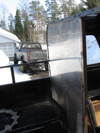

This wall you see behind driverseat is not original, just a bit of plexiglas some previous owner has mounted, to keep some of the heat in the cabin.
We need more photos!!!
If that wall is not original, then other parts of the cabin may not be original either. If that is the case, then you may have a military version. You do not have the military front hitch, and I don't see the helicopter lift points on your Snow Trac either, those were on SOME of the military Snow Tracs. I still suspect yours in not military, but perhaps if you could post many more photos then we could figure it out.
