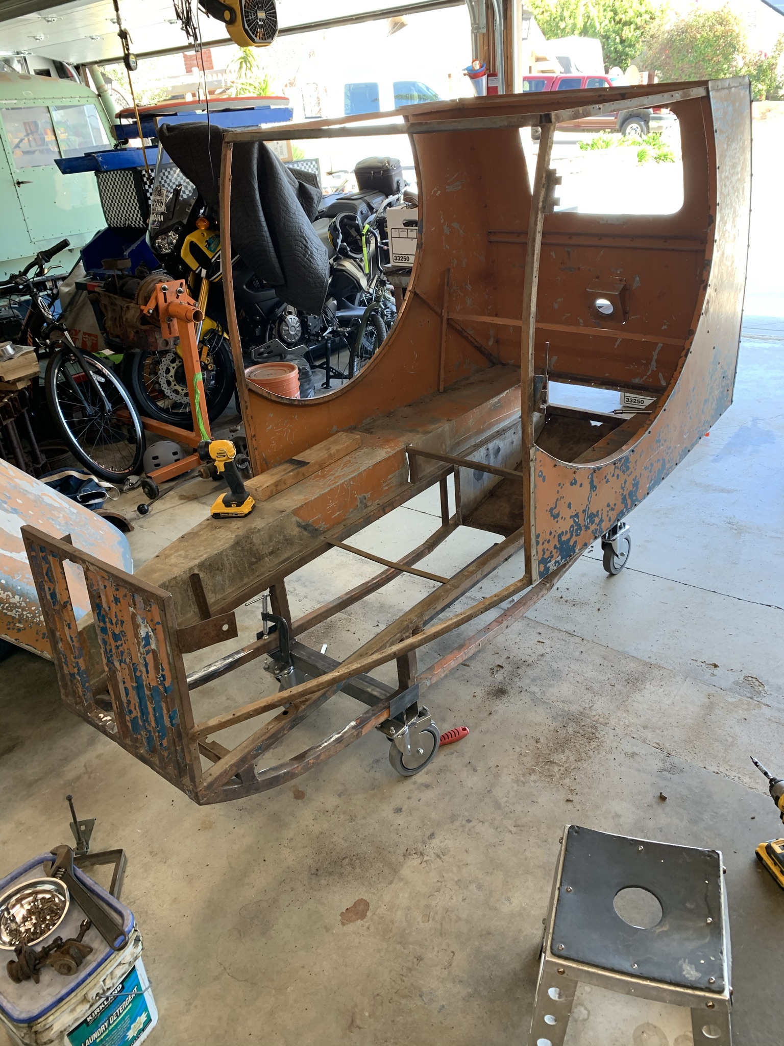

Got the hack job skid plate cut off the kitten finally.

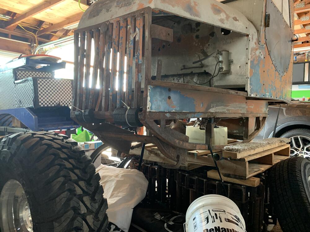

Changed the name of this thread since it’s already kinda following this restoration. This isn’t gonna be a quick turn around - Im gonna work on this project when I can. That being said, I’ve been cranking on it this week.
The grill was really messed up. Bent in every direction. I’ve got it pretty close now. I’ll weld the new bars in when I finalize the frame.

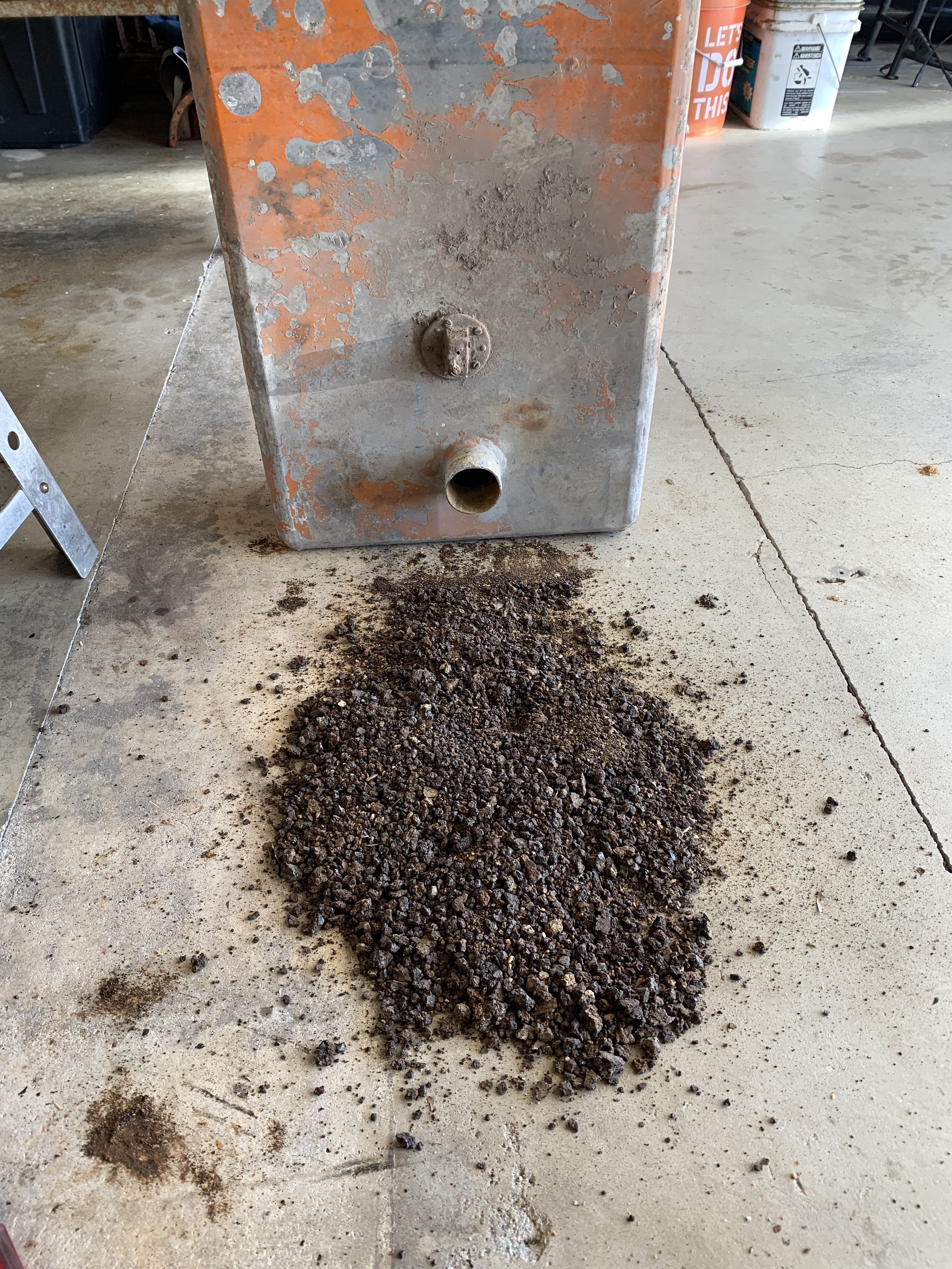

Pulled the fuel tank out and It was obvious there was a ton of stuff in it so I did my best to dump it out. it was shocking what came out. I did find the fuel float in there. Anyone know what they used for the fuel level sending unit in these? I’m gonna have to cut the tank open to clean it out enough to reuse it.

I’m taking the body off the frame. Gonna get the frame sand blasted then have the body soda blasted. It was only a couple extra hours of work to take it this much further apart. I think it will pay off in the end
