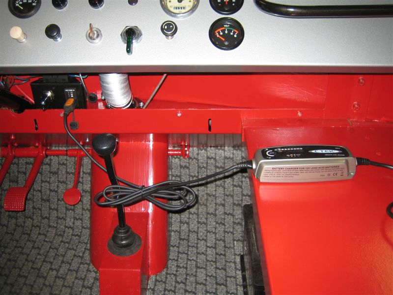

1. Dashboard back in place. Added a few extra buttons and gauges as well.
2. Easy to charge the battery.

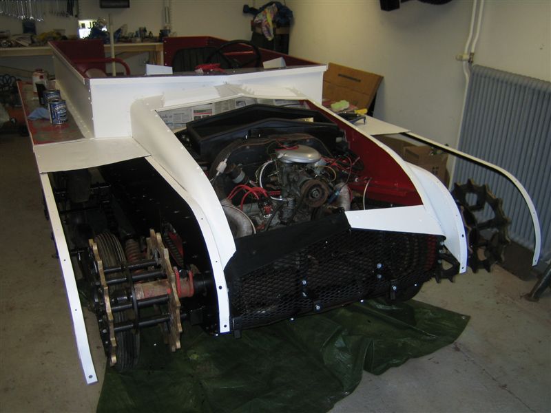

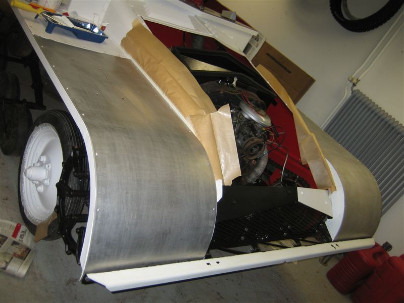

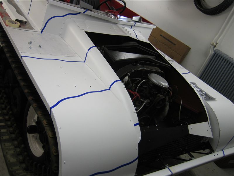

1. Engine, front end and the first black and white part mounted. It looks a little silly but then I had no time to paint the rusty parts on the engine.

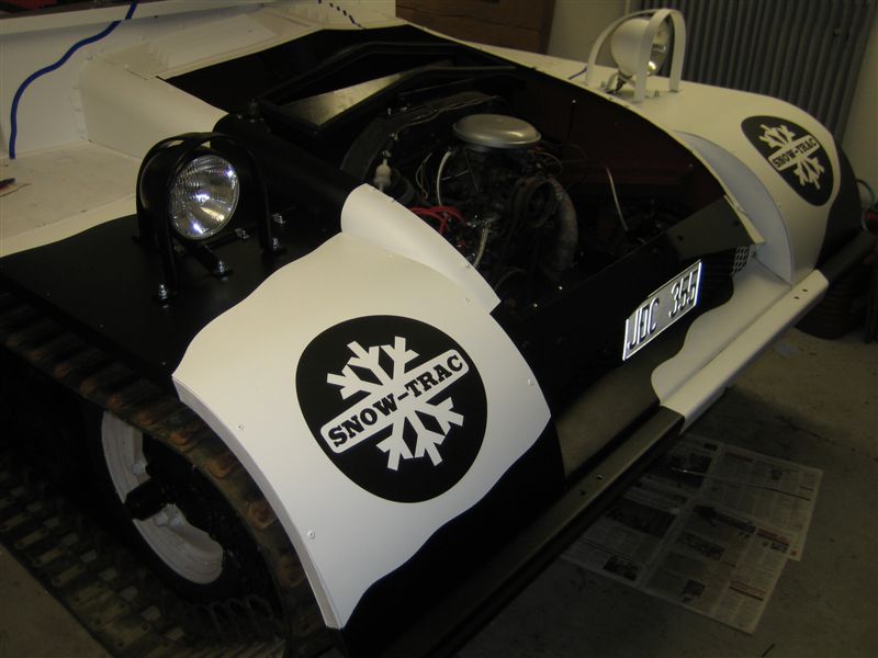

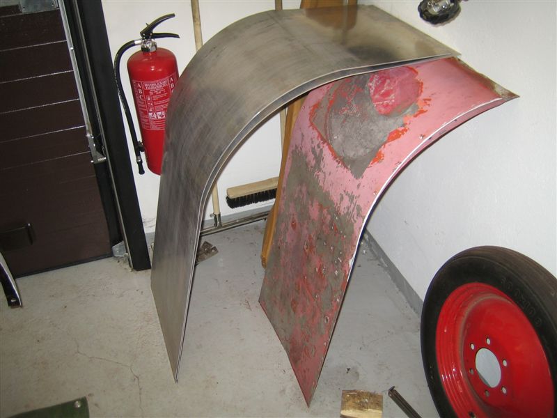

2. Front fenders were full of dents so the easiest way to fix it was to replace them.
3. New and old front fenders.

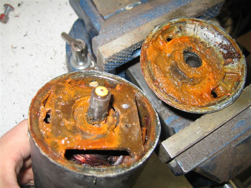

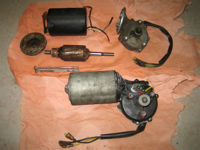

I discovered that the windshield wiper motor not working. The fault was localized to the wiper motor and after taking it apart the fault could easily be established, it was full of rust.
This Bosch motor sat on the BMW 2000 C / CS 1965-1969, which is very unusual. Finding that spare part was almost impossible at reasonable prices but I got hold of a nearly identical motor from a BMW 2000, which is very common.
Now I could build up a functioning wiper motor from these two.
1. Rust
2. Rust
3. Old gear and new motor.
4. Almost the same.
5. A little soldering required.
6. It fitted, and it worked.

3. New front bumper and fenders mounted.

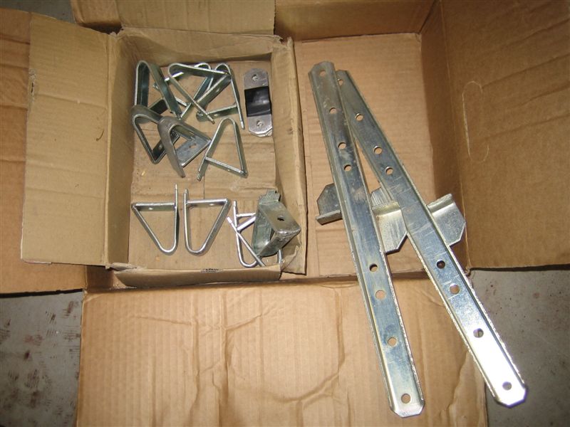

1. A box with track parts from Christer Morlind.
2-3. Easy to mount tracks with homemade track jack.

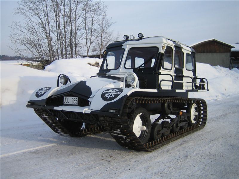

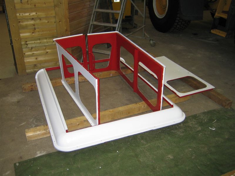

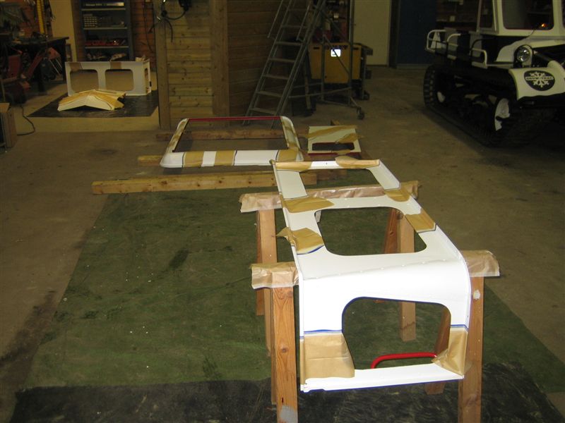

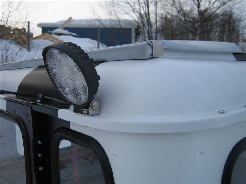

1. Masking for painting.
2. Black and white painted, headlights and decals fitted. Thanks teledawg for the graphics templates.
3. Taillight and LED strobe light.

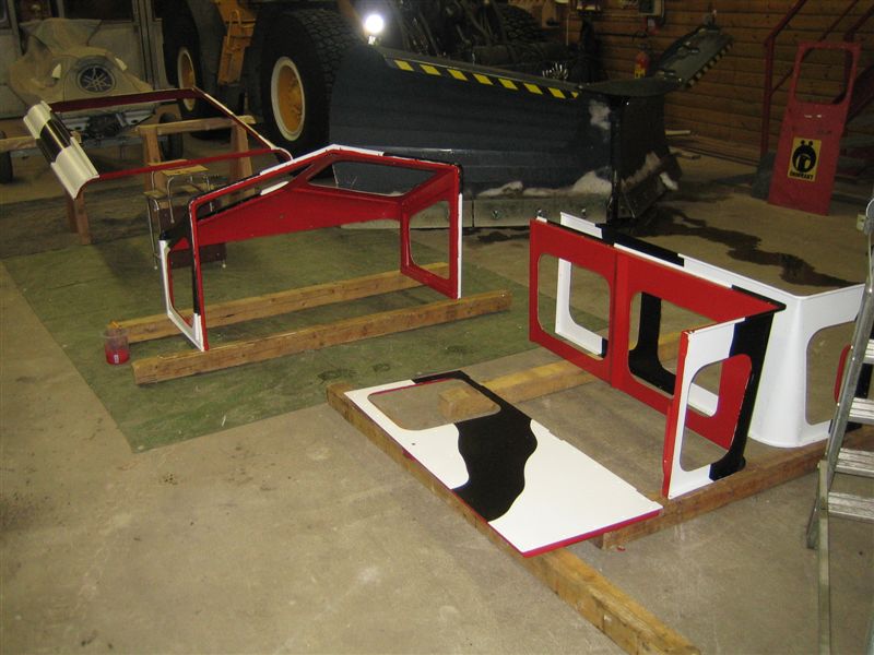

1. White ...
2. ... and ...
3. ... black.
4. Something is missing.
5. Almost finished.

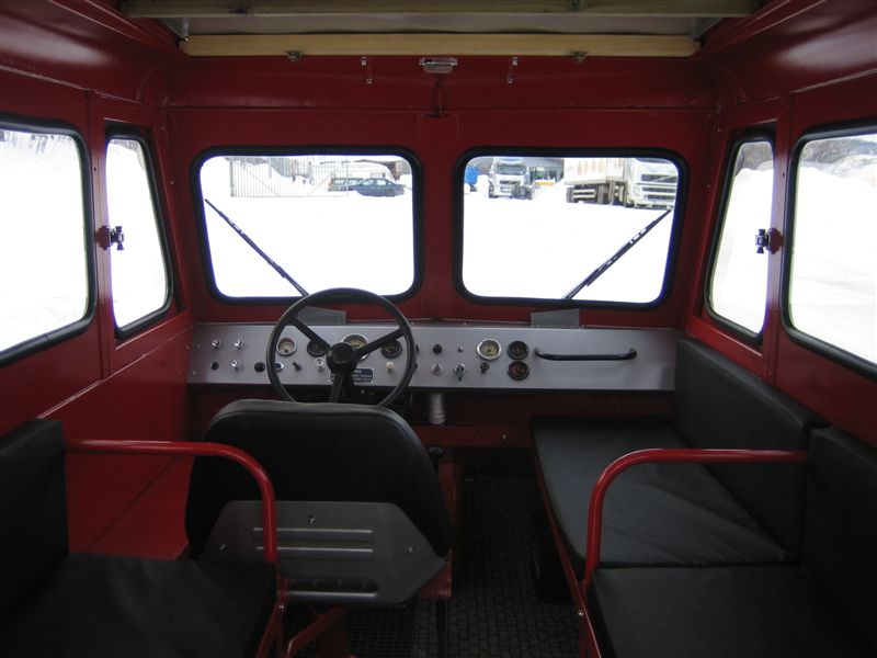

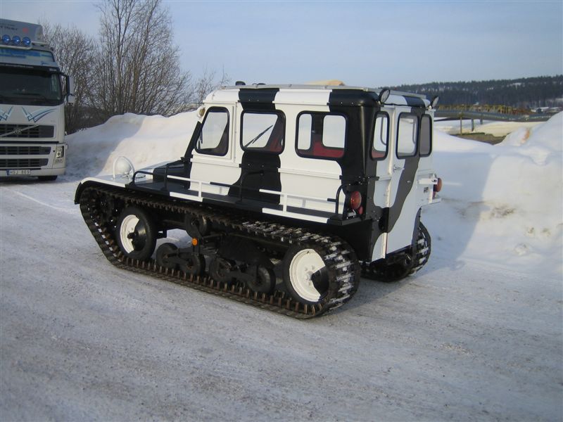

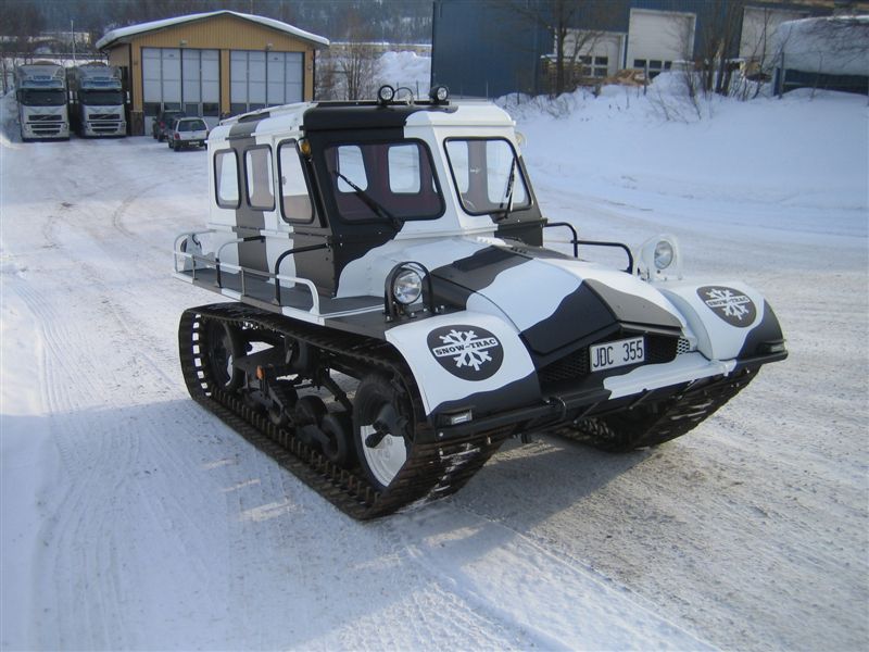

February 26, 2011, just over four months since the restoration began, it was finally time to drive out of the garage.

Inside.
