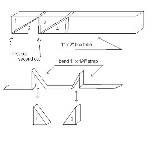

2" X 1" box tube.
Lay it down flat, make first cut at angle, your first triangle falls off, next cut straight, second triangle falls off. next cut at and angle third piece falls off, so on and so on.
If you need I can try to get pictures, but it won't be until Mon or Tues.
My drawing abilities are pretty poor, but I hope it get the idea across.

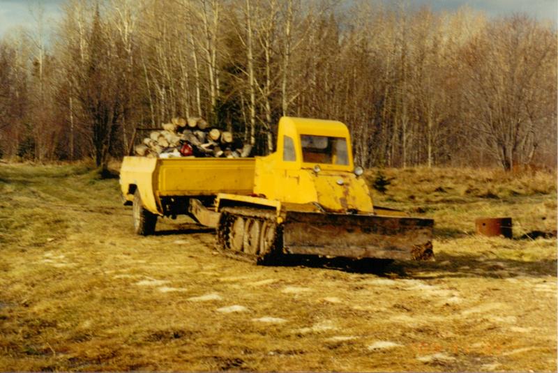

Don wanted a picture so finally here is my SW 48. It has widened tracks and we use it to pull a groomer for our dog sled trail. The track was widened it looks like by extending angle iron off the grousers and adding 1 foot of track each side. I think that this really helps us, though it can bog down off the trail base when I am pulling the drag so I know we are still heavy. This former sidewalk plow can push a #4%& load of snow but with the small blade it doesn't get called upon for that task very often as we use a Toolcat for driveway snowplowing.
Heater runs great and cold start with a prime (minus 30 celsius). I need to do the right window that is clouded plexiglass (single piece). Had 3 new solid wheels put on and one sprocket this year and new starter and solenoid. Carb has to run with some choke all the time - mechanic says that it needs full rebuild or replacement as the jets are worn.
Have had it for a couple of years now and learning how to best drive and groom for best trail. I do have to keep at the grooming to ensure that the base is always there. If there is too much fresh snow I have to go out without the groomer to pack down. The trail sets up super after grooming with the drag for our sprint racing dogs. We are in northern Saskatchewan and so not alot of hills but steady amounts of snow arrive and cold temps. The blades on the groomer help cut icy trails and I often 'pull' new snow from the side of the trail to cover any problem spots.
The single seat is a down side as my young son would like to come for the ride - maybe converting to a wider seat (relocate hydraulic plow levers and add perhaps a CJ rear seat) Yes my wife approves and no she has never got to drive it...I tell her its loud, smelly and noisy.:brows:
Electric lifts on the groomer wired to switch on the steering. Its a mogul master groomer copy I was told.
Bought via post ebay auction from the US. Was easily shipped and I met at the border. Wish I was more handy and had a super shop like some of you guys. The project restorations make me drool with eny!! I have learned alot from this forum and now that I can do pictures I will try to get some more posted of my unit. Ask if there is anything you want me to take a picture of to post.

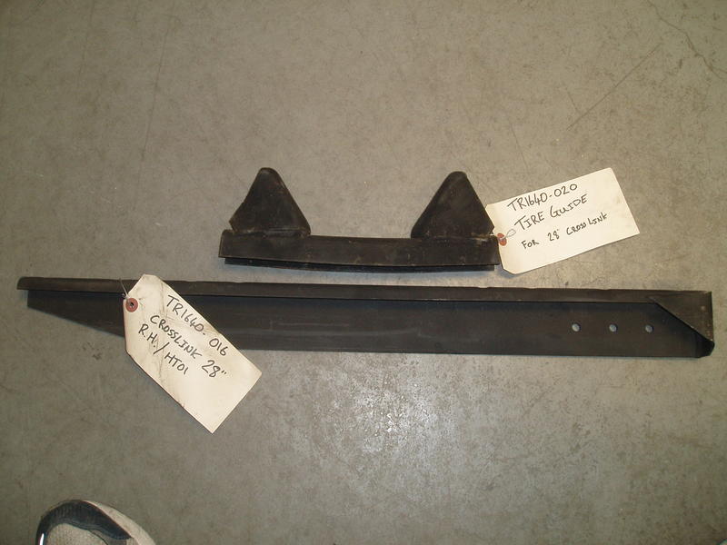

I took one of the grouser bars off the kitty today and here is what I've got. Overall lenght @ 25". Seems like some 1" square tube and some 1/4" x 1" flat bar stock would keep me busy in the shop awhile.....wonder how to replace the triangle posts on the wheel guides?.
Not sure if these would work for you but if its just for the snow.
The crosslink is 28" long 1" wide comes in a left and right. They use two 8" belts.
