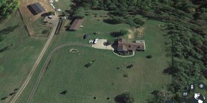

We have a 30 x 70 pole barn for family boats and my tractor and implements. Still some things have to sit outside because I do not have enough room in the barn. So I'm hoping to add another pole barn.

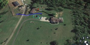

I have to decide on location and cost will play a big part of the decision. Pics below show aerial view of our house and pole barn. I have sloppily added potential sites A and B and things that need to be considered if I use those sites.
I was going to go with B. It's semi level. Nothing buried below to worry about when doing site prep, so I could concrete the floor of the pole barn. But I do not care for how I think it would look on the property. It would be long ways like the house with one side of the roof facing the road. Garage doors on each end ...knowing I still could not pull my boat straight through because there is not enough room on the house of of the site for truck with the boat hooked on due to shape of driveway.
Site A would have to be very close to the existing pole barn and is fairly level but slopes some towards the back of the property. Slope gets worse the further back we go. Gas line is buried underground also.
Power for either location would come from the 200 amp service I have in the 30 x 70 pole barn.
Site A would not be concrete floor. it would be gravel / dirt like my current pole barn. If I went this route I would then plan to concrete the current 30 x 70 pole barn floor once the 2nd pole barn was up. I could xfer the 'stuff' from the current barn to the new pole barn while the concrete work was being done. I really want at least one of the pole barns to be a concrete floor...if I can afford it.

Doc, I cant see a difference in the two locations as far as cost goes, personally i would do site A with a decent space between buildings. I think this would be more pleasing to look at. And gives you the access to back boat in as pulling through does not appear to work with A or B sites. I have two 40x60 metal frame shops set up like plan A, one with concrete slab the other with 3/4 screened rock for floor. Both work great. Sorry for not having any great advice. Good luck!

The spot for A also slopes to the right so that to build a 30 x 50 or 30 x 60 itwould have to be as close as possible to the existing pole barn. I considered combining the two with a lean to type of structure but to have the height I want (12 ft) ...same as existing pole barn I could not get enough slope.

A little more detail on the gas line. It was laid on top of the ground for 2500ft from the well to close to the house. Represented by the blueish line.
The yellow portion of the line shows where it was buried. The pole barn was built after the line was put in so the line simply goes under that building. No gas service. My free hookup entails one hookup only so that would be our house.
The orange line represents the route if we moved the line.

oops, I forgot you had your own well connection. I was assuming the gas line was service to the barn. :hide: rerouting the line is a good idea. Get it out of the way of both barns.
