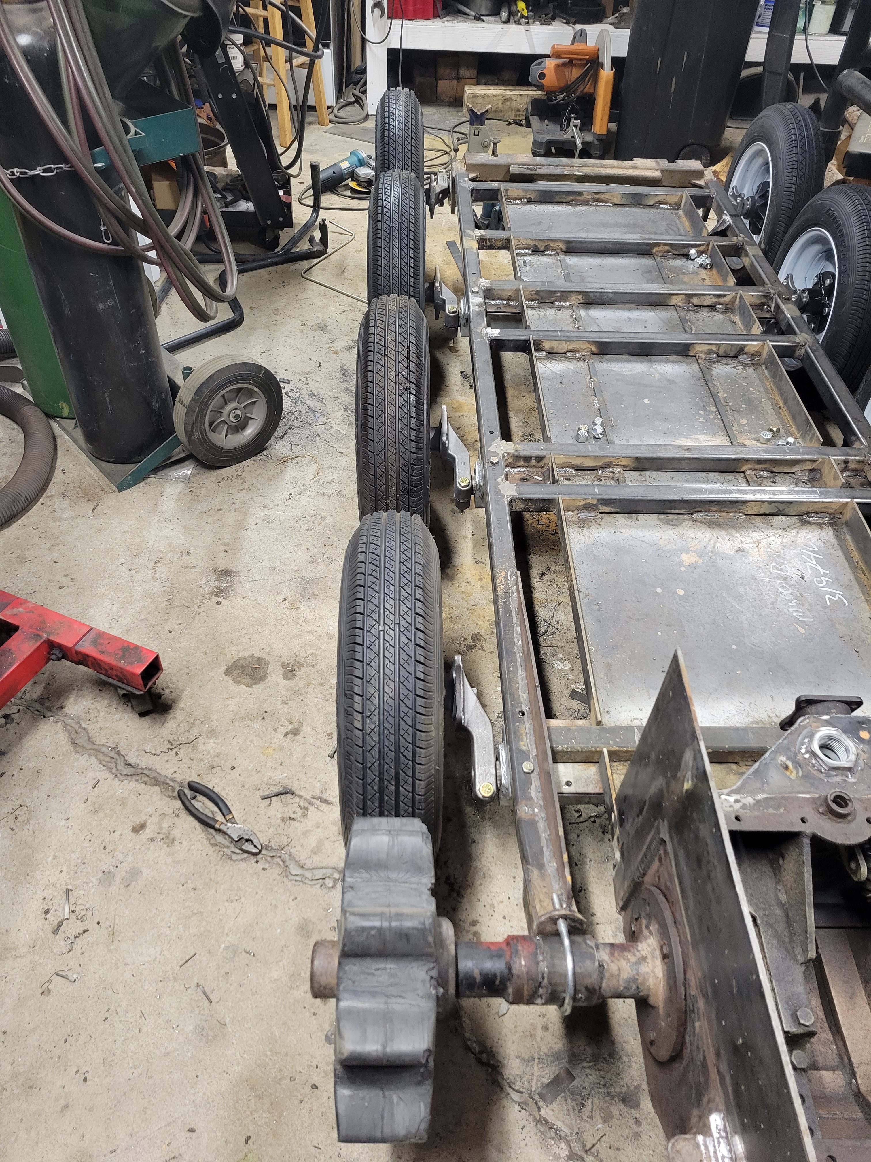

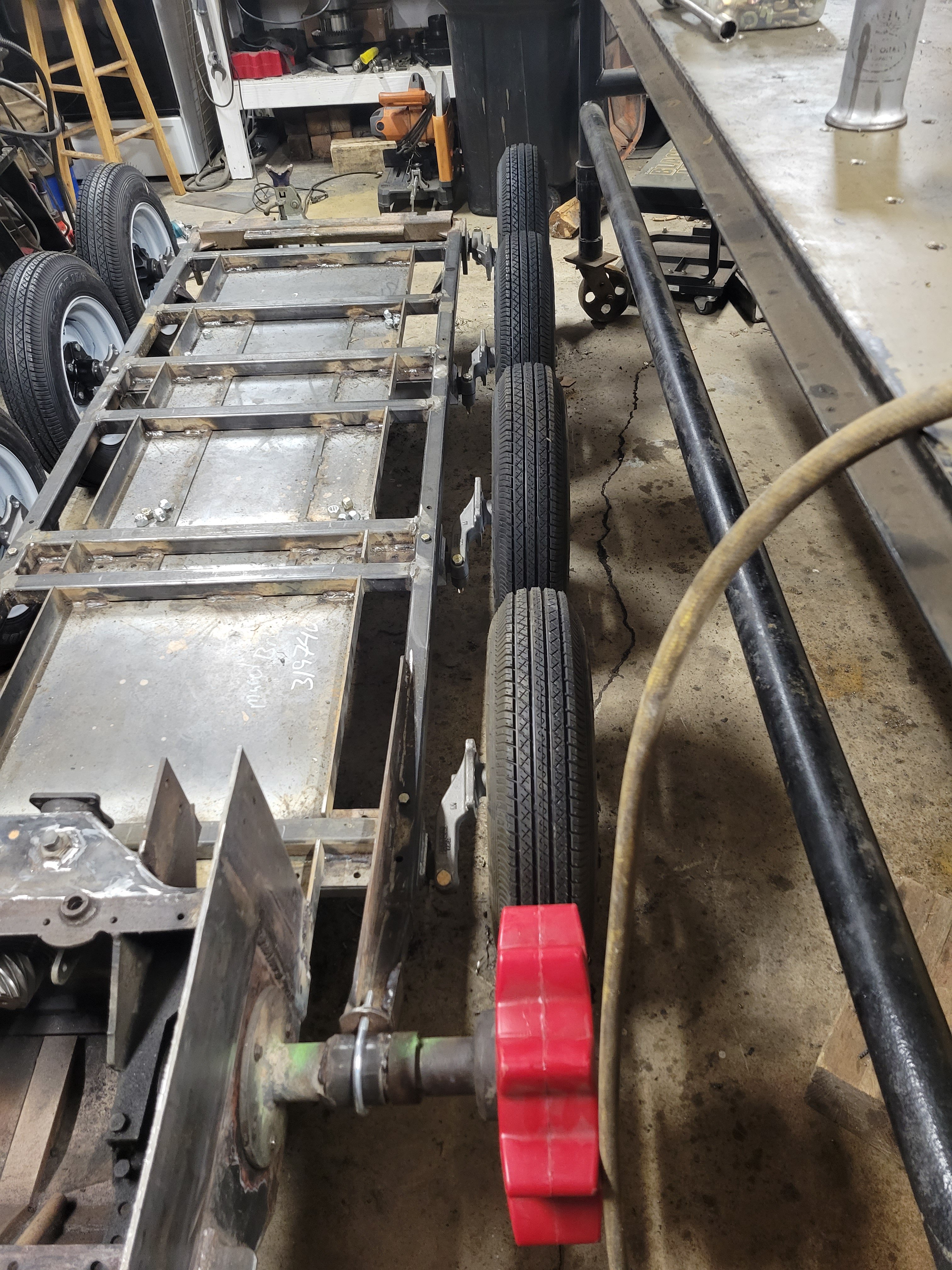

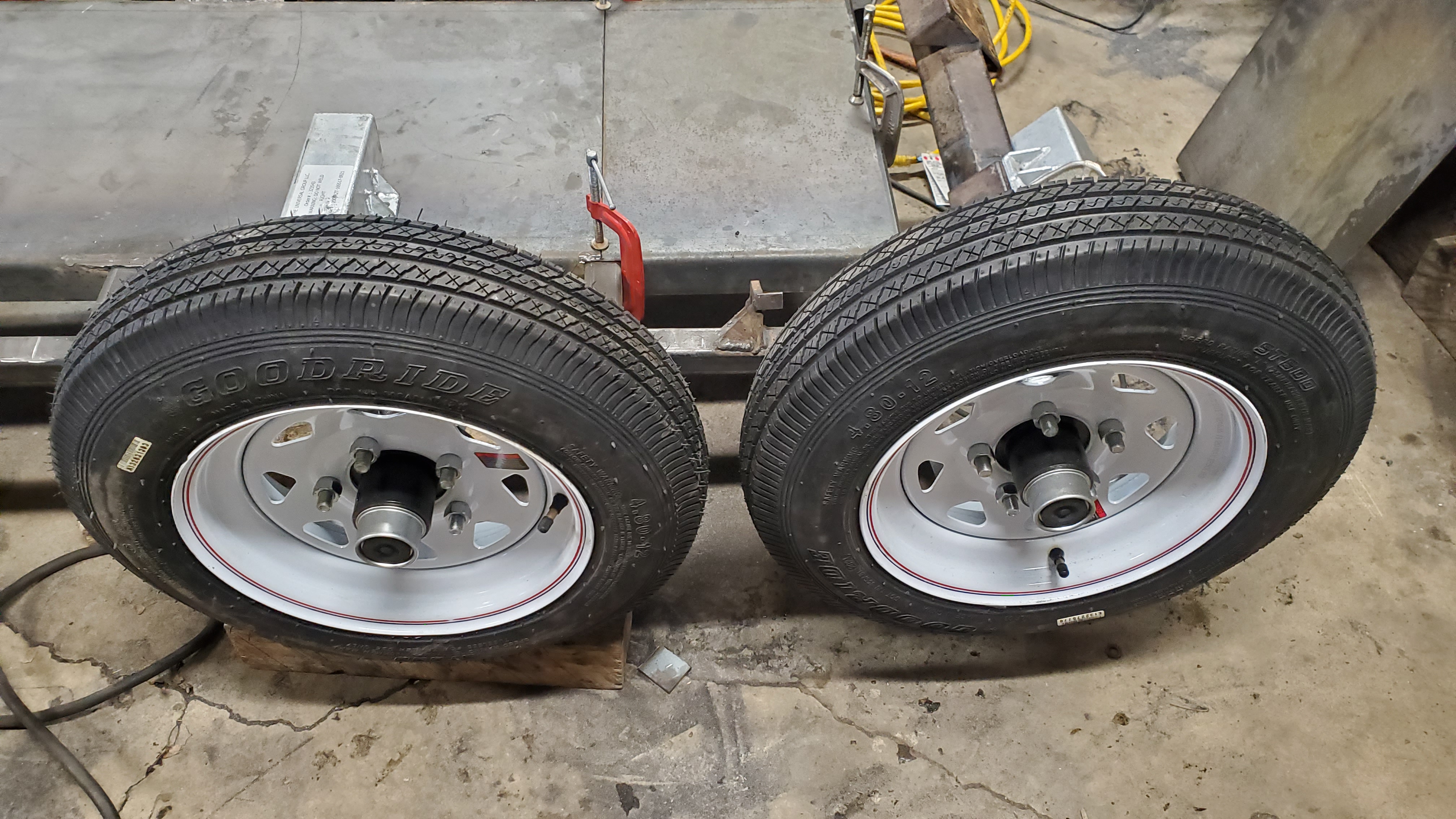

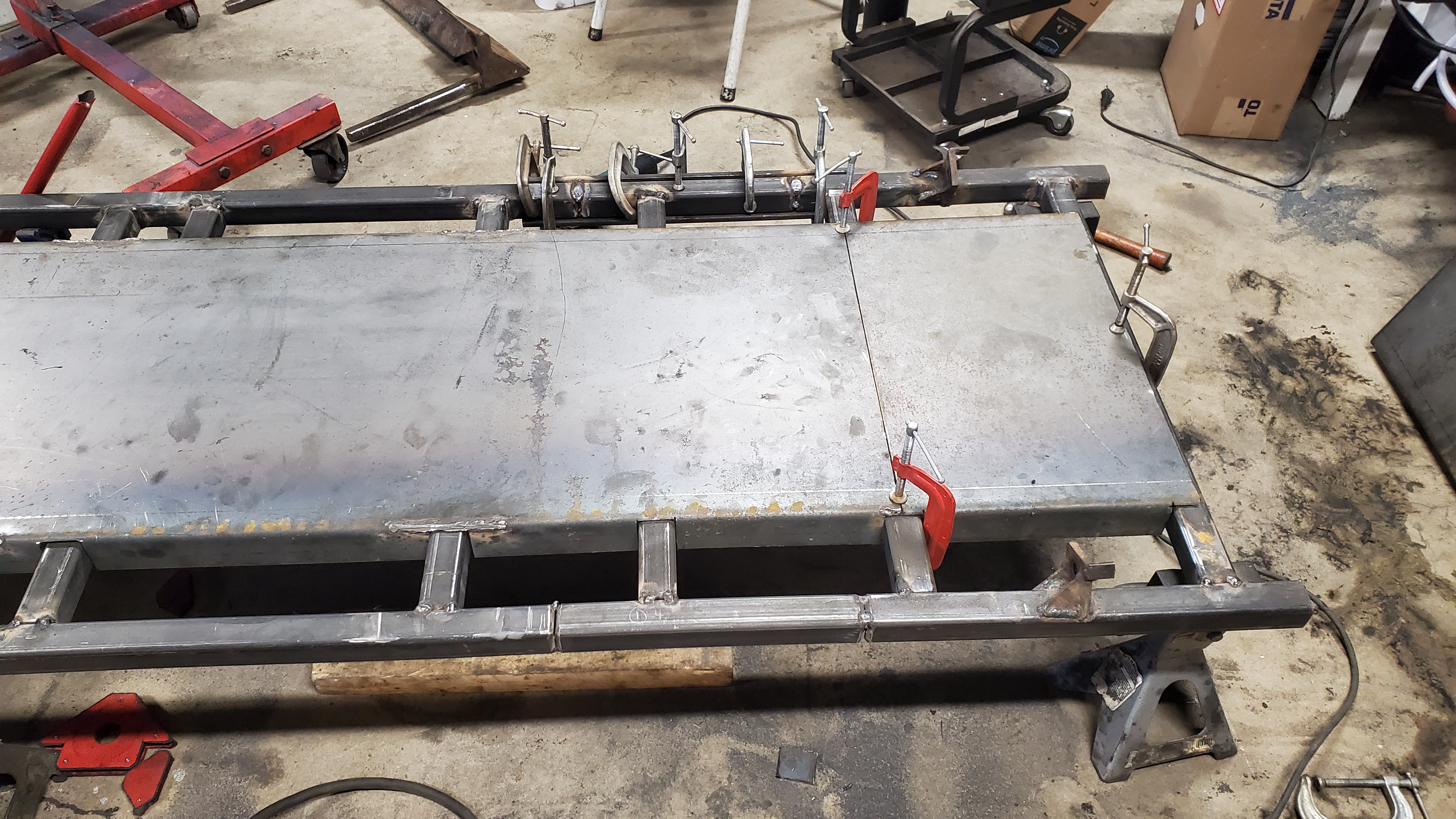

Well, I got the frame extended and everything put in place and Tack welded. Now I just have to finish welding everything together and wait for the new axles to come in so I can keep marching forward. I'm pretty sure those axles are sitting off the coast of California!

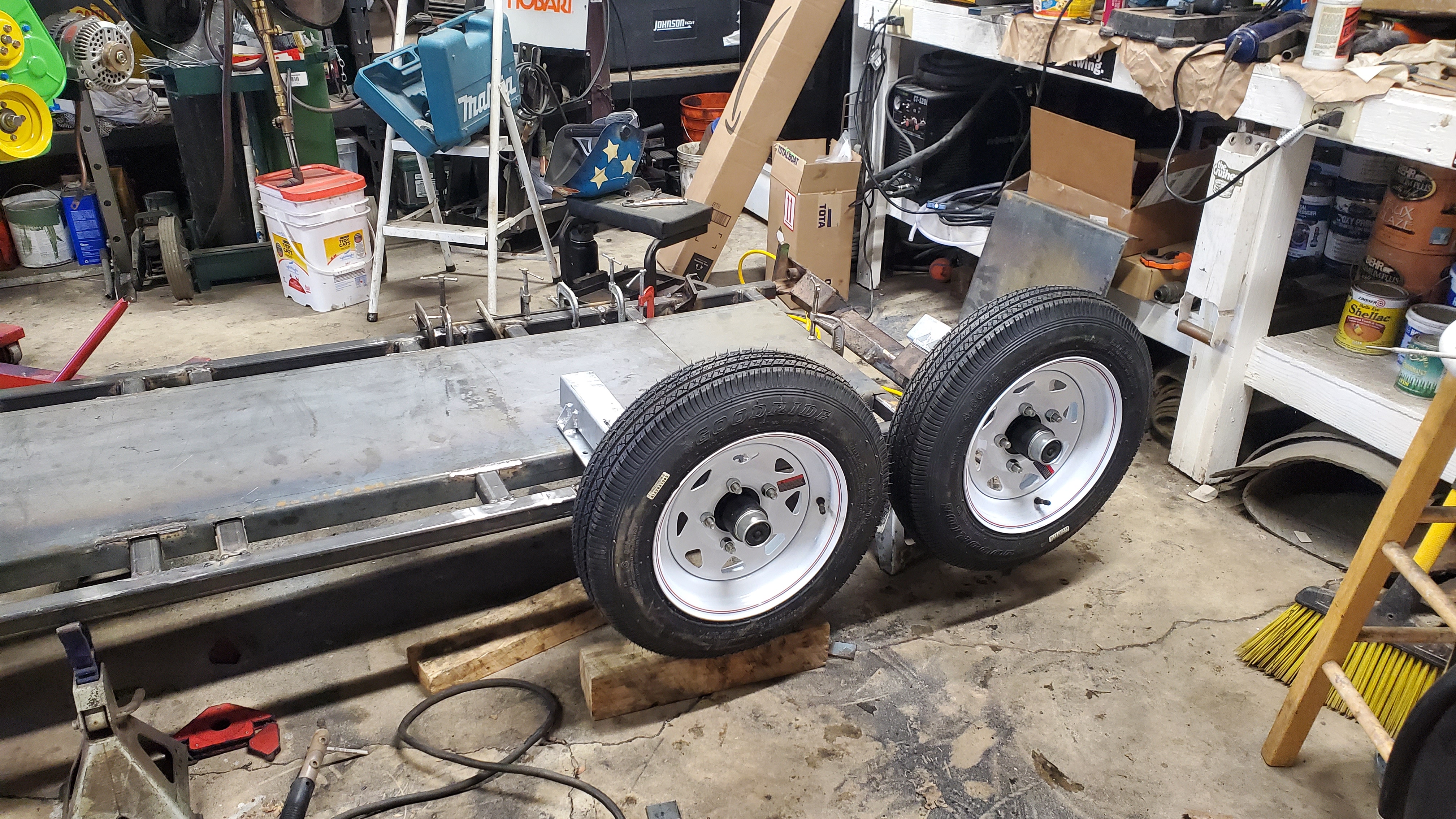

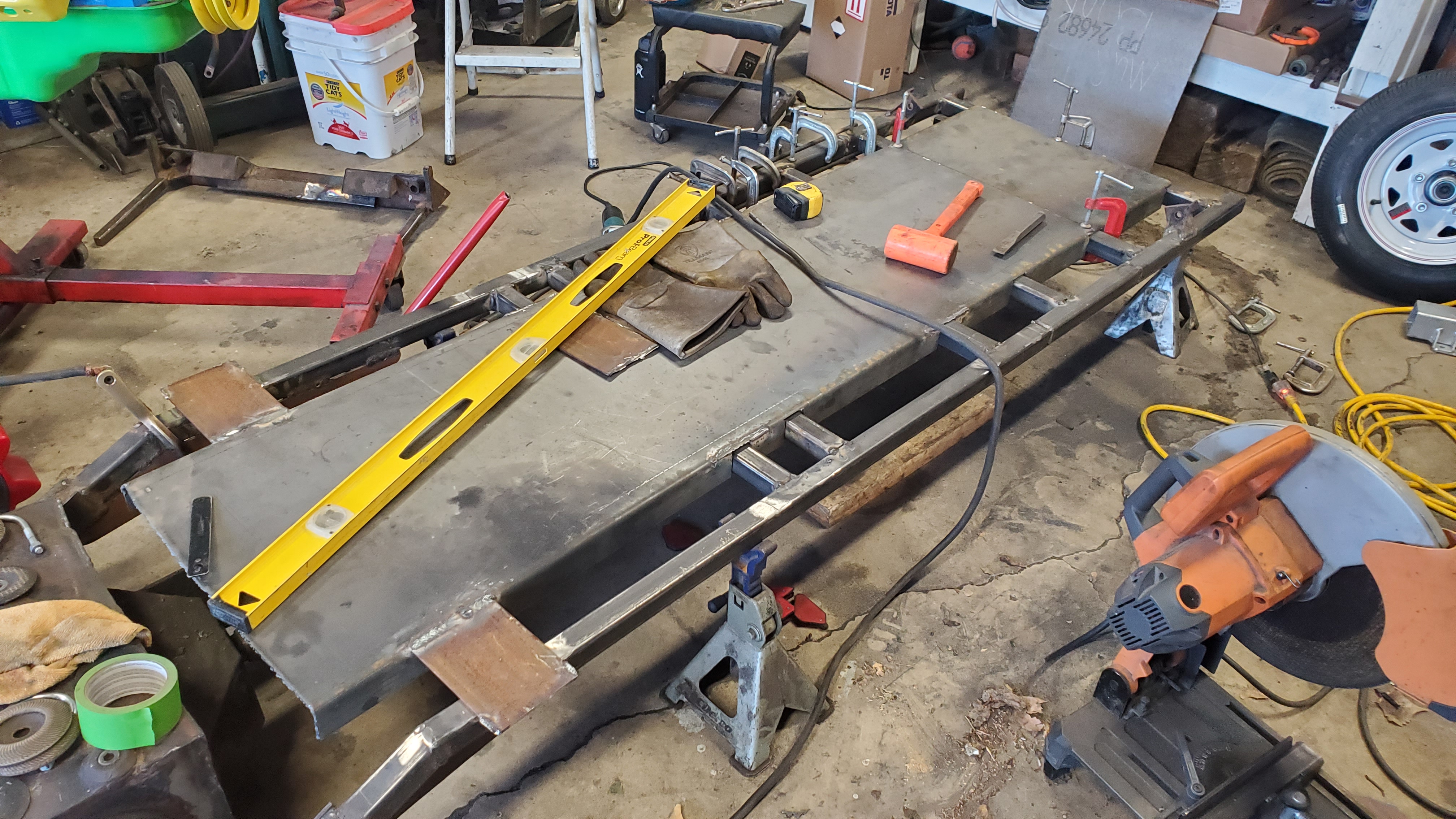

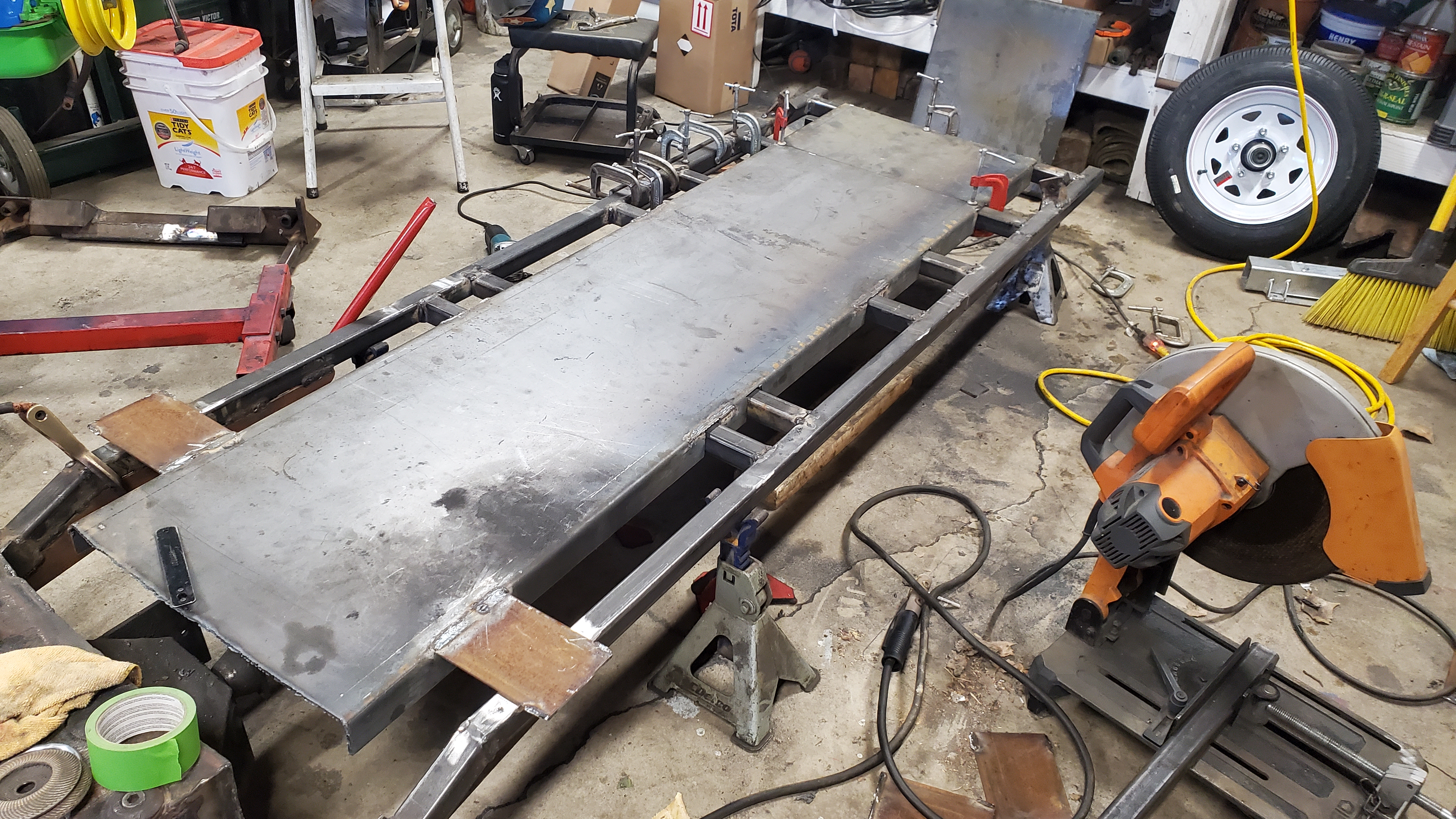

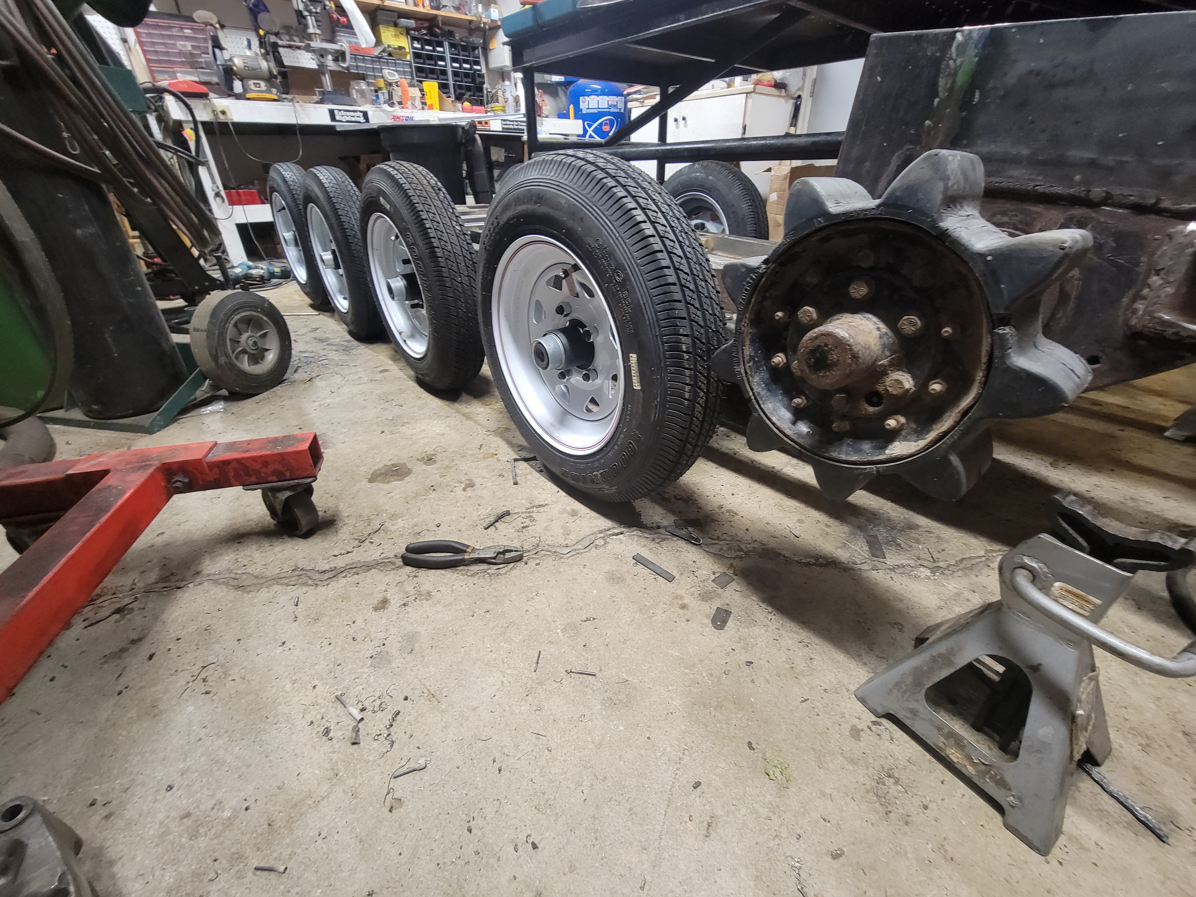

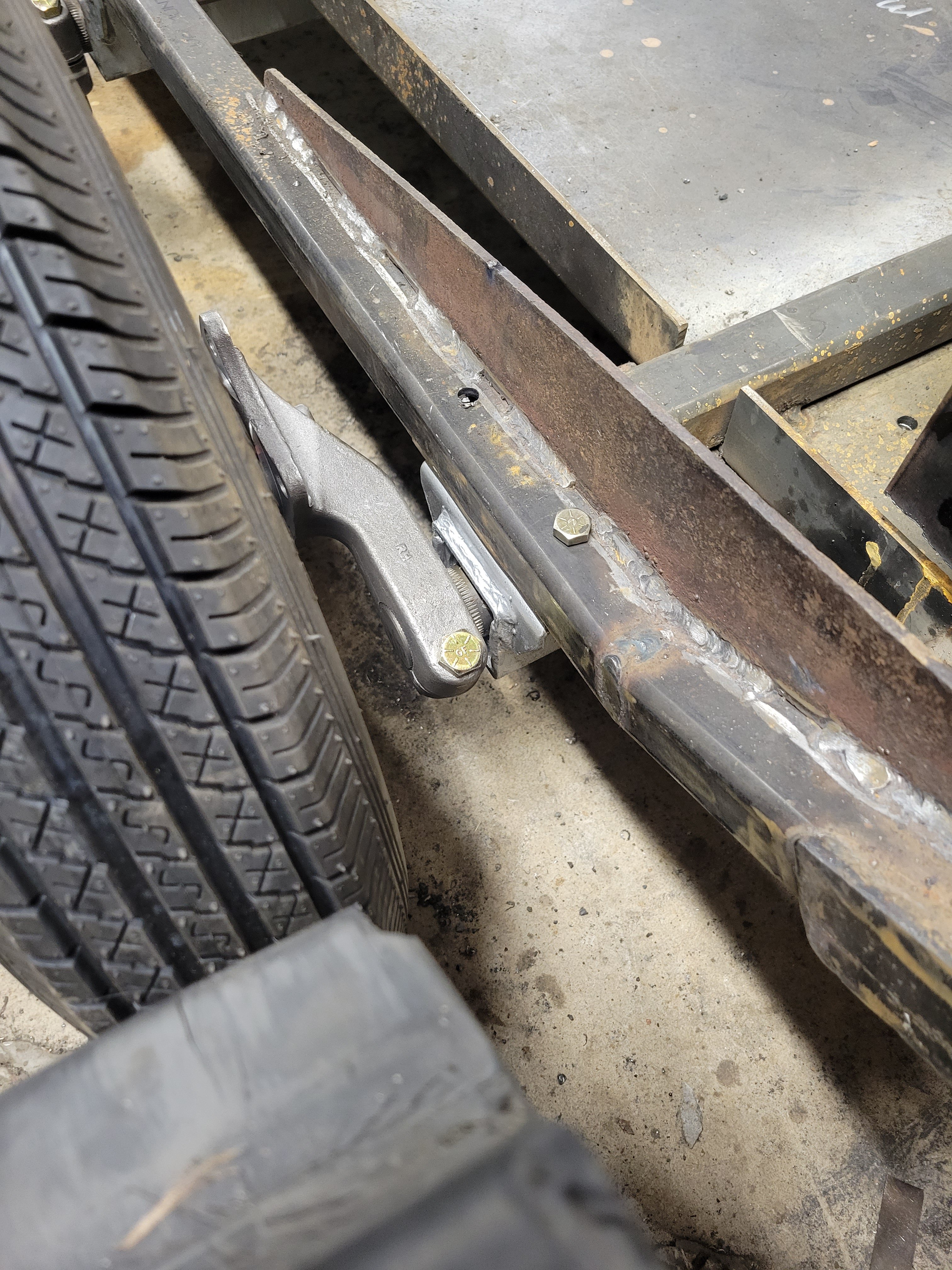

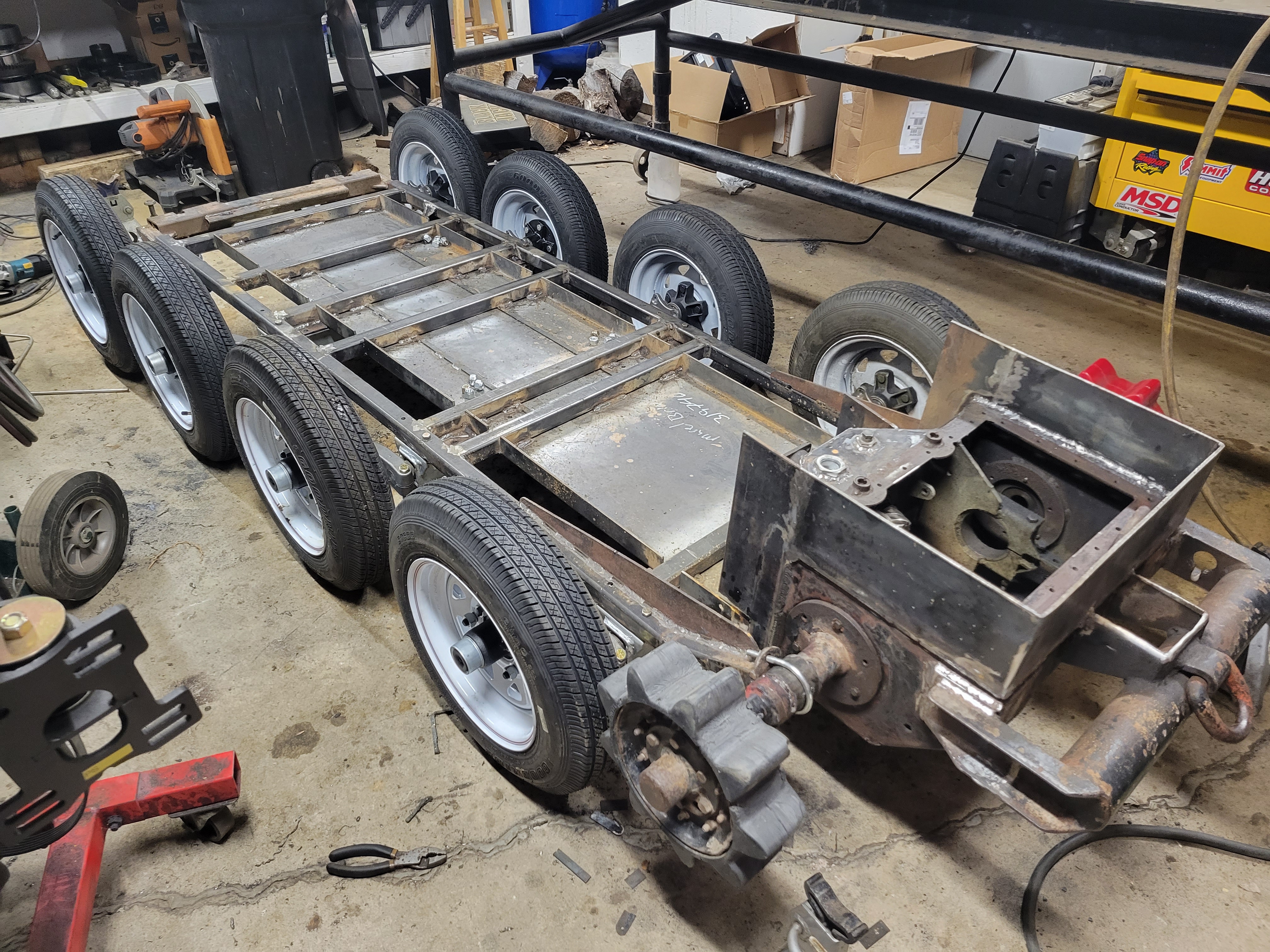

Well, it has been a while since I posted anything on here and I'm sure some guys are wondering if I dropped off the map or not. I ended up taking on a few other projects that took up all of my time. Ended up buying a 1948 cat road greater that needed quite a bit of work and also a complete downstairs remodel of a bedroom / bathroom / laundry room. Needless to say there's not enough time in the day! Anyways, I got some tack welding done today and ended up dry fitting all of my new axles and tires to make sure that the gaps were all still correct and the alignment was on. I have to say, so far I think I may have got it! More to come!

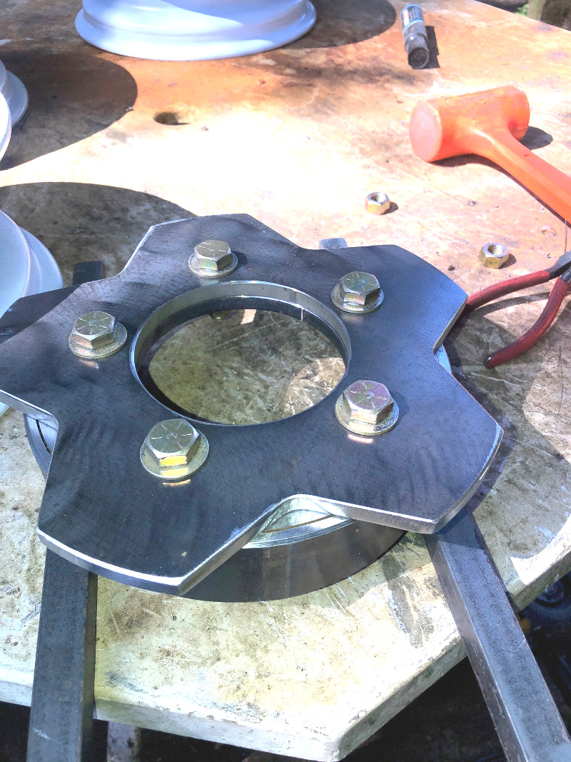

Tires and wheels for these cats are a tough go....

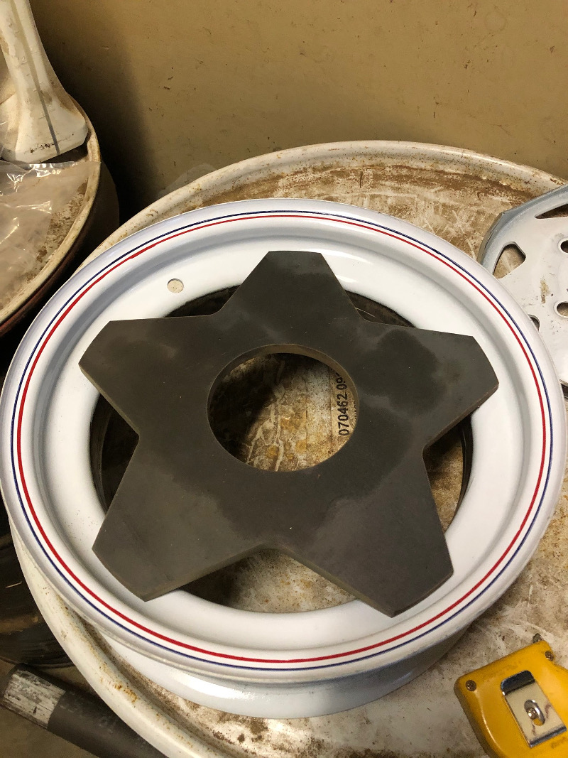

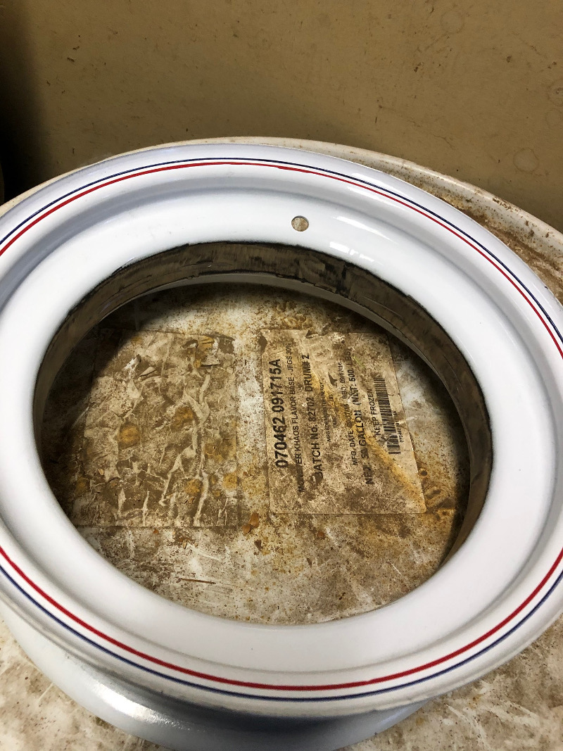

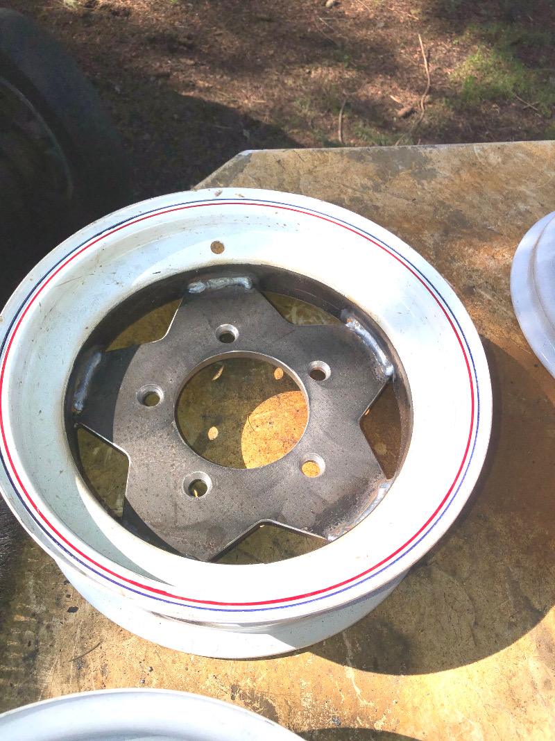

I made the ones for my 2100
5x5-1/2 is a standard bolt pattern for the big machine....Nobody makes a 12" wheel with that bolt circle.
5 x 4-1/2 is all that's out there
I bought a bunch of 12" steel trailer wheels. Cut the centers out and then designed my own centers....Had them water jet cut....Finish machined the OD so they would just tap into the rims.
Had to make a jig to locate the centers to get the correct offset..
Used a 60 degree countersink so standard 1/2-20- nuts work
These are 12" x 4" wheels.....originals are 12" x 3"
No worries ....I found some metric 10 ply tires....
I had some extra centers cut just in case.....And I had one center that has the lug holes all done to use as a drill jig.....
I have 4 of the alloy wheels to use on the front and rear axles......Gonna foam those..
A pain to make the wheels ...but the cost of all new alloys was not in the budget.......
