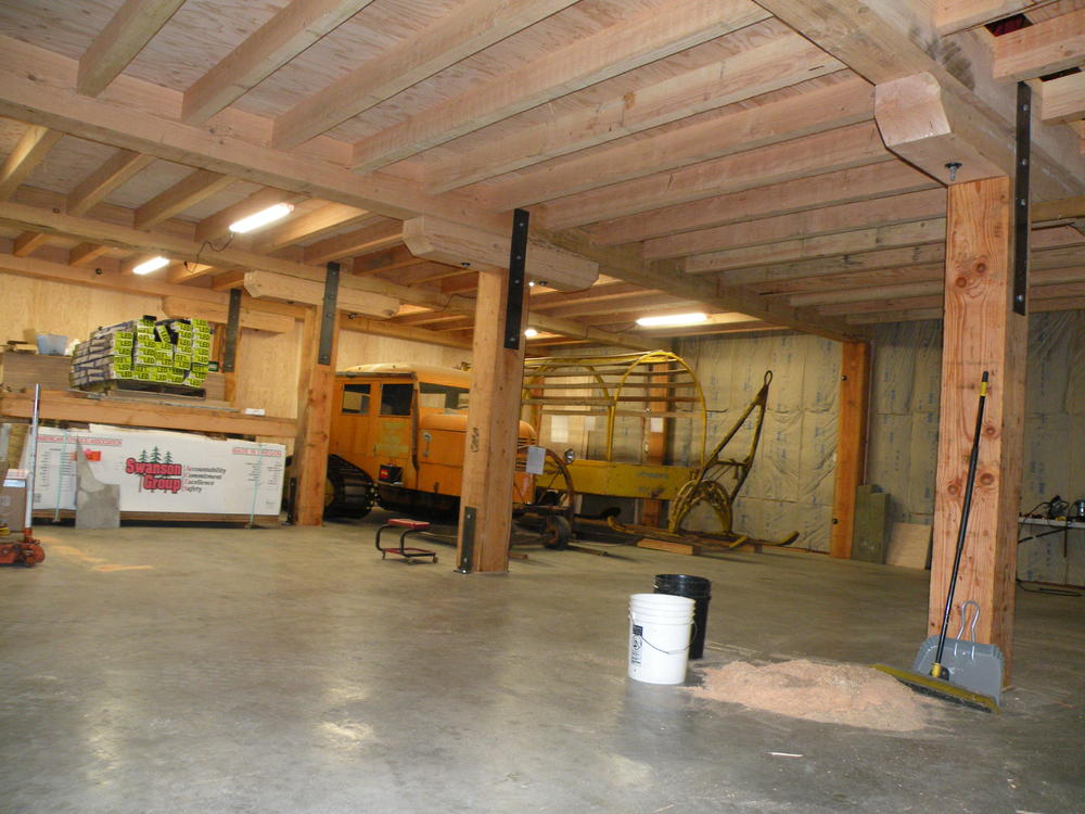

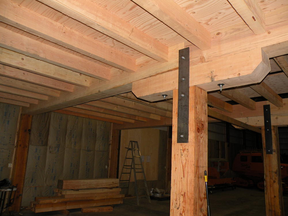

We needed more wood for beams, so we went to the bank and made a withdrawal.

Scott, what you treat your beams with where you put them in the ground? i see you also wrapped them.
The uprights were first burned with a torch, then I made aluminum condoms which are water tight, then pored concrete six foot deep, three foot diameter. I have had two feet of snow on the roof and one side slide off before the other. No snow outer edge came up 3/8 of an inch. Guess I coulda used penta but hard to find these days.
Nice to have a real stand of timber in the backyard !:biggrin: I think you might have a tendency to "OVER BUILD" !!!! Kinda like i do at times, except your workmanship is a lot better then mine, again "GREAT" work.:smile::smile: I have to make a bank withdrawal some time in my pine lot this fall or next spring. What length bar you got on that old stihl "36" ?

Those beams will last forever. Nice work.
