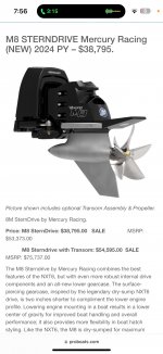

Spoke with a principal from the original Cougar company. So the project gets a bit bigger. Going to put a notch in the transom. And instead of extension boxes for the drives , since I'm doing the transom anyway, build the extension boxes into the transom.
And a Pic of the drives. Found a pair that were race prepped for a bit cheaper than this.
