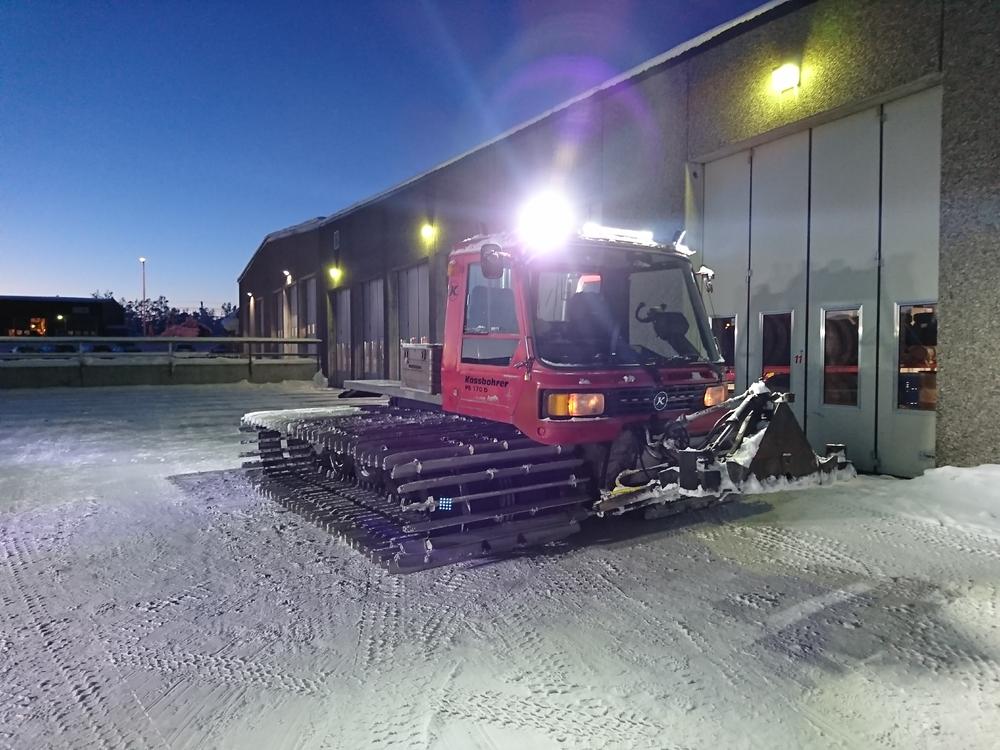

Here is some pictures, had to take off the belts to get it into the garage :shitHitFan:

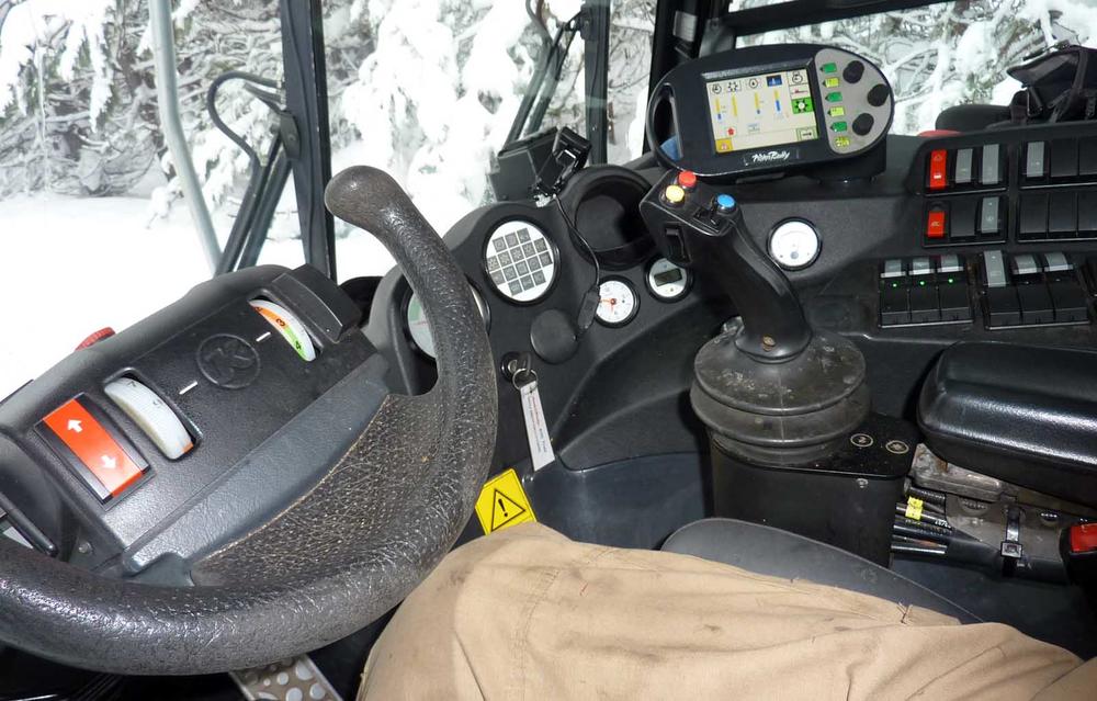

Oh gee, now I get what mitija is looking for. As Jim states, there should be 2 dials which are potentiometers to control the pump speeds. Here they are on the PB 400, seen between the steering yoke. The white or yellow dials with numbers. Maybe there are similar dials on you older machine??

I dont't think there is any potentiometer on the wheel, but there is electronic plate, under radio, whitch has three potentiometers on it. Also I am not sure about three buttons (red and green ) beside radio. Your machine is yunger, i gues it is much more simple.
JimVT
you may have an auto leveling button for the front blade and a emergency kill button.
my canyon is pretty simple and just has the basic switches.
you can turn the potentiometer all the way down and just run the pumps. I just have one.
jim
alryA
I'm far, far from being a PB mechanical expert. Can you post photos of you dash?? Those might be helpful.. Oh, now you did... Can you do more from other vantage points??
