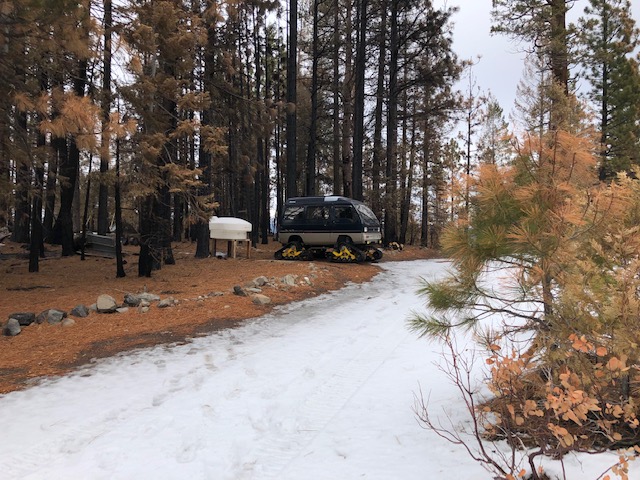

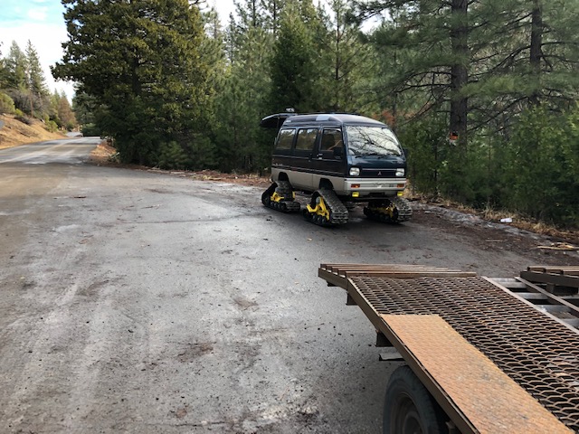

m1west
Its been snowing the last few days bit a colder bigger system moving in and snow forecasted on and off for a few more days. Today I took the Burned Suzuki tithe scrap yard then loaded the Minicab Van on the trailer. When it stops snowing I am planning to make a trip to the Mountain for a few days.
