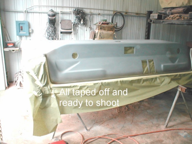

Here is that updated photo you wanted . I just took a little spill in the middle of painting and am taking a break for a few minutes . ! Guess I should have watched where I was going .
I ended up with one small clear coat run and it really pissed me off . When the run dries in about a hour I will hopefully go sand it out and retouch up the area .
PS: all the unpainted area get bedliner

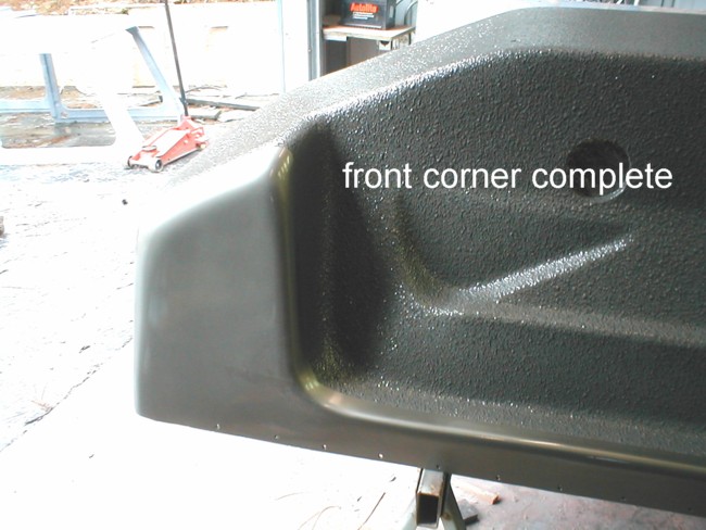

It was a very slow moving day !! I got out this morning and started forcing myself to move to keep from stiffing up any worst , from the fall I took yesterday . Went out to the shop and taped off the area for the bedliner coated areas . I then put a radius on all the tape corners to try and compliment the body curves . Took my time and a couple of hours later I had sanded the area to be bedlined with 120 grit sandpaper and was ready to go .
This was the first time I have ever done this and was a little nervous . I set the air up to 90 pounds to give the liner spray a flatter look and not so rough. The lower the air pressure the rougher the finish .The bedliner mix ratio is 2 to 1 and I had color added to match the basecoat/clear coat that I applied yesterday . The liner is easy to spray and the results are terrific! I am way more than satisfied!!!:coolshade :coolshade
You want to pull the tape as soon as you are done spraying . DO NOT WAIT !!! Pull the tape toward the liner as you remove it and this will cut a very clean line on the liner material . If you pull away from the liner as you remove the tape you will pull the liner material across your tape line and end up with a fuzzy edge . Now leave it alone and let it Dry !!! Here are some pictures and I will follow with a couple of more .

Here's two more pictures .
:drink: :beer: :1062: :5boobs: :moon: The "LOWER BODY IS DONE" !!!!!!!!
