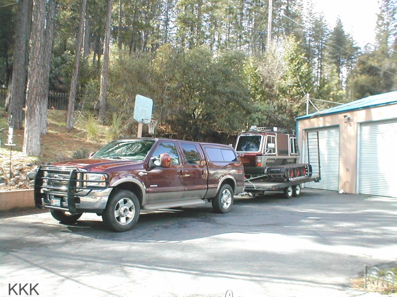

Here's 3 more pictures of Yetti ,loaded up and ready to go .

Cool Al,
That combination of colors will really attract some attention. Great job. :thumb: Did you ever think of either chroming the KT7 wheels or painting the wheels on the King Ranch red.....:yum: Go have some fun and let us know what happens....:wave:
Allen, we have had a lot of fun poking :poke: at each other for the past year but I am willing to let you get the last poke in today. :poke: What do I do? Paint the King Ranch red/orange or the LMC forest green? But, if you look close my wheels do almost match.....:yum:

Hey ... It looks good any way you look at it . What a nice looking Truck/trailer combo. I cannot poke fun of that . I think it looks good the painted colors they presently are .
My next cat will be Red with gold pearl . That is if I can find that damn jar of gold pearl out in the shop !!!??? It's out there .....somewhere.:confused: :confused: :confused2: :confused2:

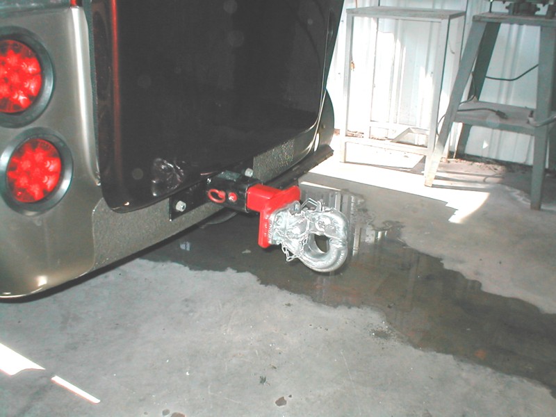

Ok ,All the track bolts and nuts are now hardfaced . I also built a new tow hitch for the back and will install it tomorrow after I paint it .As bad as I would hate to be towed home ,it would be much worst stuck with no tow point to hook to.
So ,I built a real nice "slide in receiver" with multible hitch options . I plan to carry the pintle hitch and used it to pull with and as a ski rope connection .
I also purchased a very nice cast aluminum step , that slides in the reciever and folds up and becomes a reflector when not needed . That should also keep the snow out of the receiver tube .

Also got the new rear hitch mounted and it also came out real nice .

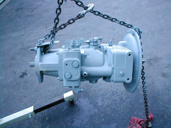

Here are 2 pictures I took as the drives were reinstalled . Does anyone reconize the brand of the Hydro on the rear of the pump drive ??? I know the pump drive off the engine is a Funk Model 61000 series but not 100% sure on the hydro's .

If I may make a suggestion. Change your fluid first. Also hydro stats need awhile to warm up. If the oil was very cold then you would have very little power to the tracks. IF ATF was in them try going back and see how that works. I am going to bet that they will be just fine with the ATF fluid in them or whatever you had in them to begin with.

Because of the age of the drives ,you may be right . I have been going over my diagrams all morning and cannot find any hose that is installed wrong . It appears from the limited information I have ,that the hydro Drives charge there own system and that a external oil pressure source is not needed. It just needs a constant flow of oil ,which I have directly plumbed from the tank .
I have since found out that the hydro's are Sperry Vickers model #323805 and the proportional valve is a KV260-A-03-5E-60MF-KH-10 .
Hell if I know what that all means ??????????

Al, those are combination pump/motors the pump is attached to the funk drive and the shaft coming out the back is the motor. make sure that you have oil at the pump before you crank the engine ........... I mentioned on the phone I would change back to ATF Type F the older units work better on that. that could be a pressure compensating pump meaning that you may never see high speed if you your load is to great after changing fluid. slowly move you drives forward and backward and let the fluid warm up. then on a level surface proceed forward and see if you can get it to go to high.....
