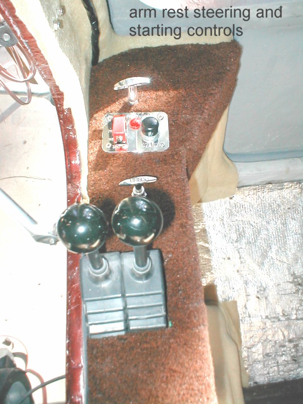

Well .. I broke the Rear window when I was changing out the trim :( . The windows are a mess so I ended up taking them completely apart to clean and repair . I am still not sure when I broke it but noticed a crack in the corner as I was finishing up !!!:confused: :confused2: .
The front console is installed and turned out quite nice .

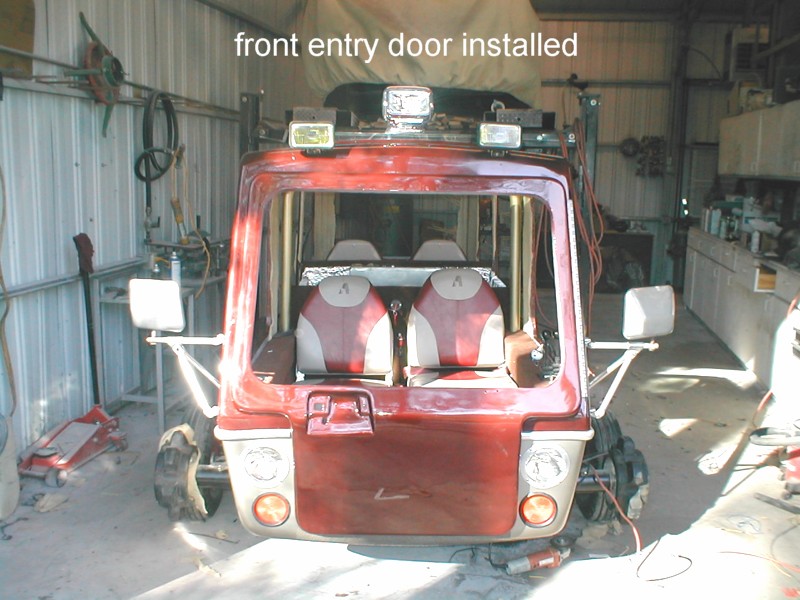

The front entry door is installed also .

Here are some pictures of what I have done:
More
last ones

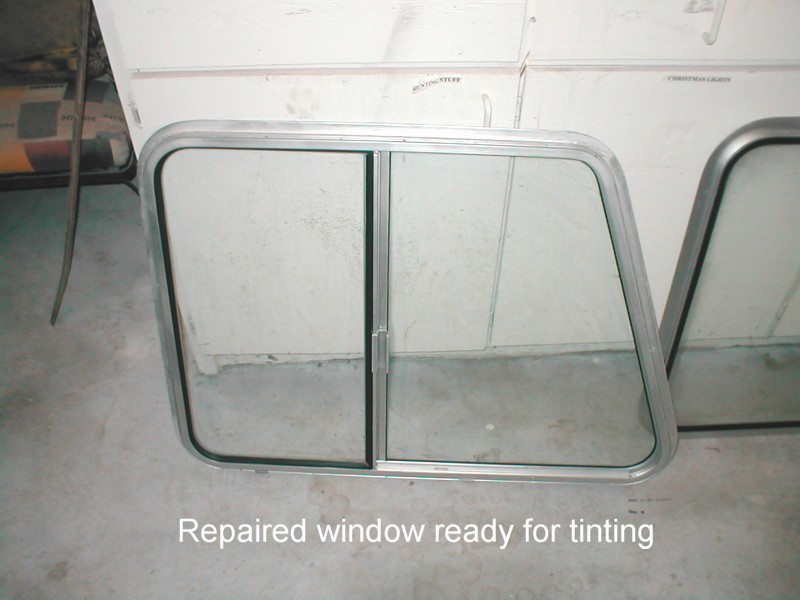

I don't know how many of you have ever worked on RV style sliding windows ,but I can now tell you that they are a major pain in the butt to work on .:( :confused: :mad:
I have spent the whole day completely disassembling , inculding the aluminum frame ,all the windows for cleaning, new trim mold, new felt weather stripping , repair broken latches and so forth . I can easily say that this is the worst job I have encountered on the whole KT7 restoration . Who ever worked on these windows in the past ,must have owned a Silicone company . That crap is everywhere . ON the glass, on the frames, in the latches . :pat:
I very well might be taking the first window apart again tomorrow . The rubber molding is a real pain to work with . It has to be warm when you install it and we have been in the 30's here . I very well might move the whole operation to the kitchen table tomorrow !!!
I also found another 1/2" crack in a window that has been broke for some time ,so maybe the broken window from yesterday was a old crack I did not see .
I have 2 windows yet to break down , repair and clean . I'll snap a picture of a repaired one and one of the originals tomorrow . They do not even look like the same windows after being repaired .

Ok ... Got up this morning ,walked to the shop and took another look at the KT7 windows . They did not look any better than late last night ! No "window fairys" came to make them look better during the night:mad::mad::mad: .
So ... I took them all apart again and started over . I now have 3 done and they look brand spankin new . :a1: :thumb: :cool2: Tomorrow should see me finish the windows unless I am short on new trim molding ,since I had to throw some of it away that I had used yesterday .

OK .... 5 windows are now rebuilt and ready for tinting . They look great!:thumb:

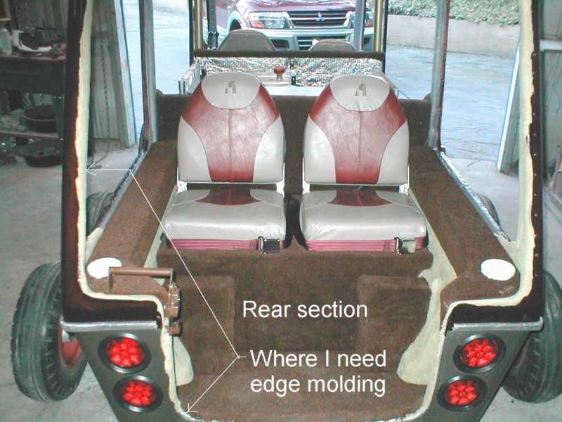

I have ran into a small problem and am having a tough time trying to find a solution . I have upholstered the interior of the KT7 which never had any in the past . I had just assumed I would use a nice vinyl edge molding around the door opening lip to finish off the raw edge of the fabic . NO Go !!!:confused2: With the molding in place the door binds on the edge . I am thinking of trying a adhesive backed cloth tape to finish the edge now . It needs something to give it a finished look and this is the only thing I can come up with . The door itself will have a foam rubber seal in the groove so it will serve two purposes of providing a airtight seal and finishing the edge of the door fabic . Anybody got any other idea of what might work

Silly question, but can you install the vinyl edging as planned and then simply space out the door (and probably the locking mechanism) with an extra washer to add just enough gap to allow for the edging?
Already tried that . The door is just too tight all the way around . Geez! The vinyl molding is only 1/16" thick for crying out loud !!
Ok .... I think I found a solution for the finsh edge molding . A adhesive cloth tape made to finish edges . I'll try it tomorrow .

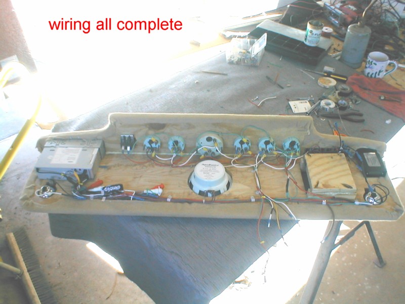

I been working a few kinks out of the wiring system . I got a couple crossed wires . When I turn on the wipers the popcorn machine comes on and the heater switch seems to control the horn and beer tap at the same time ???I may leave that alone as it tells me if someone is stealing beer .:confused2: :confused2: The Lava Lamp won't work at all ...:confused2: But I'll get there .......
BUT!!!! The stereo works like a charm and the ole shop was rattlin some windows this afternoon !!! A little CCR , Nitty Grity Dirt Band. and Leonard Skynard CD's and I was rockin !!! That little KT7 is just like a BOOM BOX now !!! I may break down somewhere ,but the music is going to be great until the battery dies .
The remote control spot is without a doubt the greatest thing I have ever seen . Wow! Is that puppy bright ! :a1:
I did not take any pictures today because all you would see is a mess of wires .

Well the KT7 "Yetti" main electrical system is complete . It works great .
I ended up with 2 fuse panels ,1- 6 switch lighted console , 4 relays, 2 fan switches , 4- adjustable dome lights , 1- engine compartment area light , 1 horn buttom , a racing starting system , 1- AM/FM CD stereo unit , 1-GPS unit ,1-remote controlled spot light , 1 cell phone , 1- 12V adapter plugin , a alternating flasher light control unit and a exterior temp gauge . :cool2:
There are 2-Rear halogen flood lights , 2-front halogen fogs lights , 1- "remote controlled" front spot light that will spin 370 degree circle and travel 135 degrees up and down with a optional hand held remote that will work up to 150 feet from the unit , 2-halogen head lights and 4 LED stop lights on the rear . I should have plenty of light !!
I still have the intercom system to install which may happen tomorrow .

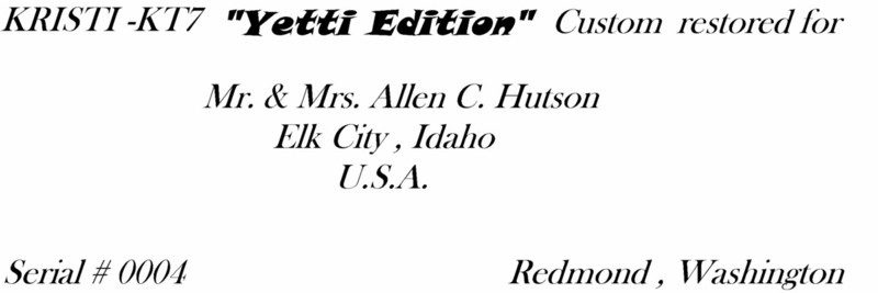

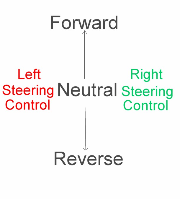

I also made up some name plates designs that I will be using . Before I head down to the sign shop to have them made up ,take a look and give me your input . The first two will be on black plastic plates with white engaved lettering except "Track steering Control" which will be in "Red lettering on the left" track and "Green lettering on the right"
The last picture shows the name plate design that I will have made out of silver to be mounted on the interior console .
