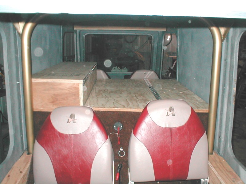

The new engine cover is finished and ready to be covered in carpet . I made it up out of ¾ “ Plywood and piano hinges . I ended up building it in two pieces so it can be easily removed without killing myself :cool2: . There is also a enclosed area for the Mini Bar , As well as the first aid kit , tool kit and a emergency pack . The engine side of the cover will be covered in a flame retardant insulation/ sound deadener . That should help with engine noise . The top side will have the same carpet as the floor area . Here’s a few pictures .
I’m not sure but I think this was the last part that needed completion before I start tearing everything down to finish paint , upholstery, wiring, window tint and moon roof cover .
I am going to think about everything over the Christmas Holidays and then start working again in about a week .:confused2: :confused2:
I will also add a engine light in the engine compartment as it is quite dark in there .
If I missed anything , I am sure you good ole boy’s will let me know .:toilet:
a few more
Evenin' Al, If you haven't considered it already, you might plan some kinda tiedowns into that cover, or a basket of some sort... ya know your gonna stack something on top of it that you dont want sliding around, and whackin' ya in the head while your cruisin' downhill.
I might also consider closing in the starboard side of that box on top to keep small things from falling where they dont belong, and the protect the precious side of your plastic snowcat.
Eric
Edit: P.S. do you think there a need for a ventilation blower...like a boat?

Eric... I plan to add a piece of wide aluminum flat bar that will act as a stop on the engine cover to keep stuff from smackin me "up side the head" .I want to carpet first .Inside the Mini Bar area will be carpet to protect the finish . The other compartments can easily have a added piece of carpeted plywood to protect the fiberglass if need be . Tie downs are a excellent idea :thumb: . I never even thought about that :pat: . Something like the wife has in her SUV might work well ??? I wonder if she would miss the tie downs and net ???
I actually thought about a blower yesterday :confused2: . All the intake air comes through the side vents of the body . Is this enough fresh air to prevent an explosion ? Maybe a Boat owner/builder can jump in here .
rlk.... The weight issue and also upgrading of the KT7 has been discussed before .It actually helped start a very heated discussion . One FF member actually left this website because he felt so strongly that I was " Messing in up" when working and restoring the KT7 . He wanted it original ,right down to the ranch name the old owner had placed on her side .He did not even think it was funny when I change the name on the side of the KT7 to Yetti , out of respect and resemblance to my first ex wife:whistle: . His knowledge and working understanding of a Kristi KT7 was and is very limited , possible caused by having never seen one but claiming to be the authority of all models of Kristi’s :smileywac . There is something to be said for youth ….What was that term my father always used …..OH yea “ The blind leading the blind” .

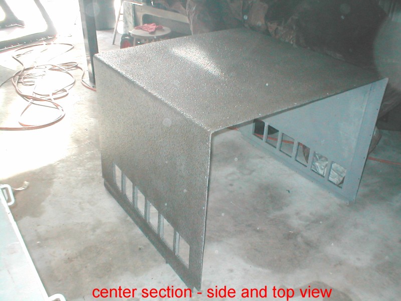

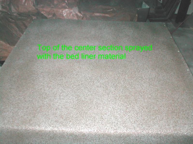

Well I shot the bed liner material on the center section of the upper cab tonight . All I can say is WOW :thumb: . That stuff is amazing if you need to cover up some really bad wavy areas . The old finish was some kind of simulated vinyl finish :puke1: . This was used because the center was so imperfect from the factory . I repaired all the holes and cracks in the fiberglass, sanded out all the old simulated vinyl marks and then shot an epoxy primer/sealer over the whole thing .I had saved enough material from when I shot the lower section so there was no extra cost for new material. Tonight I shot the left over bedliner spray material . I can not recommend this stuff enough if any of you guys need to repair a bad area .:thumb:
Tomorrow I will take some pictures and I should be completely done by Friday on the paint if the weather holds .
Here's a couple pictures of the center section after spraying on the bed liner material . The first picture shows what it looked like before repairs . Notice the big dip in the top where the old plywood core was rotted .
This will get another coat of Base Coat/Clear Coat shot over this when it completely gasses out . Very big difference !!!
