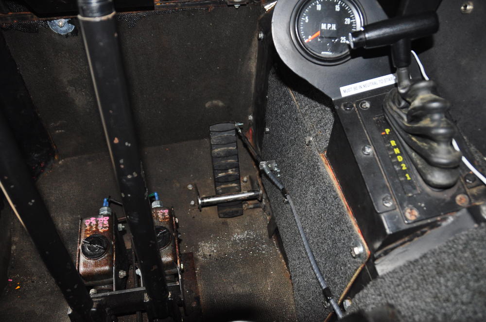

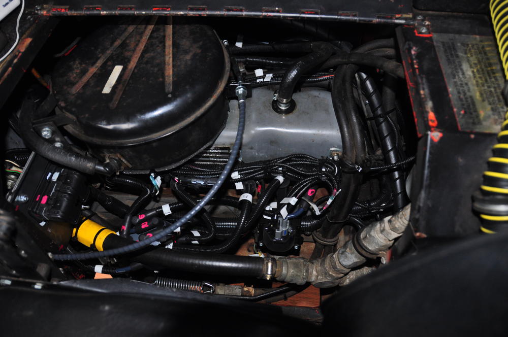

I decided we were done fighting fuel and carburetor issues on this cat. After much research and some advise from here I had the AFI fuel injection system purchased and installed. I talked to Norm and he suggested that the GSE/Industrial (300 CID Ford) Gen 2 system would be ideal. I wanted to keep the throttle linkage intact so that the automatic transmission would shift properly. The Gen 3 is a drive by wire and would be ideal for a manual transmission.
https://www.affordable-fuel-injection.com/
The kit was complete and fairly straightforward to install. The mechanic was very impressed. The complete ignition system is also included.
It was mostly a bolt on and wire in project. The O2 sensor was a breeze as the manifold was ready for the sensor.

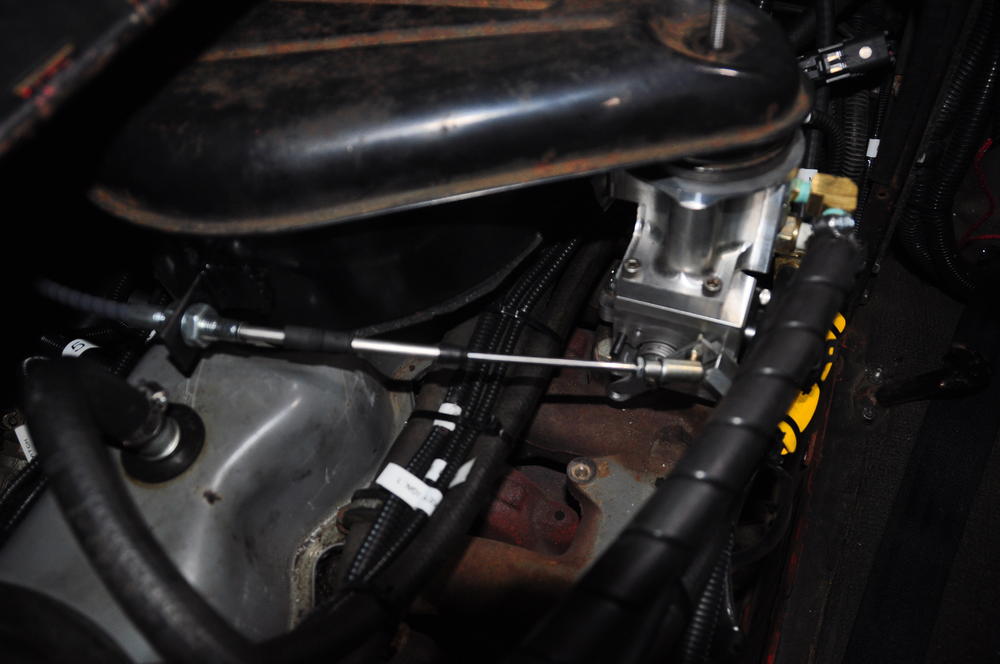

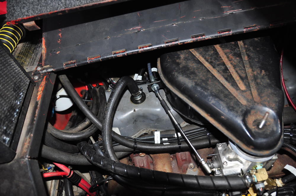

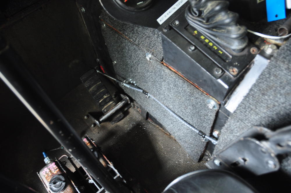

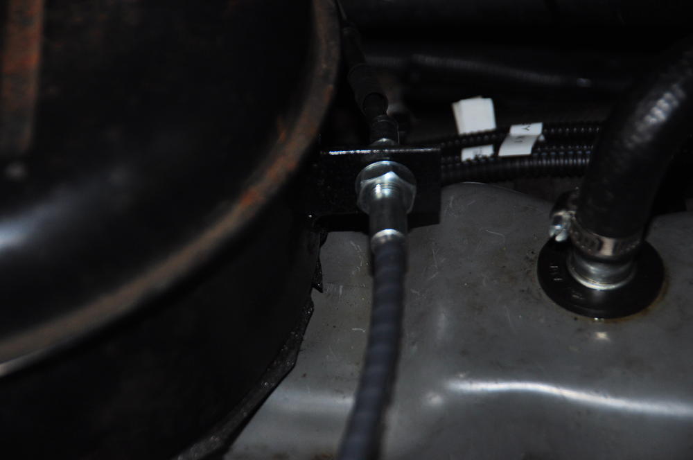

The throttle linkage ended up being a minor issue. They decided to add a cable to operate the throttle plate. The original carb linkage was in a different position by 90 degrees. The factory setup wasn't going to easily work. The kickdown is still connected and should work correctly.
The day I drove around it was 90 here so it was a short trip around the dirt parking area.
One other issue popped up. It wouldn't run over 3,000 RPM. I sent the ECU back and it was reprogrammed to govern at 4,000. Should be plenty.
