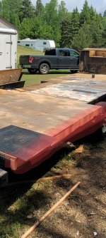

I started cleaning up the flooring and removed the carpet from the upper deck so it won't retain water. The plywood is actually exterior grade. Only the back two sheets are soft from water damage. I'll replace those. Originally I was thinking 2x6 decking from the cheap surplus lumber yard and coating it with Thompsons water seal. Now, I'm thinking about just leaving it plywood and painting it with exterior paint. I'll finish up the sides with treated lumber. I'm also leaving the front storage compartment under the tongue and enclosing it fully for helmet storage, starts, blocking etc.

It's actually not too bad of a project. There's probably quicker and easier ways to demo a camper. It's my first time and I'm learning as I go along as well. I was originally going to strip it to bare frame and reinforce it with additional frame supports but as most of the plywood floor is solid and it doesn't need to haul a backhoe, only 4 snowmobiles in the winter and my sxs and quad in the summer, I'm going as cheap as possible. So far all it's cost me is time from the time I started painting their place to hauling the fifth wheel over here three weeks ago. I have the time and the tools. It's keeping me busy instead of just sitting in the house channel surfing. Lol
I was debating on a ramp lift gate for the back or just sticking with a set of folding ramps (which I already have) for the quads and sxs and a different folding ramp for the snowmobiles. I may go that route as the lift gate would require additional frame supports 🤔
Edit...pro tip....a skill saw works great at cutting a metal roof on an rv and through the corner wooden roof supports. 😉
