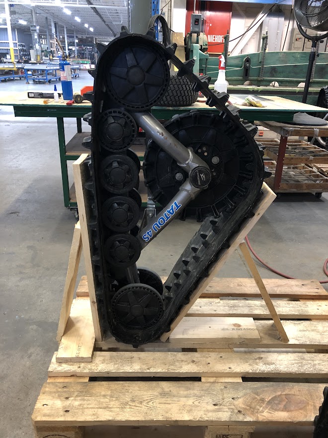

I've installed about 6 sets of these onto ATV's, UTV's and our 6x6 so you might be helping others by describing the various parts.
