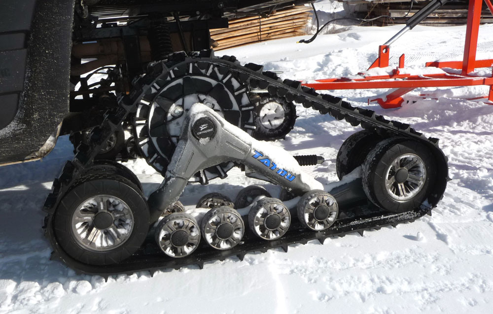

I'm sure you guys don't know that I have many, many years of experience using Camso and Soucy pods on both UTV's and ATV's. All these hours of use and servicing them, gave me opinions of there respective quality. If some of you guys have interest in these pods*, feel free to have a conversation about them here. Maybe questions??
*the individual units are called pods.

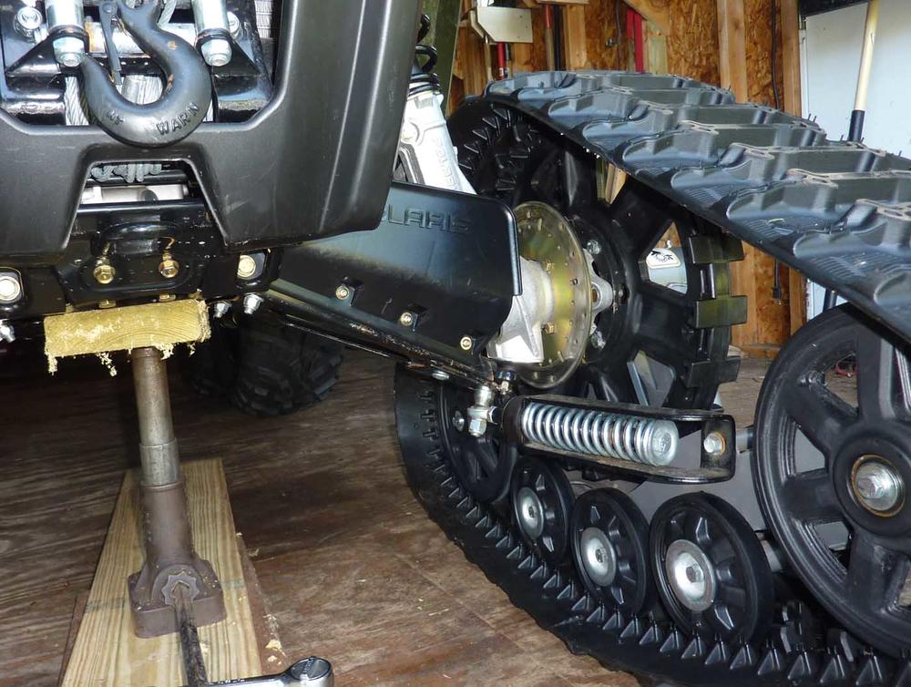

do you have anti-rotation mounting kits? The 1st photo shows the mount kit. The 2nd shows it installed. The anti-rotation parts need something to be anchored to.
Yes very similar to that, I will probably have to modify a little to fit the A arm on the mini truck. I can take a picture tomorrow of the anti rotation set up that came with the tracks and post it. I have wheel adapters ordered to fit the truck to the tracks and a lift kit. It should show up in about a week. Getting everything bolted on shouldn't be a problem. Set up is where I will need help.
I was thinking the travel limiters should be set to travel as far as they can without rubbing. Does that sound right? Marty

The anti-rotation limiters have soft stops going in both directions. One way you are against rubber donuts while the other is a steel spring. Least that's how most are. Do post photos when you can.

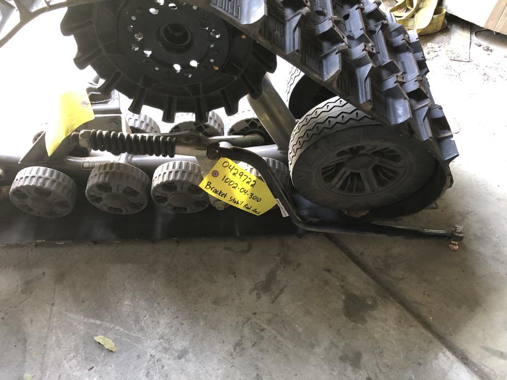

The front one attaches to the a- arm and has the rubber bumper the rear is for a rigid Axel and does not have the rubber bumper, I thought they were missing but looking in the manual the solid Axel type do not have it but machines with a arms in the rear have a different mount with the rubber bumper. The manual also gives measurements for initial set up. Marty

The bottom photo must be a rear pod?? Those factory bent bars will get bent in the field. The anti-rotation system goes through hell of stress while stuck or getting up something steep, like a ditch. As you might image, the heaver the vehicle, the more the stress on these. The anchor for them needs to seriously mounted as well.
The top photo is the front and that funny little bracket attaches to the A-arm. The bottom photo is the rear and is bent for clearance around the track both sides look the same. The manual says the end of it with the hime joint mounts to the rear Axel parallel to the ground. I will have to fabricate a bracket when the lift kit and wheel adapters show up.

Thanks I was thinking the same there are going to be situations where the tracks can't rotate enough to match the ground going over a berm or ditch. When in doubt make it stronger. I think I am now getting my head wrapped around what I need to do to get them installed. The help is appreciated. Marty
