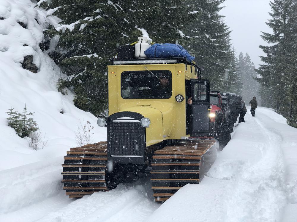

as many might know, I've been restoring the Frandee for past few month, which got me thinking to build a cat from scratch.
So the whole open differential 4x4 car design that Frandee used, is that efficient system or does not work wholesomely in the real world?!
In my times of use, I've found it to be doing the job, may be not efficiently well, but considering its years of design (40-50s) - its alright.

p.s.s. Frandee leading the pack...

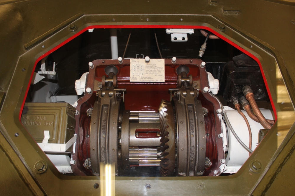

With that kind of payload I would use nothing smaller than a OC15 differential
We use those on machines with planetaries that are in the 40,000 pound class
Or I do have some M24 tank differentials new but I think they would use your budget up in a hurry (pictured )
If you really want 30 mph speeds the Thiokol 600 series (OC15) will do it and handle higher HP but would require different tracks and undercarriage

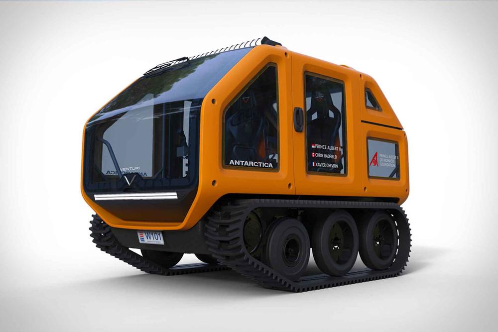

Diesel electric units are already being built for a number of years, just don’t drop them in the water. Prinoth makes one now, I also believe Pisten Bully has now made one. Direct current models are heavy AC three phase is not as bad.
If you look back about 3-4 years I discussed this on here
One one pictured is made from components from Prinoth.the wheels, tracks, final drives are from there current production sidewalk plows
https://thedriven.io/2018/12/04/this-pure-electric-vehicle-will-explore-antarctica-pollution-free/

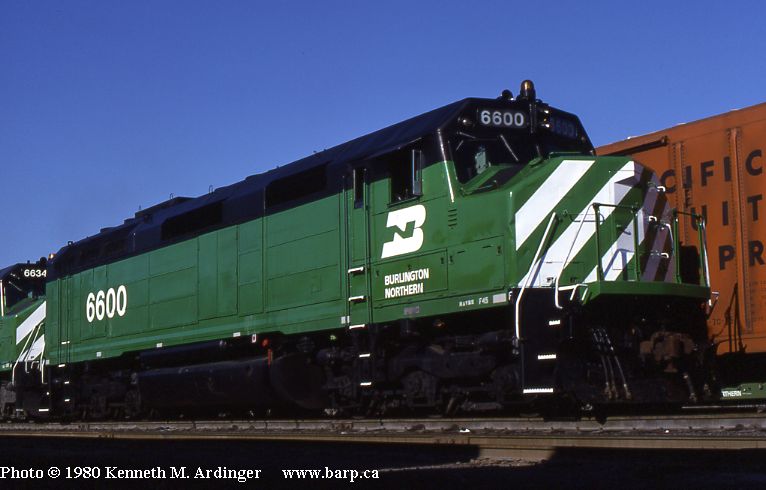

Like I said, every time you change the means of energy transmission, from coal to steam to turbine driven rotary mechanical to electricity to batteries to electric motor driven oxcart, you lose something. The Tesla is literally powered by coal/ natural gas/ hydro because that is where the majority of the power to charge its batteries comes from. In the process a very large percentage of the original energy input is lost to transmission/friction/heat. It just has the illusion of being environmentally sound because the power plant is out of sight in some other poor sap's backyard..(and has to burn more fuel to generate more energy than if the fuel were burned directly in the vehicle being powered.
Locomotives have to be able to deliver high torque to the wheels at zero speed. That can only be done with electric motors, steam, air or hydraulics.
Union Pacific tried a diesel- hydraulic locomotive set in the 60's but it was not successful. Too expensive, unreliable and difficult to cool. Diesel electric is the best technology we have for that application currently. Not super efficient, but they make up for it with the economy of scale. Five 3000 hp locomotives pulling 10,000 tons of freight is fairly efficient on a ton/mile/dollar comparison to other means of transportation, (not to mention impressive as hell) but not practical on a small scale.
It all comes back to the KISS principle. (engineering lingo for "Keep It Simple Stupid!")
