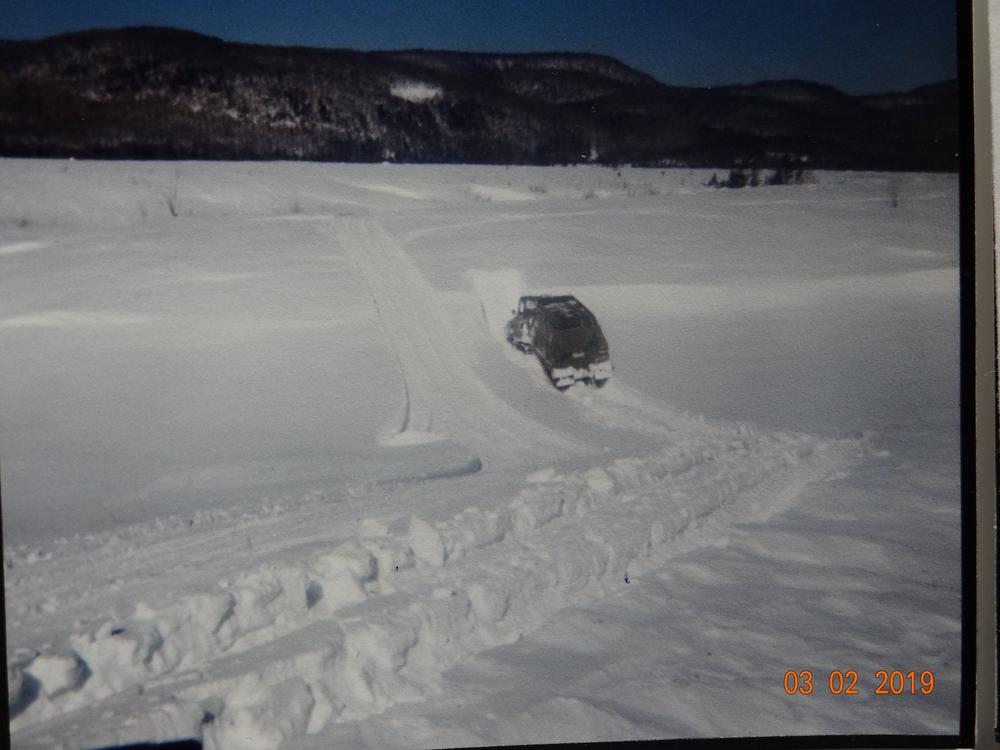

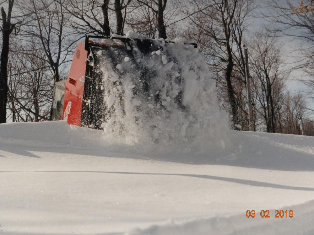

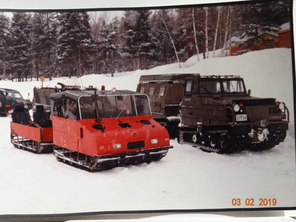

I know it is at the end of the rainbow but if you are looking for traction ( flotability) and steering : EMOND 6X6
Traction: full track " no tunnel"
Steering: articulated vehicle
