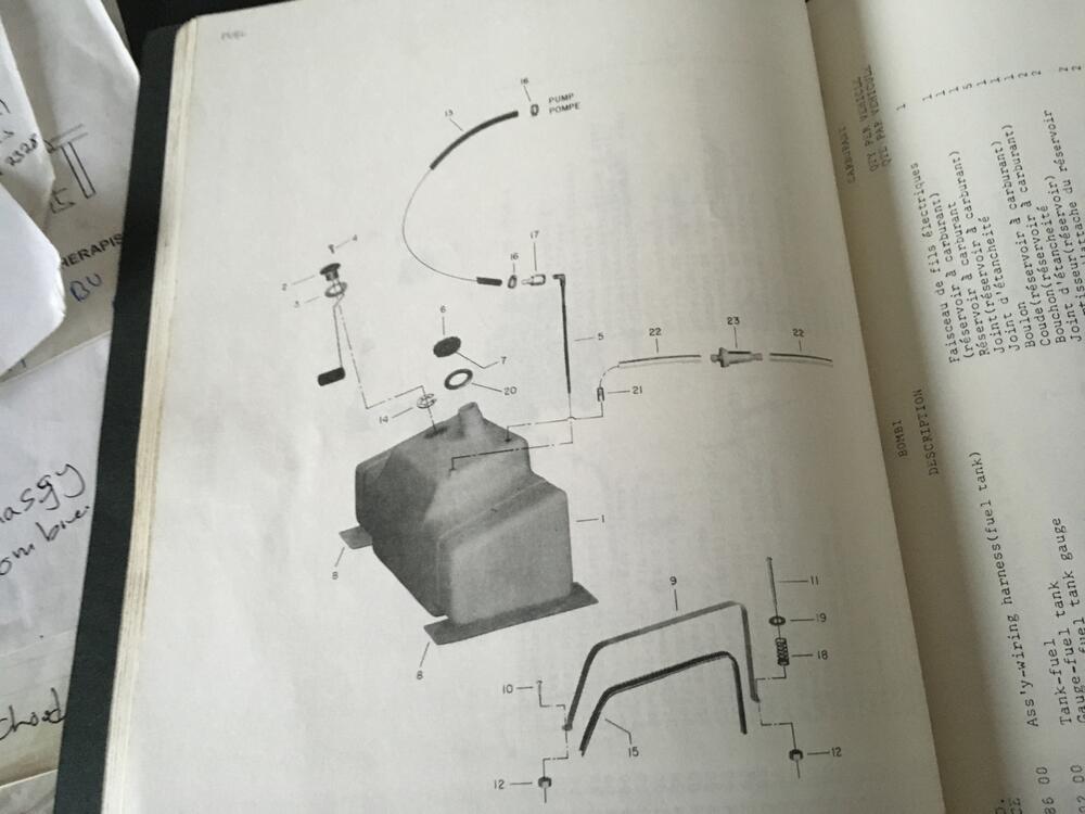

Hi Natey
This is a picture of my Bombi’s front with the nose removed....tank in front.
[/IMG]
[/IMG]
Bob
Sounds good, I have thought about converting my steel hydraulic tank that sits in the back next to the motor into a fuel tank, it pretty much looks like the fuel cell in your link.I don't think I will be using hydraulics on the machine anyways. But would be nice to have a orginal one up front also.
I think that steel hydraulic fluid tank is maybe 2 gallons. Reach out to MN outdoors.....I know he’s got one tank if not already sold.
Bob
Ok I will get ahold of him. I do believe my hydraulic tank is at least 5 gallons looks fairly new, if nothing else would make a good reserve tank. I don't have a plow or anything so not much use to me.

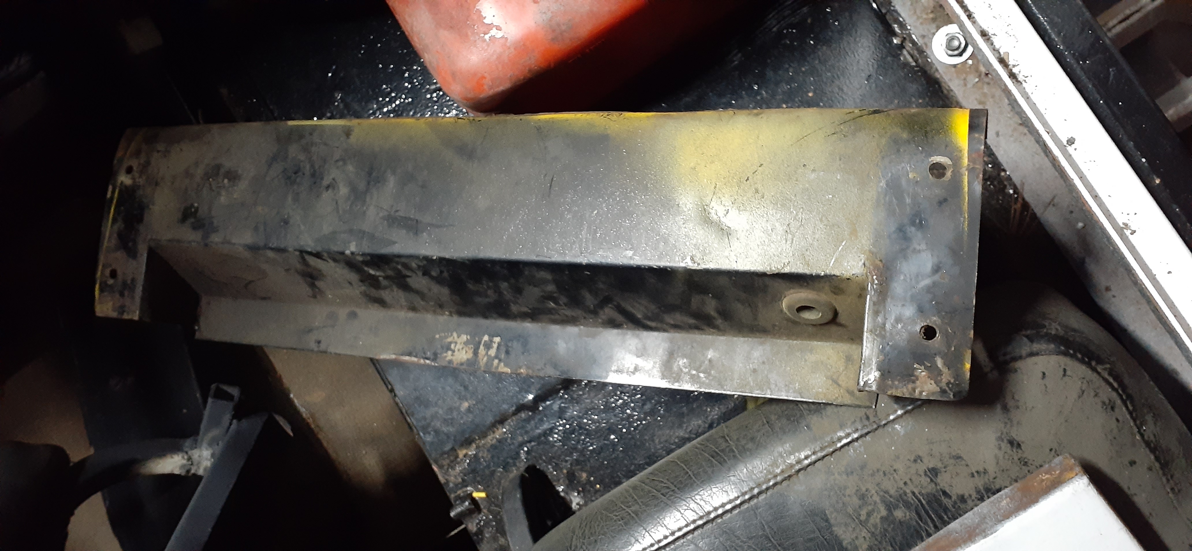

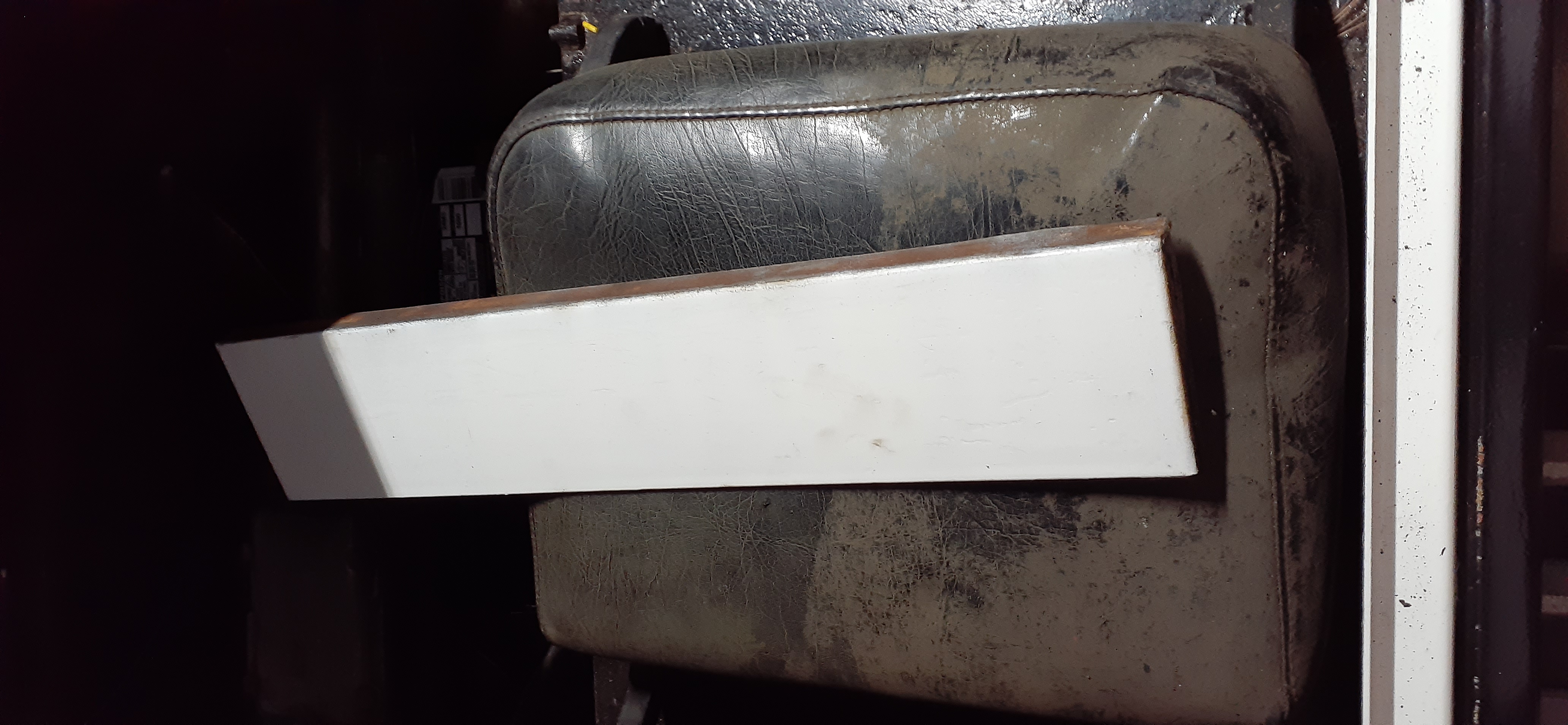

Does anyone happen to have some pictures of the tin work that goes behind the driver seat in between the motor and cab. I have a couple pieces one I am certain fits in good and bolts up but leaves a big gap still. The other piece I have looks like it is suppose to go to the machine but not really sure how doesnt seem to find to good in any direction.
Thanks, nate

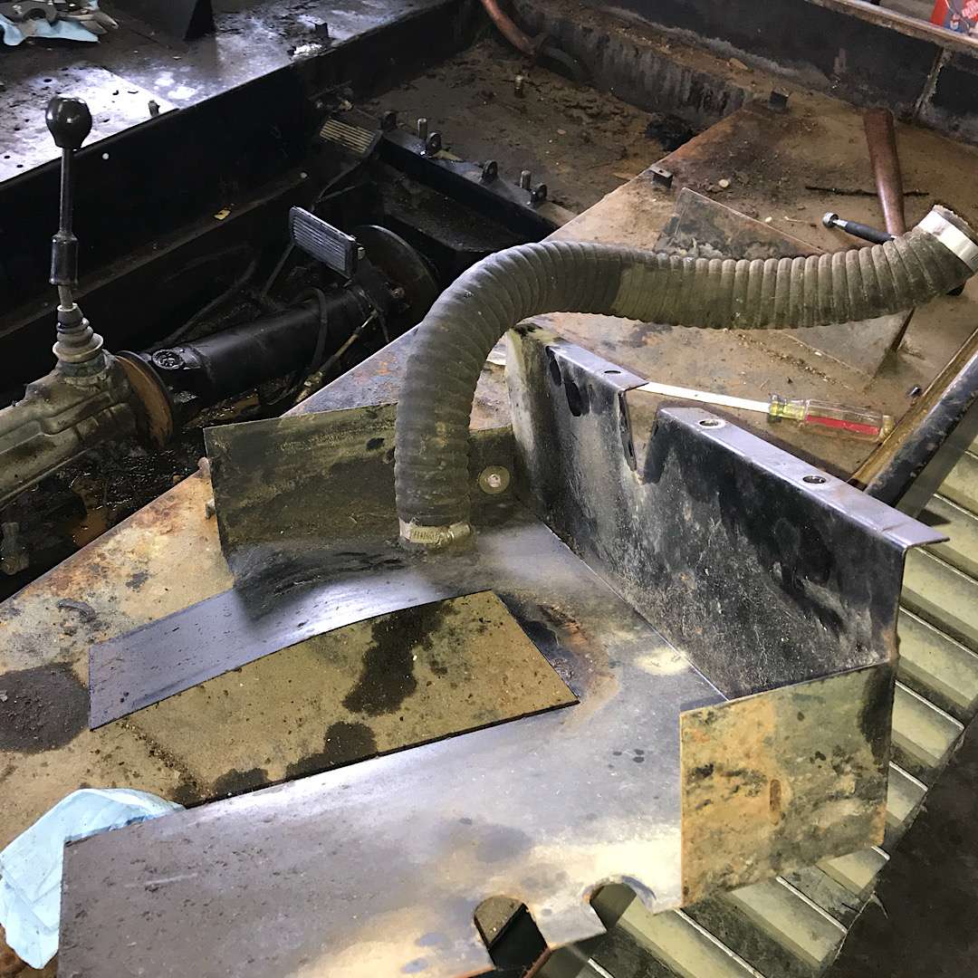

Here’s a couple pics behind the seat in the Bombi

Great!!! Thanks for those that cleared up my confusion on what pieces went where on the machine. I was starting to wonder where that big piece went haha. I'm guessing that hole is suppose to be for engine intake to suck air from the cab?? Seems strange.
It is. I’ve read threads where folks line the cab with pink styrofoam board to keep it warm....because the engine intake is from cab air, lots of outside airflow. It seems weird, but when you look where the exhaust manifold points to.....its down into the frame/tub. I assumed the engineers thought “hey, if there is a manifold/ exhaust leak, won’t this cause a carbon monoxide issue?”......so they create a positive airflow into the cab by pulling intake air from inside the cab. That’s my best guess. The only other reason (which might be more plausible)......keep the air filter from freezing over (I’ve had this happen on our John Deere when snow blowing).
Bob
Oh ok that makes a little more sense now, not to sure how well my heater will keep up with the intake setup like that but will find out I guess. I have been trying to find some sort of fire resistant noise insulation for the inside anyways, not to sure pink insulation would look to good lol.
