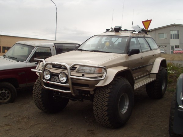

BIG awd Subaru Legacy in Iceland

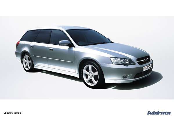

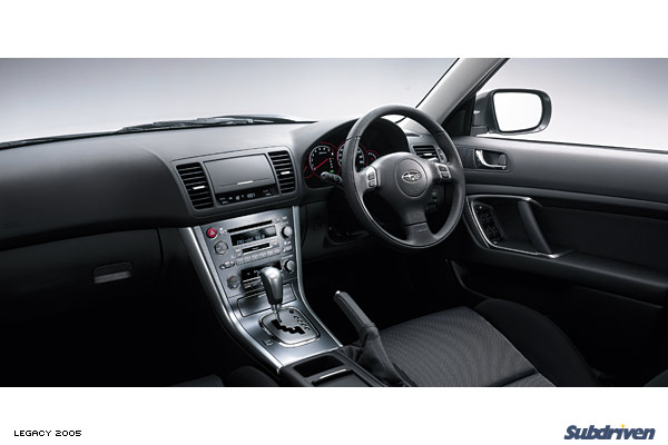

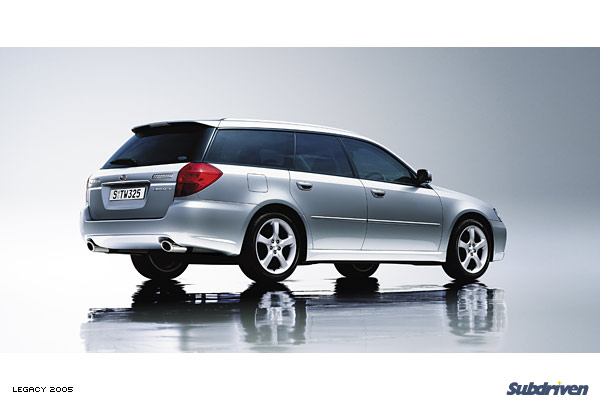

Not sure how popular they are in other regions of the country but in the Pacific Northwest they are VERY popular. They are everywhere, more so then any other AWD vehicle that I have seen. They kind of go hand in hand with the sandal community, I guess. Cost was around $22,500 MSRP for the wagon, $21500 MSPR for the sedan. Interior quality has changed dramatically from the past generation; now competing with Audi, BMW, and Volvo. I had an Audi A6 Wagon for 3 months in Germany and a Volvo V40 Wagon for 2 months in Sweden. This car's interior quality reminds me more of the Volvo but a little closer in size to the A6. Handling and ride is very neutral similiar to the A6. Safety closer to the Volvo. Front, side and curtain airbags are standard (8 bags total). 5 star safety rating. The perfect car for my wife who drives alot with the kids. We bought the car new in Sept of 2004 and she managed to put 38,000 miles on it already. No problems what so ever.
Check them out if you are looking for an AWD vehicle. They are very nice for the money and have great milage. 2006 changed a little, they now have 17" wheels standard. Mine has 16" which I perfer because I live off of a gravel county road. Consumer reports has recently rated Suburu as the most reliable brand (argueably I am sure), edging out Toyota and Honda.
photos of standard base model attached.
http://www.subaru.com/shop/model_consideration.jsp?model=LEGACY
