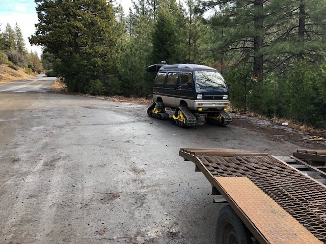

Problem with putting tracks on the Outback is its weight. The tracks you would need for it would be expensive.
You could sell off the components easier, OC12, grausers, your new engine, trans etc. would likely get what you need, especially if you can get 3k or so for the Outback.
In the tracked 4X4 section Is the Build on the van and a Truck that I did first. The truck burned up in a forest fire last year. The truck I had in at least 5' of snow. on steep terrain. An added benefit is in the summer 27" utv tires and wheels will bolt right on for summer exploring. With the wheels, they get upwards of 35-45 mpg.
They are very tuff little units with real axels with differentials, real transfer case with 2x and 4x low and hi with lockers. No chains and belts like Polaris etc. Very roomy feel inside. I have a Nissan frontier and the feel is nearly the same inside. The van has rear seats with a cargo area or the seats fold up and there is a very large cargo area that you could sleep in if necessary. Most have around 25,000 to 40,000 miles on them and will go well over 100,000. there is a lot of youtube on both just the trucks and vans as well as tracked ones with lots of video. How I ended up with it is first I had a Thiokol 603 snow cat I used for a while, problem with it was 1- it weighed 5000# 2- got gallons to the mile 3- was extremely hot inside even with the doors open and snow on the ground 4- it was a bitch to steer on tight roads with switchbacks and the wife couldn't drive it in an emergency. So I sold it on this sight and bought a Tucker 442, thinking it was liter to haul, steered like a truck and the wife could drive it.

When the $4100 for the tracks number was mentioned I was curious....The little ATV stuff yesss.

You want UTV tracks for the mini van and trucks, they are around $4000,00. Thats why I recommended selling the outback and buying a Japanese mini truck or van. They only weigh 1500# and the UTV tracks are good to 3500#. The P.S.I. on my van is .68, thats right there with many snow cats. I have seen UTV tracks on Suzuki samurai, and they Kinda work, as they are too heavy like the Outback. The tracks for that weight are $$$
