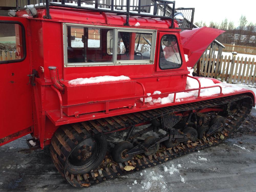

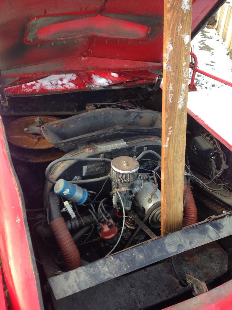

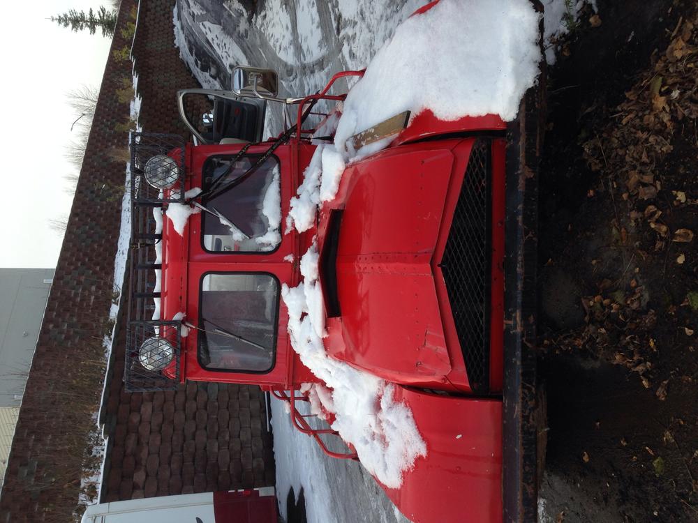

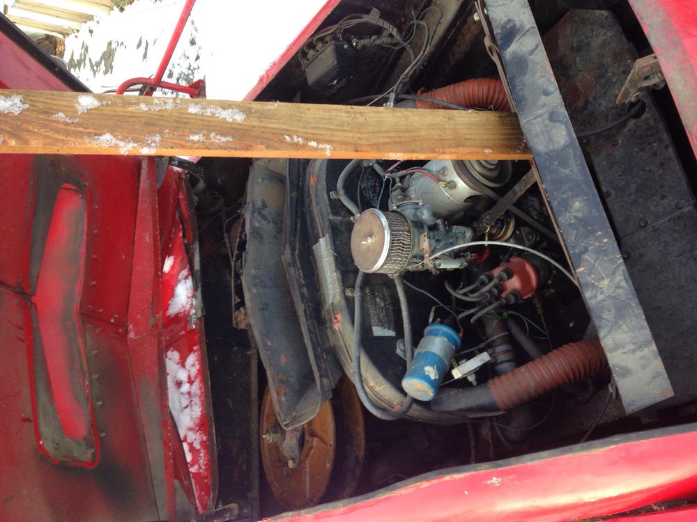

Hello all just purchased my second snow Trac. The machine was moved last winter and left in reverse gear. Owner fired it up and the machine stalls like it stuck In reverse and second ( it's common I guess) tried pulling transmission fill plug and prying back on the second gear synchro gear ( recommened if this happens) no luck freeing tranny. There was no gear oil that I could see. Any way with clutch in machine starts and runs great. Ok the problem is the tracks will not spin even with clutch in when trying to winch on trailer. Could not find master link on drive chain to remove them to determine if the brakes were froze. With clutch in the tracks should spin free right? Ran out of time and icy driveway happened the extraction till it melts. Could the varator have issues or is it not engaged when the clutch is pressed? Thanks all. Oh pics

Side view first pic is of odd looking upper wheel holder

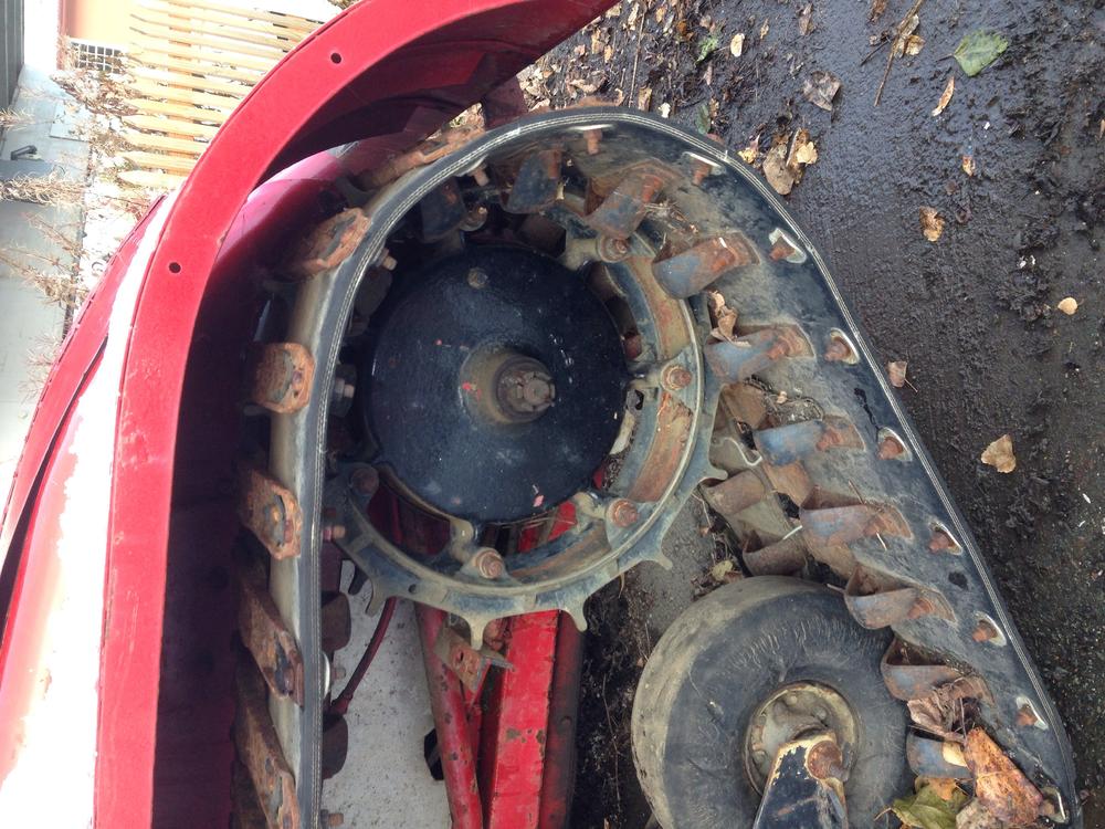

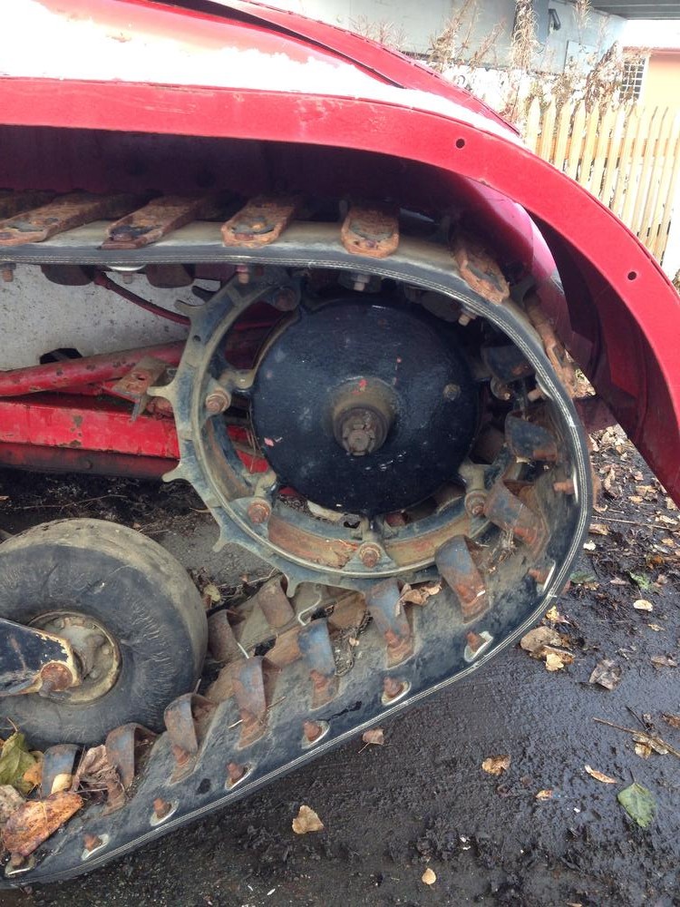

Looks like it was setup for sprocket ice scrapers. Sorry for the tilted pics.

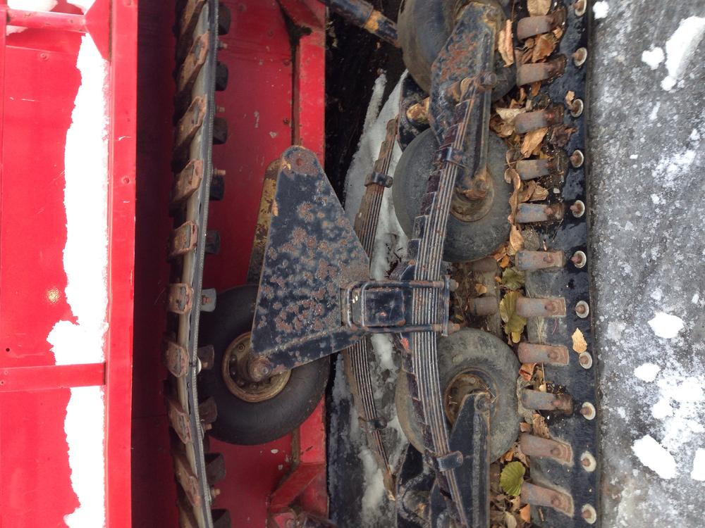

Ok I think if the tranny is stuck in two gears it prevents any movement of the drive train even when the clutch is engaged.
Cool, I see the bogies have the angle iron welded to the bottom. I add that to mine when I go to assemble mine
Nice ST4

hey dude can you get me some better pics of the fan intake scoop that looks like a dog house style fan tower . I'm getting ready to build a big bore dual port and plan on using a doghouse style oil cooler.
Very nice, congratulations! those drive sprockets look thin enough to pick your teeth with ;) very impressive to see that sort of length on the teeth.... normally they look like little pyramids because the track tension has been slack... your tracks look to be in great shape.

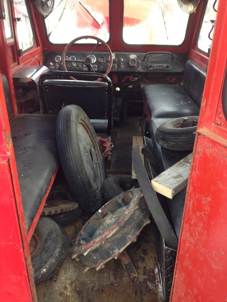

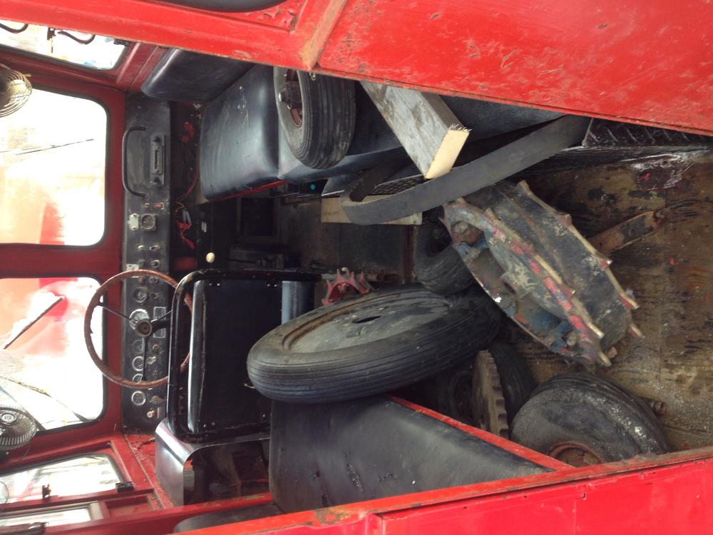

Nice stash of parts it came with. It looks like you're set up for two carrier bogies. Looks nice and stout and good overall machine.
The bolts are pretty rusted and don't want to remove tracks in the guys driveway.The tires are pretty flat and some have rotted pretty bad and won't hold are. That being said I'm afraid to destroy the rims. I figured master links are cheap. for the parts it came with new drive sprockets and five small tires, various variator parts (a lot of them), new front suspension spring, 3 drive shafts, one large tire with rim :wow:, 10 grousers, small tubes, and some other miscellaneous parts. I'm pretty exited about the possibilities. :smile:
