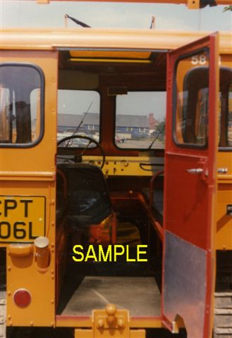

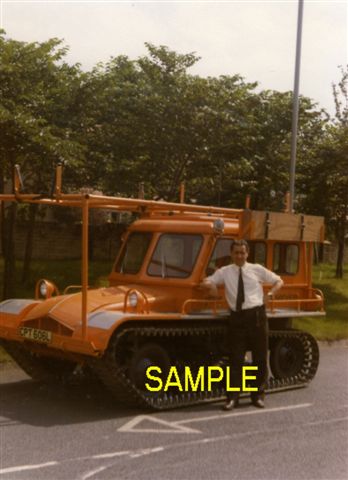

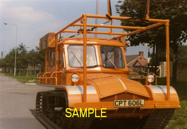

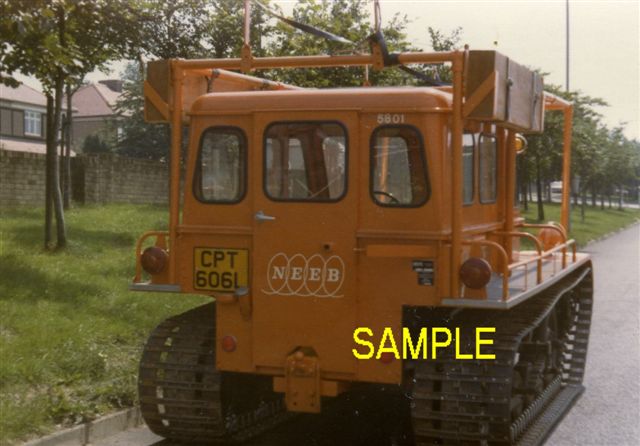

Registration number CPT 606L:- This vehicle is a ST4 circa 1972. I did not work for NEEB then. This was the first ST bought and the brainchild of the guy in one of the pictures, Ray Eland who was a regional Fleet Engineer. The vehicle was based at Penshaw depot near Sunderland, Tyne & Wear. I cannot understand why a vehicle like this was bought for this area as there aren't many remote and hard to reach parts. I think it was a case of big boy toys. Anyway, to justify it's existance and to satisfy Health & Safety requirements a 'roll over cage' and pole/ladder carrier was fabricated from scaffolding tubes. These I, was later told were reclaimed/secondhand tubes to keep the cost down. I was also told that because no fitter/mechanic at Penshaw depot could electric stick weld to any degree of competency, this was the easier option as all the sections are bolted together. The only other comment I can make about the the vehicle is the back door and how the bottom has been cut to accomodate the high tow hitch. Obviously the Health & Safety man must have overlooked this and I can imagine how many Linesmen would have skinned their legs or even worse on this. I don't know what happened to this vehicle but I can bet my boots it is still around somewhere.

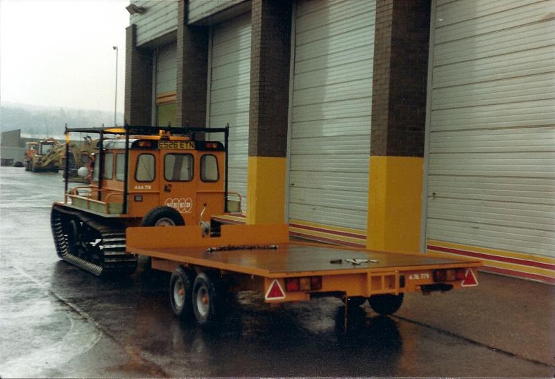

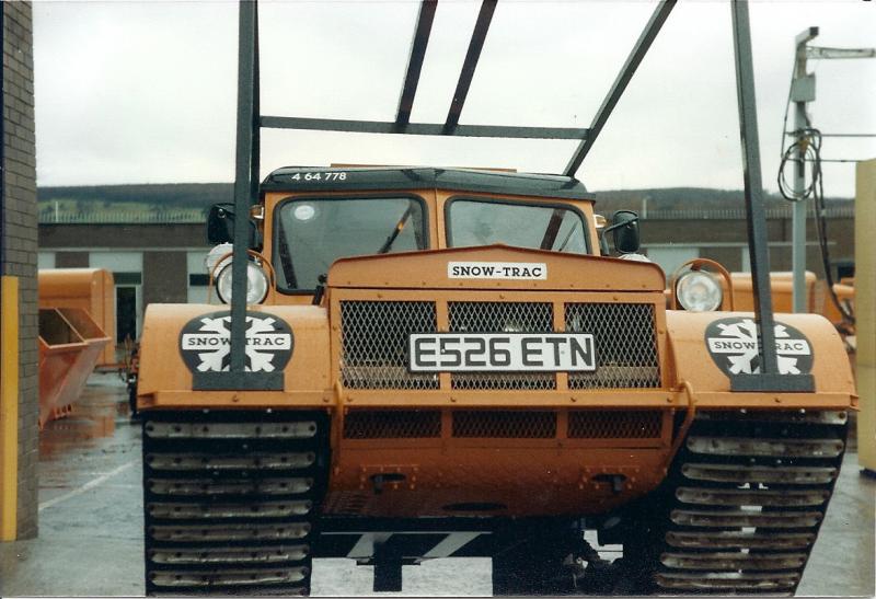

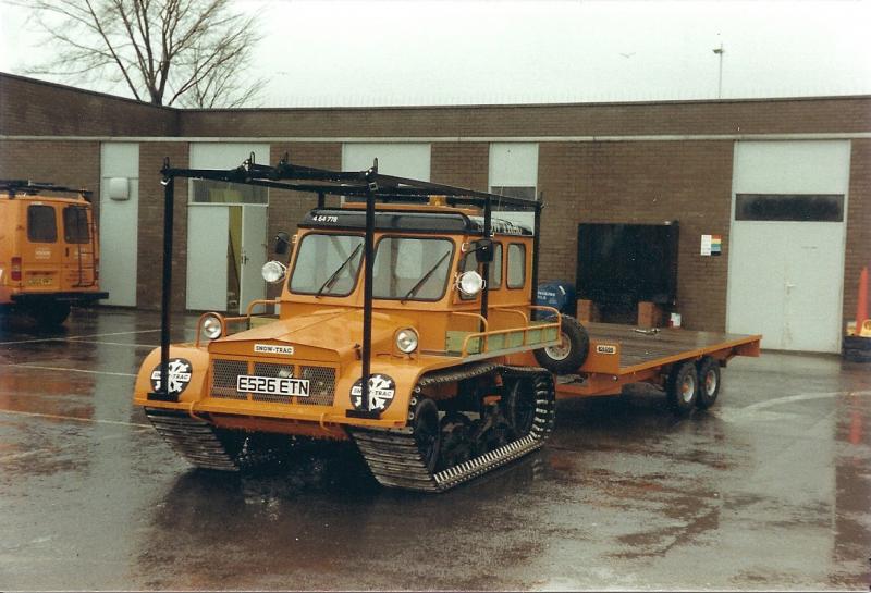

E526 ETN:- This ST replaced a vehicle similar to one just mentioned which was used in another operating area which included Northumberland. This area does have a large Overhead Supply network to maintain especially in the winter and this vehicle was based at Hexham. I was a humble fitter then who had started work for NEEB in 1978, so this was ten years on. I got the job of commissioning this ST and two others for other regions because among other aspects, I could electric weld. My supervisor and I decided that I would make a rollcage ladder rack come pole rack out of square hollow section mild steel. He ordered it and I fabricated it. It was a lot lighter and slightly less intrusive as the scaffolding poles and a lot cheaper. The areas on the ST where the rack was bolted had to be reinforced but this did not prove difficult. The idea was to carry a lightweight, undressed OH pole on the rack and on other ocassions heavy wood ladders. The use of Aluminium ladders was not allowed for obvious reasons. Also the trailer would be used to to carry the metalwork for the pole to the location of the job. As you can see from the photos that wood has been used to box in the tops of wings/running boards to allow the Linesman to carry conductors, bolts etc.
The set of photos were taken as you can see when the ST was brand new and as luck would have it, I had my camera with me that day. One of the photos shows a rear shot with the Lolode trailer coupled up and you can see the second axle wheels are clear of the ground. This was deemed to be unimportant as this would be how the ST and trailer would be used in the field. When the trailer was coupled up to the towing vehicle, a Bedford 4x4 lorry or another similar vehicle, both axles would be flat on the road. I tackled the problem of the tow hitch height on the ST, there would be no danger of the tow hitch getting in the way and causing mishap to the linesman. This was done by fabricating a piece of rubber mudflap in the shape of a filled in U, bolting it to the rear section so it rested on top of the hitch and rivetting a short length of tread strip on top for a boot grip. In the early days of towing a ST to a job, a Land Rover would be used because it worked out legal on the Gross Train Weight however in reality this was far too dangerous in practice as some of the earlier trailers did not have brakes. This ST would prove to have a hard life, it was hit by a farmers tractor which damaged the side and roof. There were other incidents by I cannot remember exactly the circumstances. The bodyshop would repair the vehicle in a situation of a third party involvement but other damage caused by a hapless linesman we at the workshop would carry out the repair and charge the OH section.

The photos of the modified front end Snow Trac are interesting. (E526 ETN) I've seen a couple that had custom engine bays, but only after the owners did an engine swap to put in a water cooled engine. I think member Roughwoods has a Toyota powered unit with a modified front end similar to that, if I recall correctly. But that one looks like it was designed better than the ones I've seen, do you know anything more about it? Did it come that way? Why? Etc?

Here are some better pictures of E526 ETN..... PM me and I will send you his email address....... all I have is what I posted but it is because I got busy and didnt follow up with him....... the pictures I have I purchased from him in May of 2008 I believe
