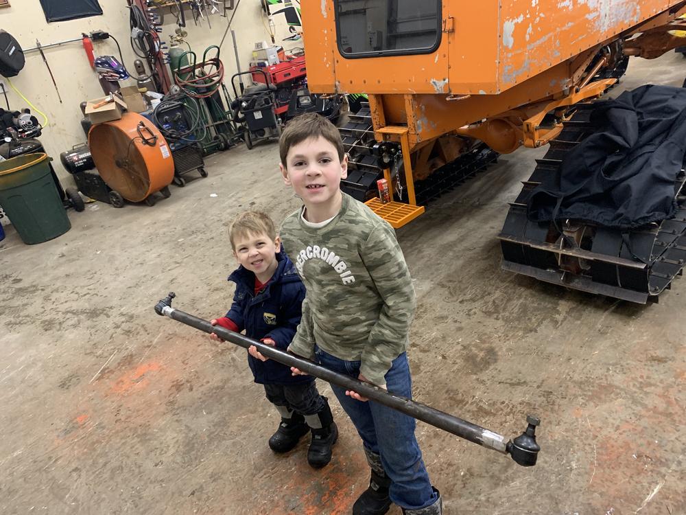

Little welding grinding class for the kids today.

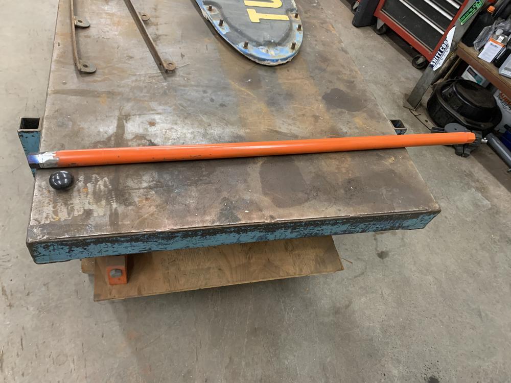

New improved tie rod for final fit and paint. Will be installed with only one end locked per Sno Drifter.
Question will be if we need to remove any material to clear the transfer case?
Hopefully no.
