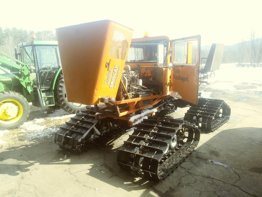

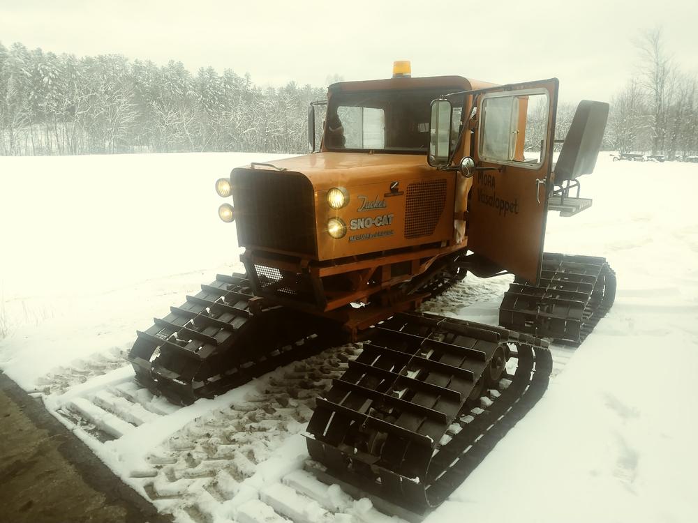

1542 conversion to a 1543 supersized project
…… thanks S/R,.. much appreciated. all good points to ponder. as you know, when you weld cracks, add pieces, etc. the metal around the welds become more brittle,... so like you said, you keep chasing them. drilling a hole at the end of a crack , before rewelding sometimes help. these tucker frames , 2''X2'' square tubing, is thin walled . so sometimes drilling holes, leads to a cracking. it's a catch 22 scenario. damned if you , damned if you don't. like your trailer, trial & error. unfortunately in error is more common,.... thx for the input,.... :thumbup:
…. adding some temporary bus seats ( seat belt style) , grab handles, guardrails, steps ,etc. for a couple upcoming events. then will be removed to continue the project,....

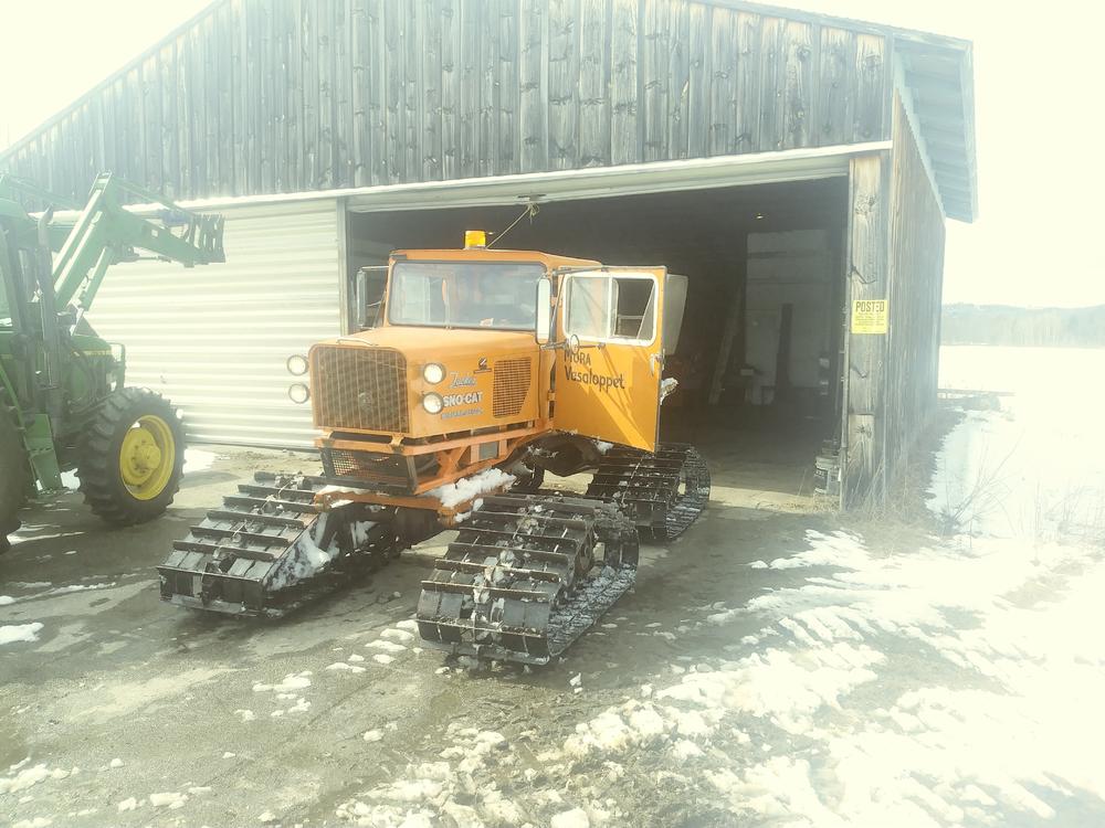

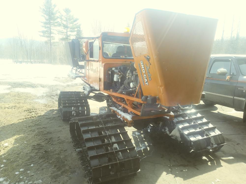

………. LOL , that's a good one D/N ,... floor is all in and allset. had a buddy show up today , and offered to lend a hand , Big Sam . he probably saved the project from making it at all . he did some welding , helped with the doors, hood , ...5 hrs. later. so there seems to be a light at the end of a very long tunnel... :smile:...… he's going to bring some old skidoo's down to show … belonged to his dad brand new …. he might sell one , you never know. but many thanks to him.... will you be bringing yours ….:thumbup:
………. And ''... here's the rest of the story'' ,...…… so Sat. a.m.. (5am) … (-12 below) , trying to put the finishing touches ,... or safety factors, trip worthy , etc.... replaced r/f sprockets, ''fabed '' up hand throttle cable assy., adjusted doors ( not sure how they shrunk , from cab removal/install) , and a ton of other things I can't remember,... finally got loaded at noon,.... attempted to leave ''Tucker Lake '' ,... buried the truck/trailer a 100 ft. from main rd. ugghh. walked back to shed for the JD6310, which won't start below 40 degrees. finally starts, hooked on, ( wifey at the helm of the 'ol Burb) , …. and we drag the train to the asphalt. back to shed to park & close up again. and , ….. off to the show in Thorton . gave rides & interviews non-stop for hrs.... well worth the ''killing myself to make the show'' ,.... bday dinner with the gang,... short nite's sleep , and off again. can't wait till next year....LOL. hopefully be more prepared. wait,... I started in April,...…

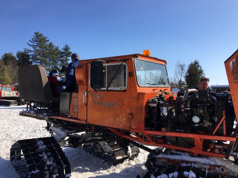

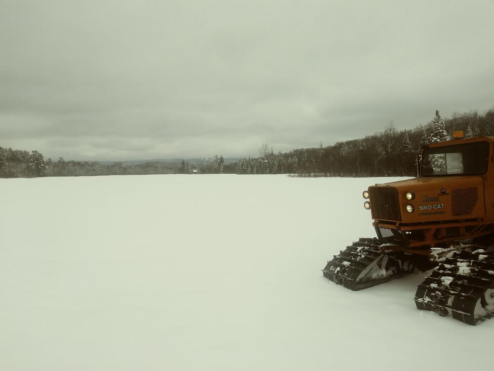

…….. So , all that being said,..... and all the weekends activities,... ( the best weekend of the year, in these parts, to be a snocat owner/enthusiast) …….. operated Sat. , and Sunday's 12 mile parade,.. back at Tucker Lake for another hour to let the gang drive around & play ( sunday afternoon),.... and today for another hour of testing , ……. and up to the height of the land , ( for the first time this winter) ,... man, we need more snow ,... before the early spring...…. checked the fuel tank ,and...……….. only used a few inches. the marker stick ( was just below my thumb) …. pretty happy with the 'ol '' hummins cummins''...…….:thumbup:

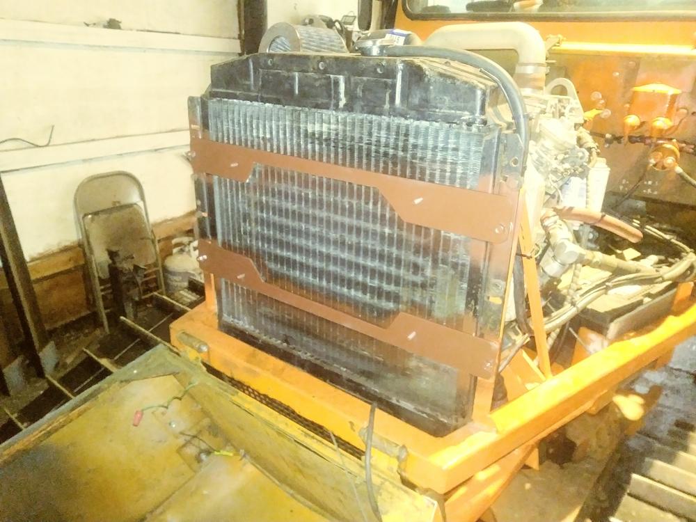

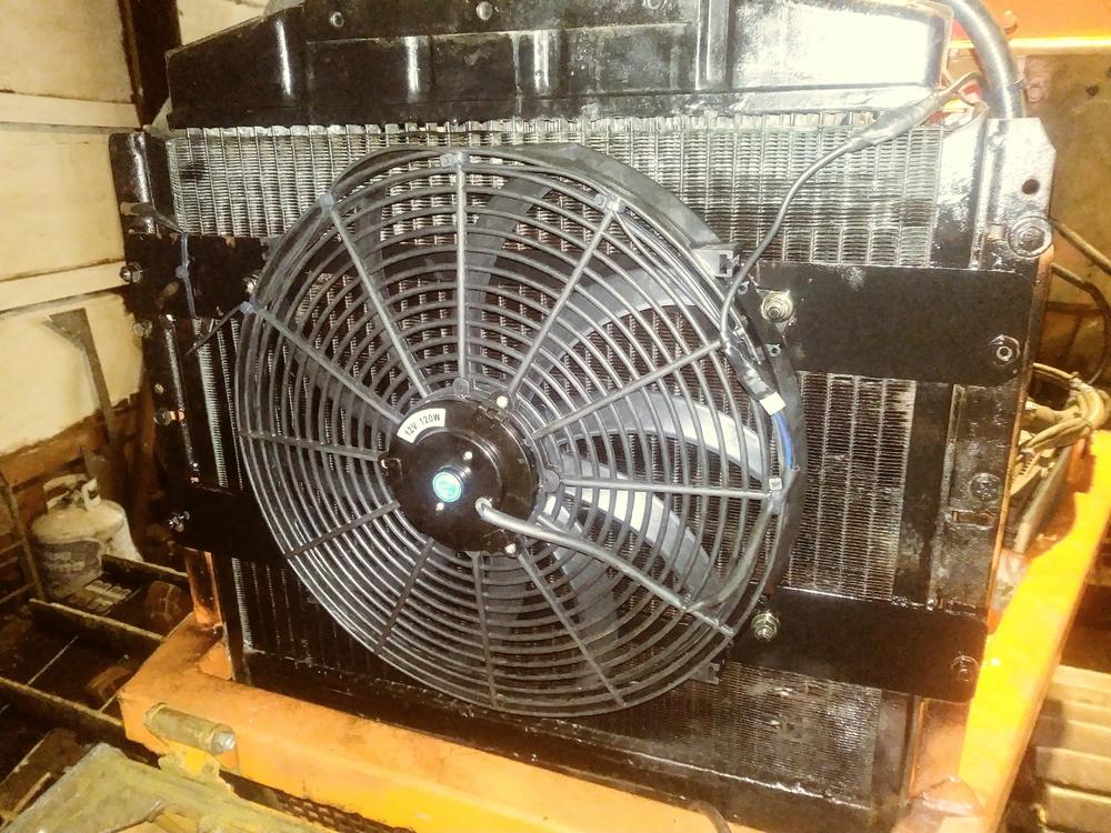

…………. , back onto the list of things I ran out of time to do before the Big show,,... starting with a better mounting system for the elec. fan,... and also for the future shroud to mount to,...…

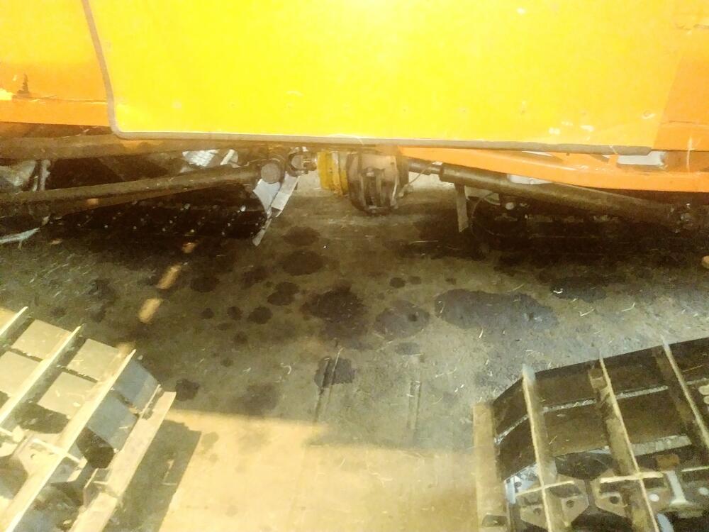

…….. .. walking by the 1542 ,... a quick glance under unit,... noticed no new blood spots on the floor, just the old ones from the past,....
