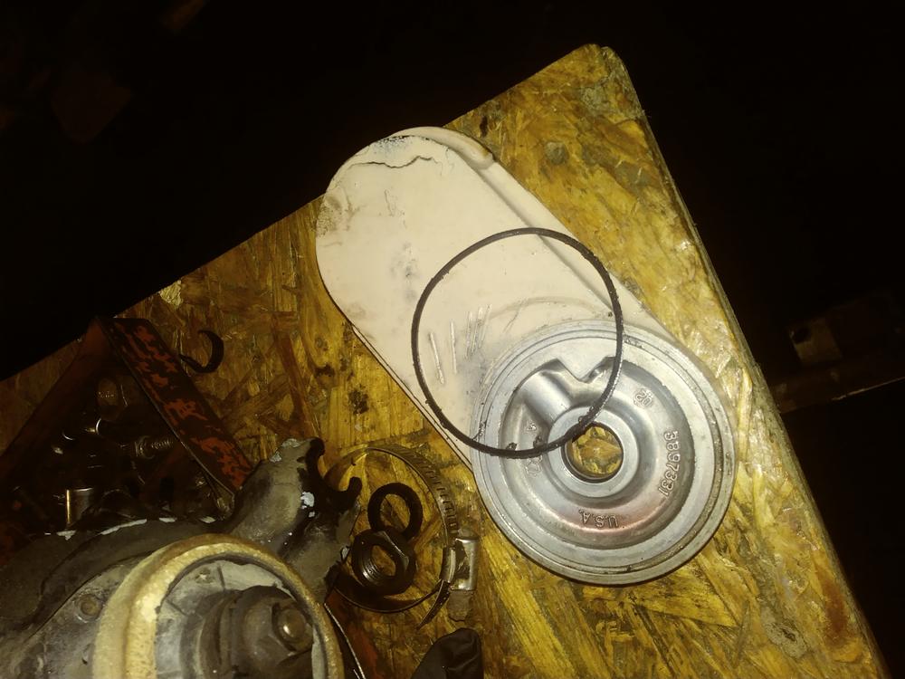

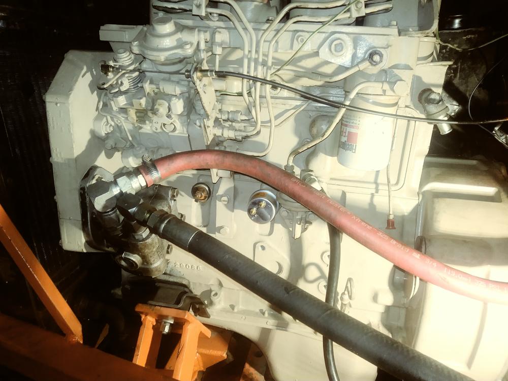

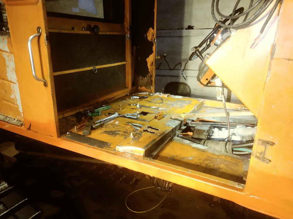

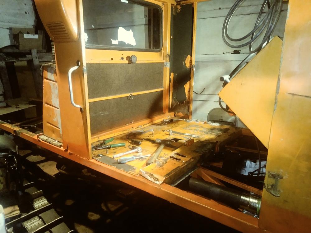

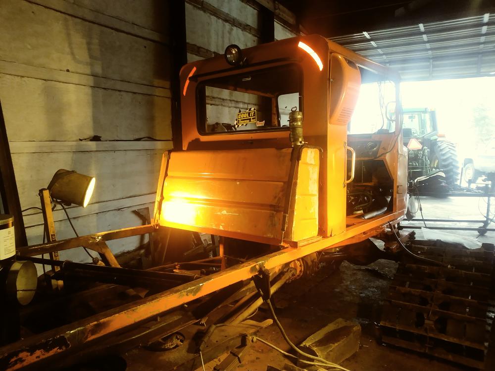

…………. finished the ''temp.'' fuel tank perch,.. lines, fittings, etc.,... had a fuel housing weep ,... installed & connected misc., sending units. drained coolant ; to plumb up the cab , shut-offs , sending units, …. started routing wires/harness,.. … ever had a ''pipe wrench'' fitting , in a tight spot, … one trick you can do is to weld a nut , centerline, to use a socket. nothing wrong with saving your knuckles, time, patience.... especially when you're mocking up components,....

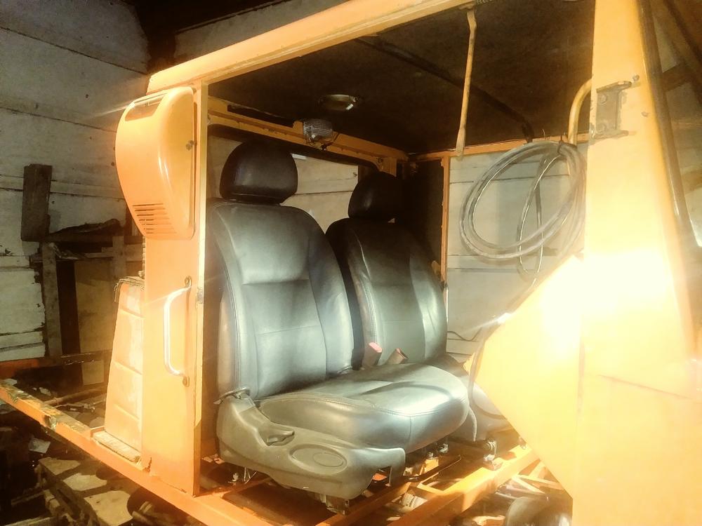

so a curiosity has been killing me about the box behind the passenger door on the side of the cab, whats that about?! cab ventilation?
……… hey ''N'' ,..... so, yes …. a cab ''vent'' fan assy. haven't really paid much attention to it,.. it wasn't working ,.. so not sure if it ''draws in '' or ''out'' …. it may work, wasn't hooked up. if I run out of projects,....lol … ive only seen a few with it ,... anyone know more...… thx ...:thumbup:

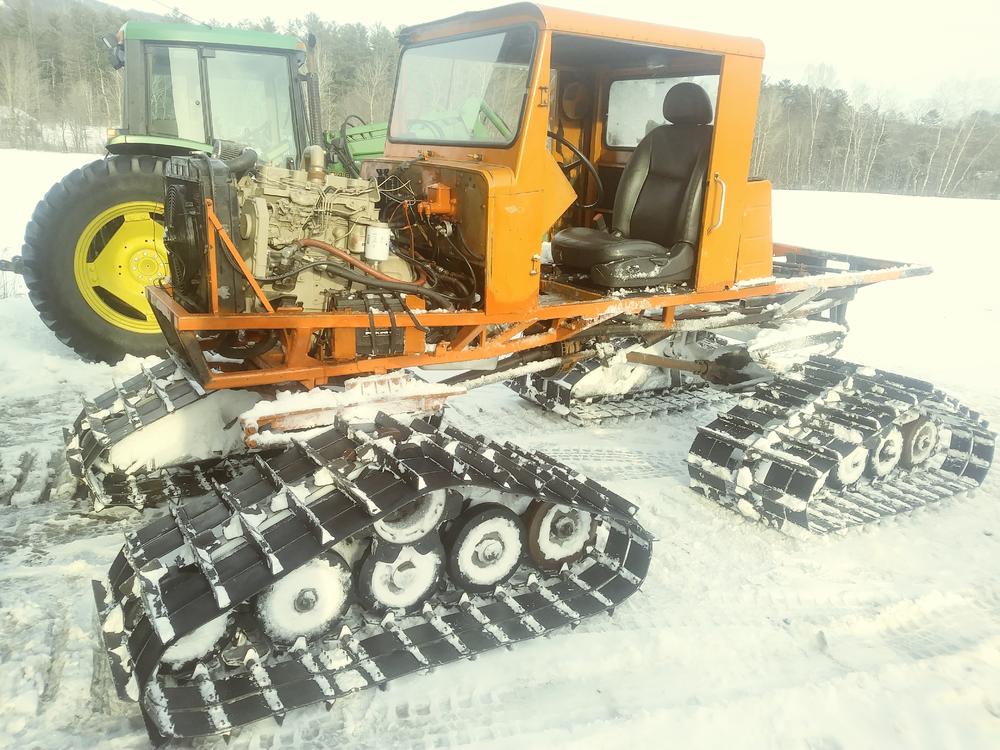

…. from the other day,... str:boxing:etching the tracks...

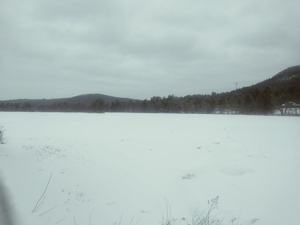

Looks like someone pulled the plug on your lake! Very much like here- bare.
…….. :laugh3::snow2_smi: yes, … just when we get a base,.. it rains. got a storm coming this weekend... fingers crossed. we're 8 inches below the norm this winter … not good for the water table,...:unsure:

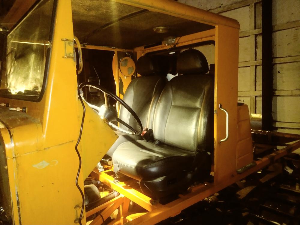

Bruce, you going to find a seat low enough so you fit in the cab??:laugh3:
……. hello Don, … LOL,.... well, the one that was in it ,... definitely going to rework the seat mounts …. was thinking about raising the roof,...seen a few with the lifted roof. wasn't planning on putting this cab back on,.. just didn't have enough time to re-cab. this summers project. hey?? … is this like ..'' the kettle & pot ''thing....HA HA … (i'm the little guy, don't forget)….. :thumbup:

……. ended up with 2'' of headroom.... may have to push the firewall out for legroom also,....lol

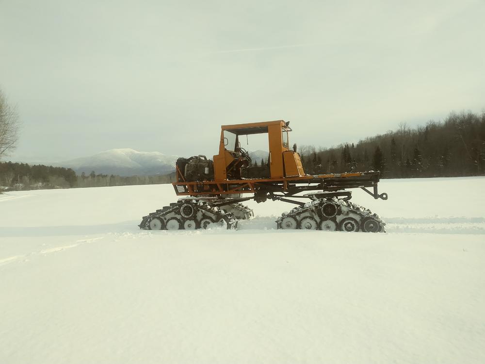

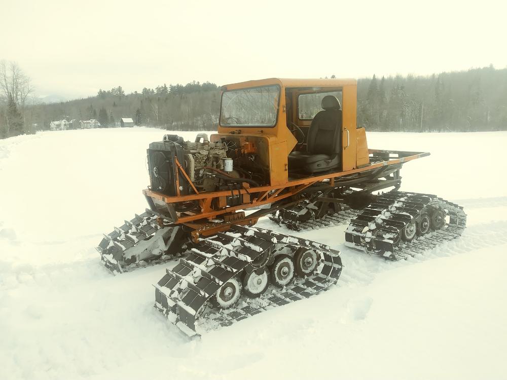

………… made the maiden voyage to the end of ''Tucker Lake '' ,... got a good foot down there ,... of a mixed base. 3-6'' possible for 2mrw. so anyone need a place to test their cat, or bring the kids, snowmobiles, sleds, tubing , got 50 acres to test on ….. T/A, D/N, etc. ,..... maybe a new venue,....

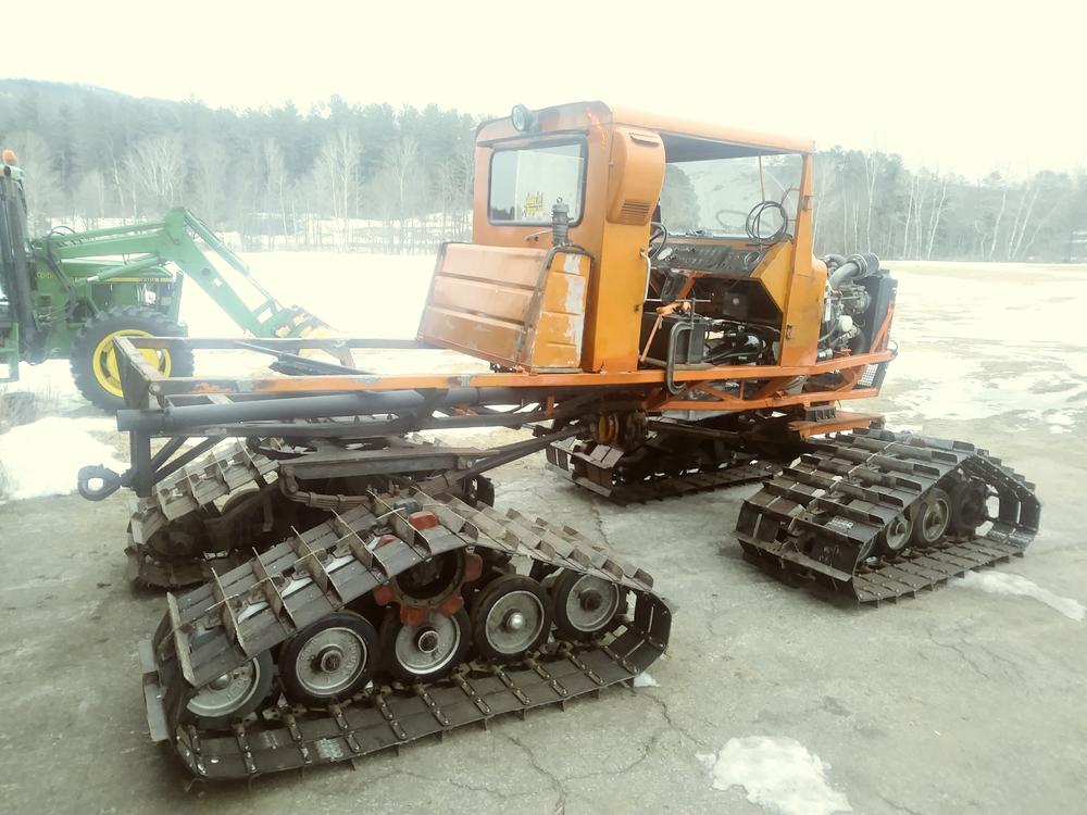

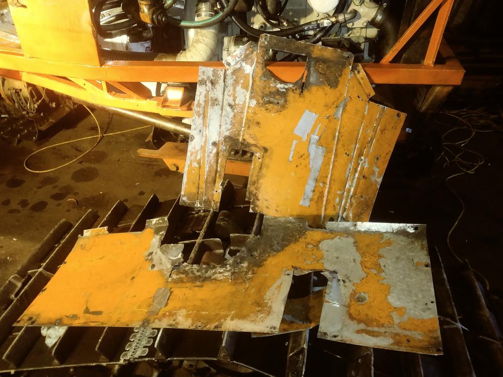

….. so , before the ''maiden'' test.... installed the old floorboards ( in an attempt to keep as much snow as possible from coming up thru the cab),... had to ''modify'' to fit the new adaptions in cab floor areas. considering the last conversion job ( manual to 727 swap @ ski mountain)…. I couldn't hurt them any worse. and , also due that the cab will be coming off again ( soon, considering the time of year & the way our winter is going so far ...uggh)...

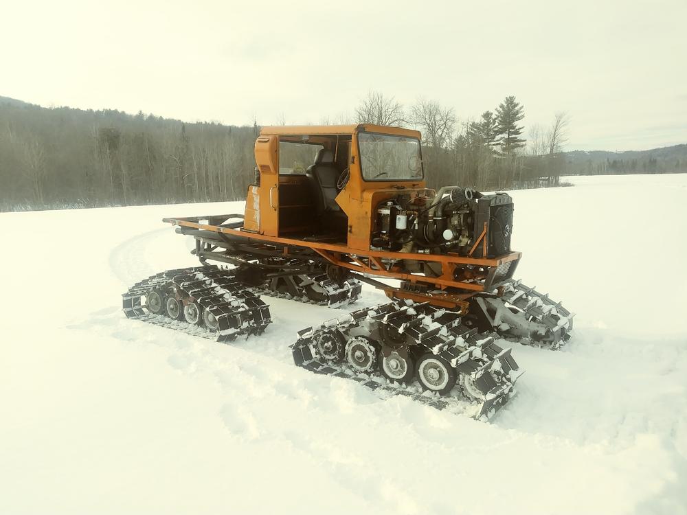

….. sunny day makes for snapshots....

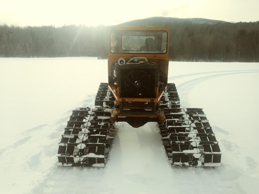

Hard to tell exactly from the pics, but did you use a muffler of some sort or just straight pipe out the back? How's it sound?
…. yes, the turbo is the muffler,.. 3'' drag pipes from the header elbow , thru the flexpipe ,... 10 ft. stick to the tail ,.... sounds like a ''hummin' Cummins '' up front ,... and a cross of a Model A & a Shovelhead ,.... out the shotgun,… :thumbup:
