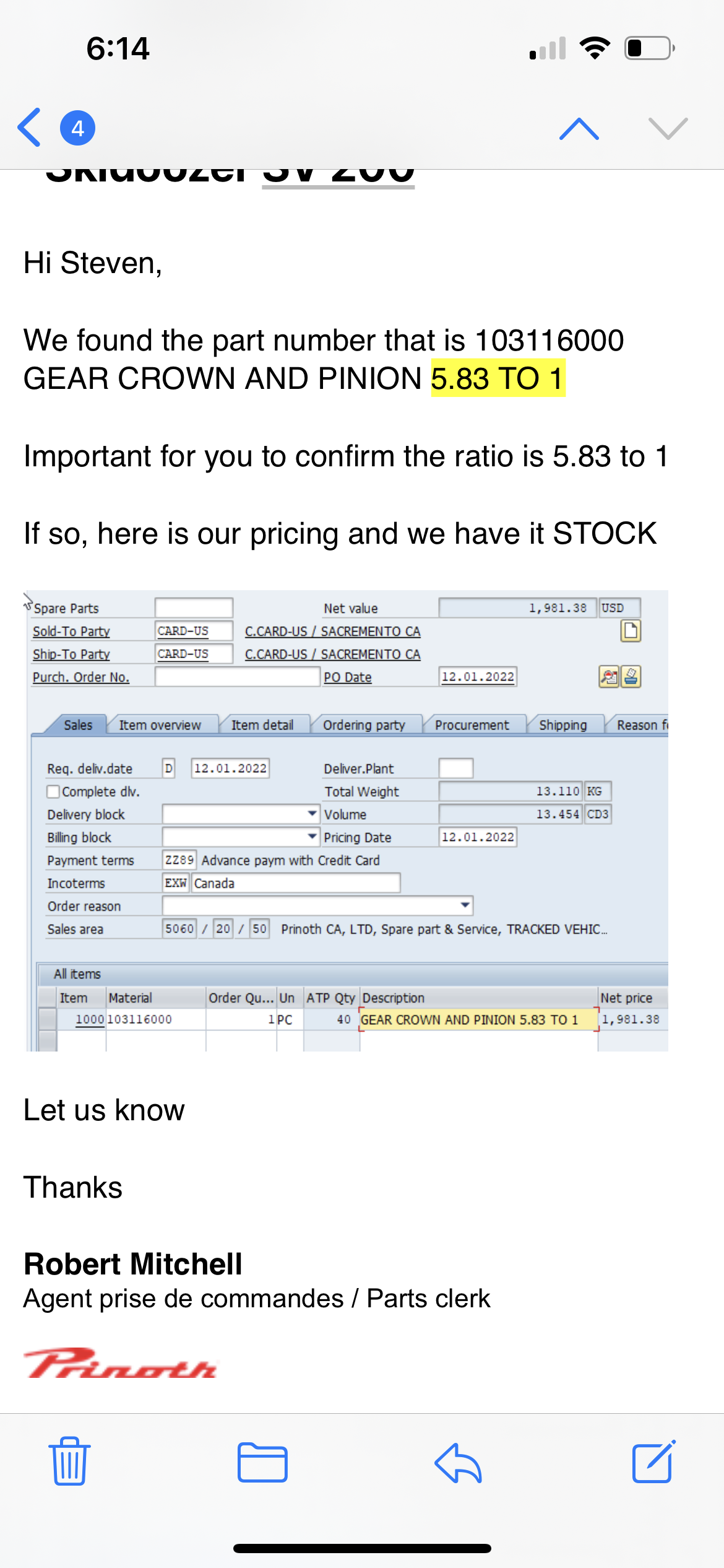

Yes, in US dollars
A new ring and pinion for my SV200 from Prinoth in Granby (Quebec) is currently US $2385. I have a local repair shop that is willing to do the work. But they have not done one before. We have the Bombardier instructions for complete disassembly of the differential (35 pages and calls for some special tools).
