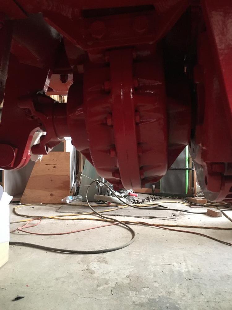

Any idea if model numbers having any correspondence to anything?
In the 1443 (door build sticker) which Tucker says is a 1543 and seems like it should be is t case 2830-2 if build sicker is correct. Bottom Pic.
On the 2000 is 2830-3, again according to door sticker. But... the sticker states Dana 70’s and it clearly has 80’s. Top Pic.
Both appear to be 2-1/2 inch gear sets. But neither look like pics above.
Here is the large transfer case in my 1981 542A-HD 453T/AT545 powered cat. You can’t see it here but it does have ‘743’ cast into the case. Build sheet lists ratio as 1.65 with 2 1/2” gears
