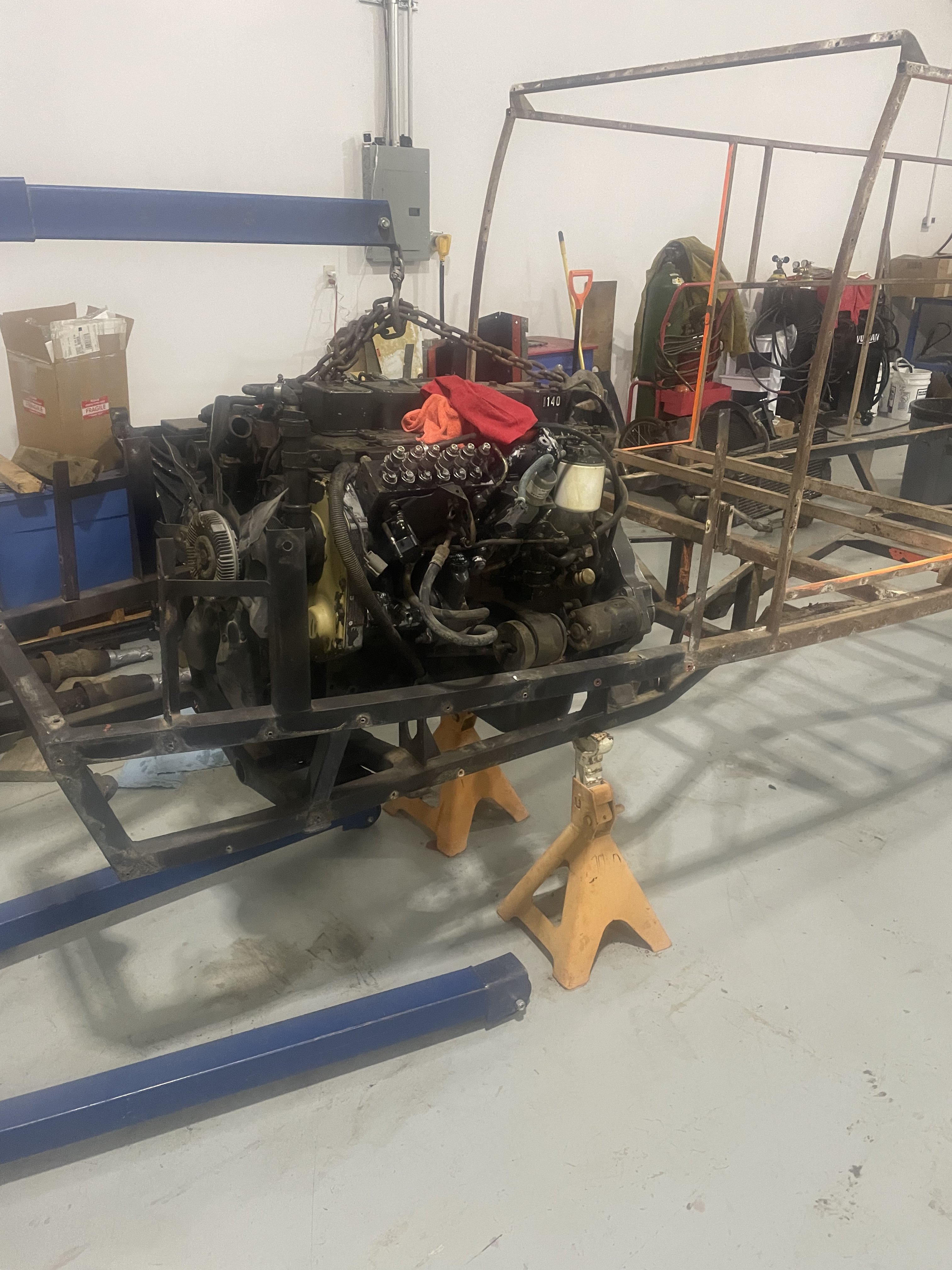

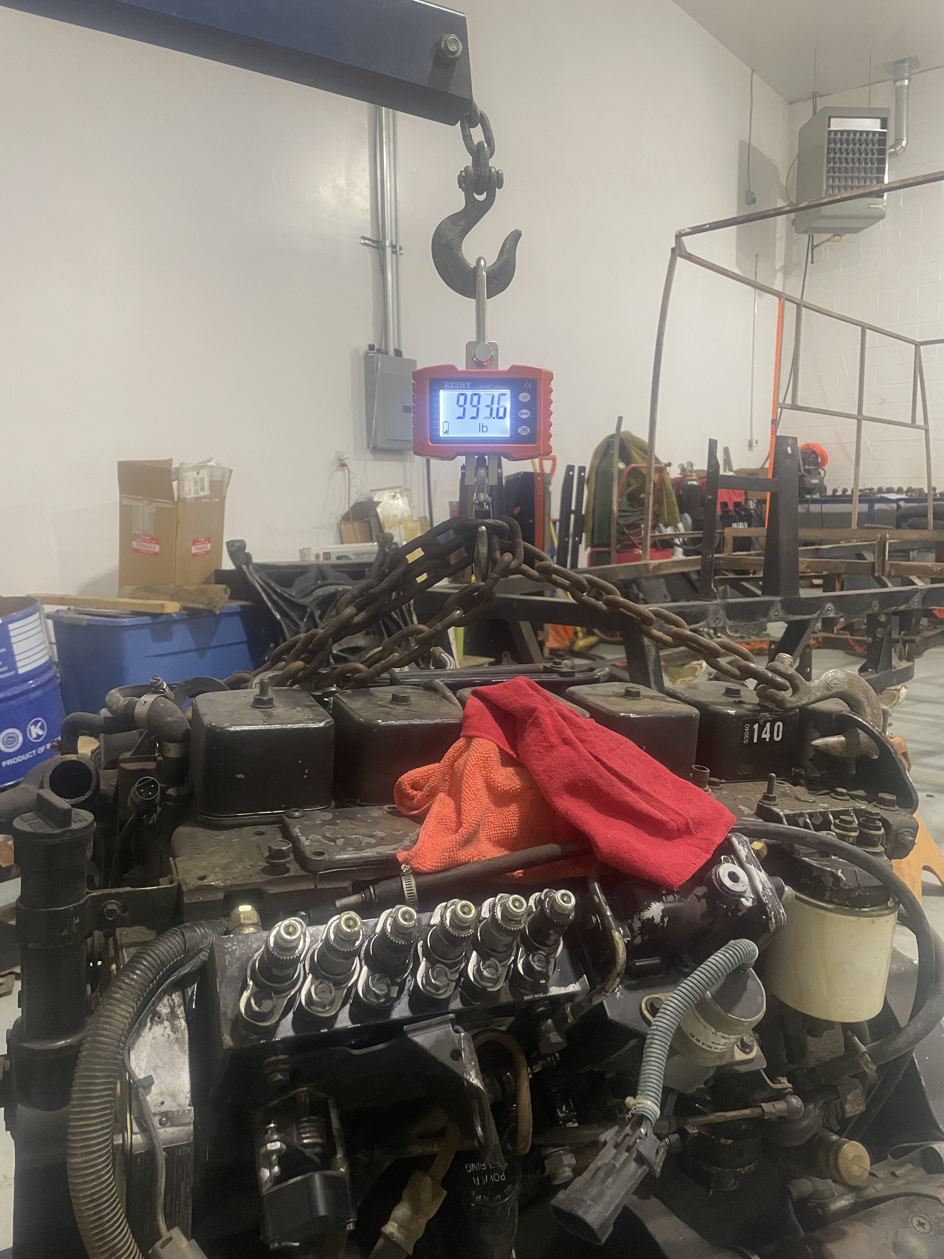

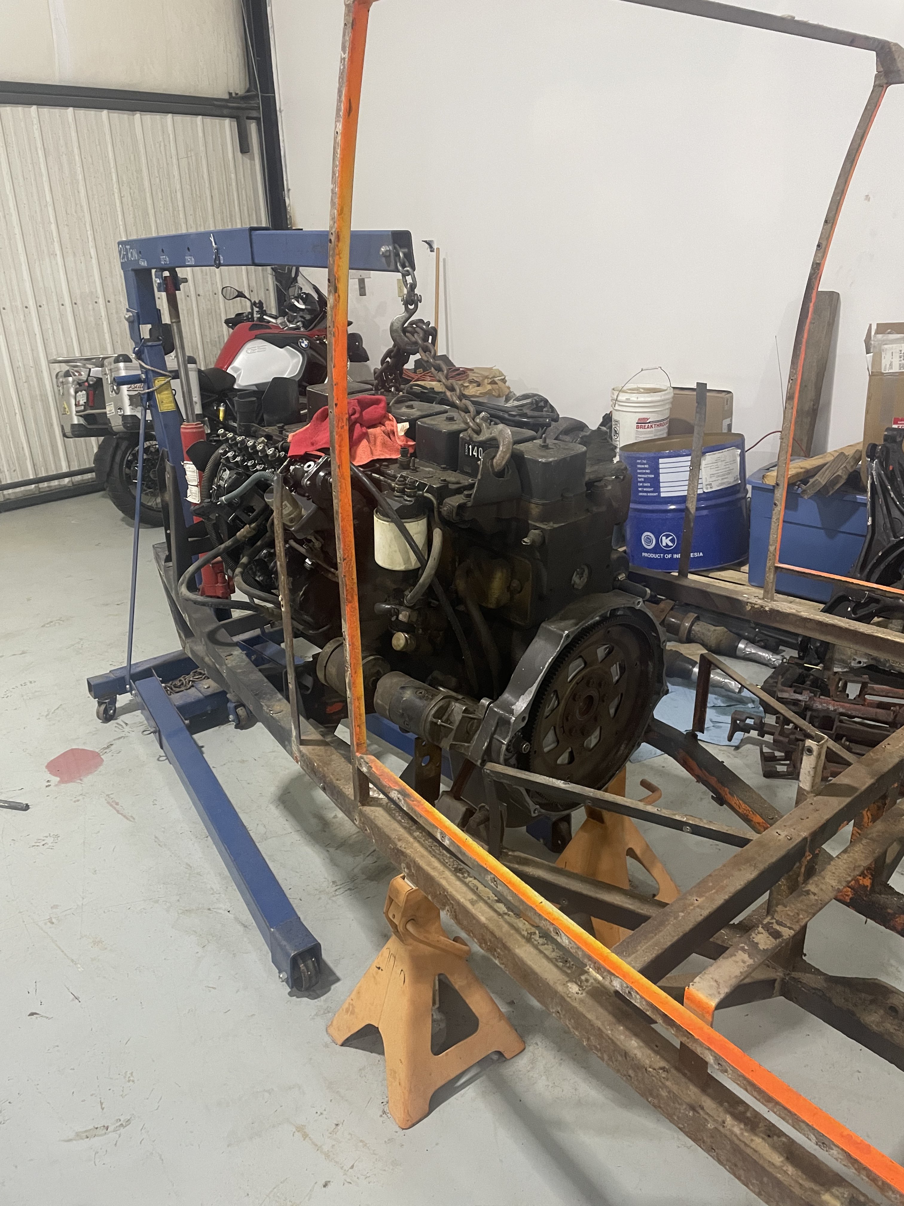

Yea I’m starting to see the fit issue. 😆. But thanks for the words of encouragement! I’ll keep rolling on it until it’s back in action.
Damn, that takes up some serious real estate! So, from post 27, what's the weight difference?
