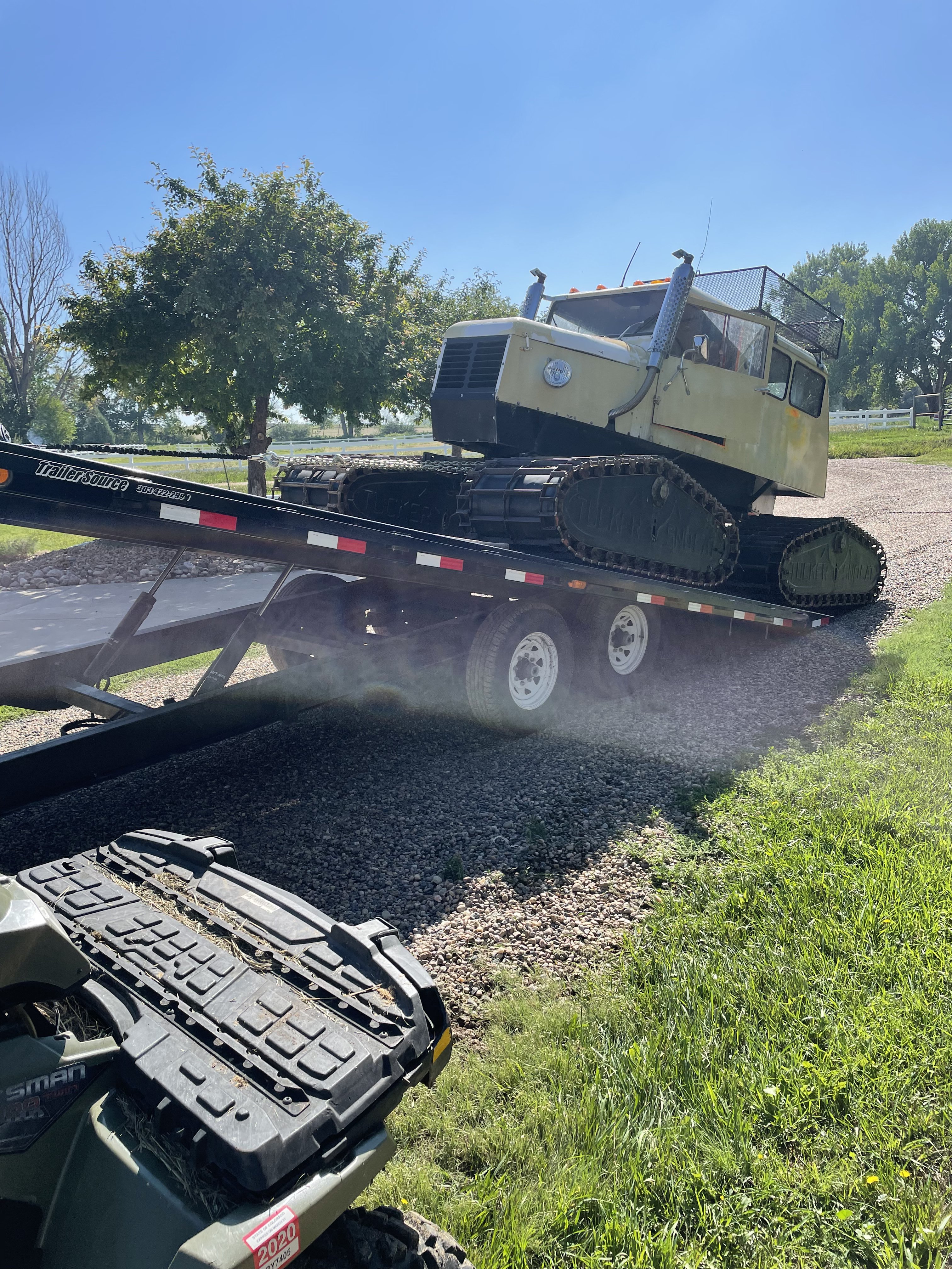

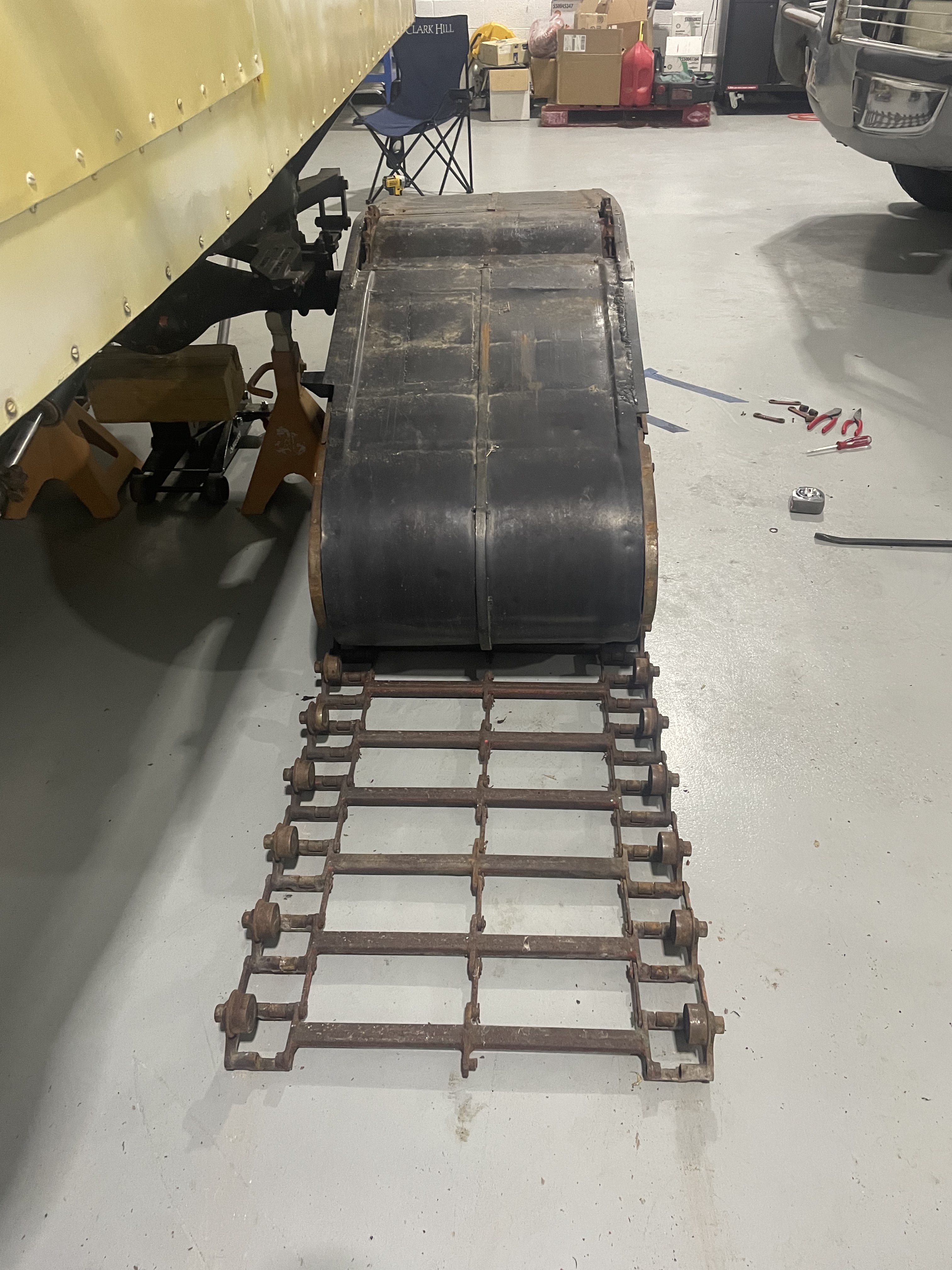

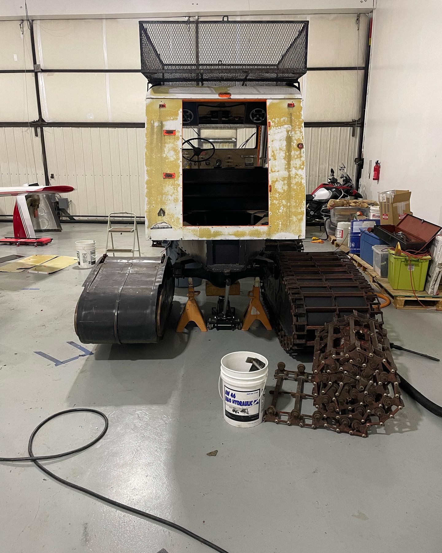

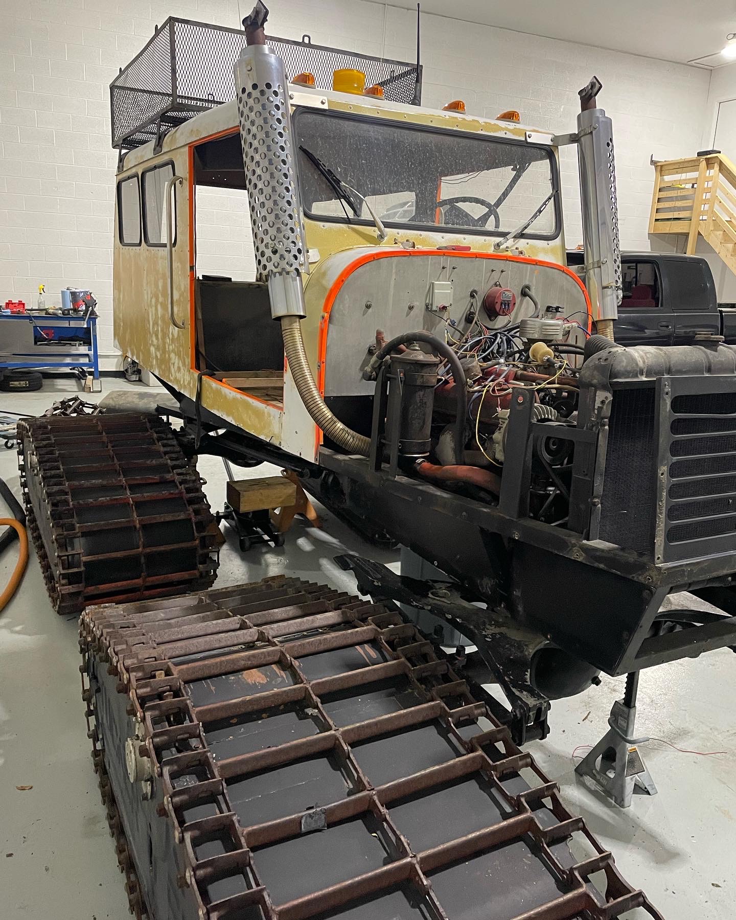

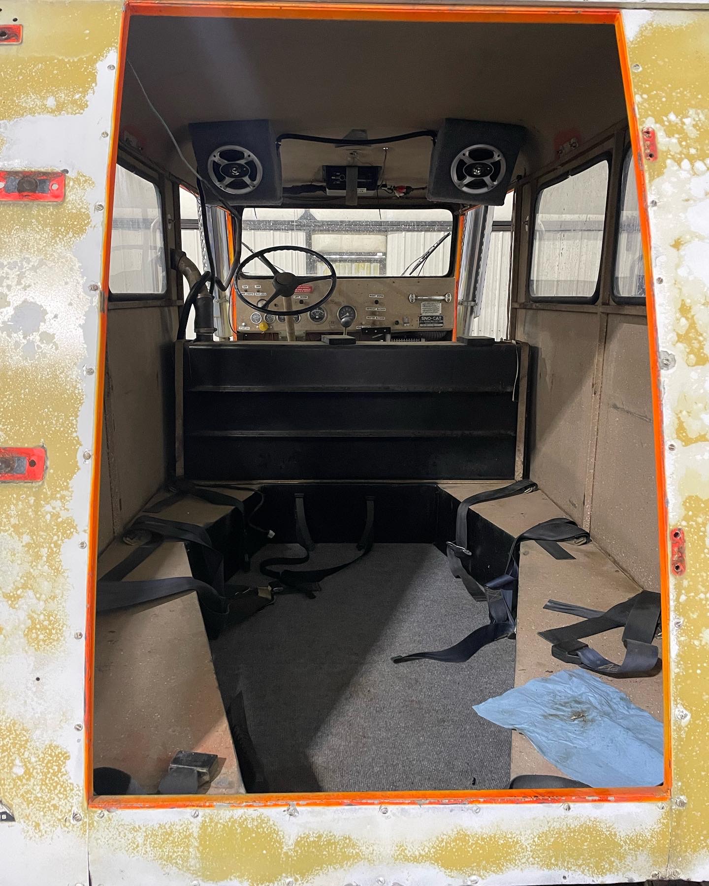

Hello everyone. Just started to tear apart our 543a to restore it back to its former glory. Looking for help and advice for this project. Tearing everything apart to be rebuilt. Starting with pontoons and working my way up. Have a buddy that has a machine shop so he is helping me with parts I need to make. We are figuring out how to remake some cleats for the pontoons also going to remake the drive sprockets. Going to be a ton of work I’m sure! I’ll keep posting as I go along. Thanks in advance

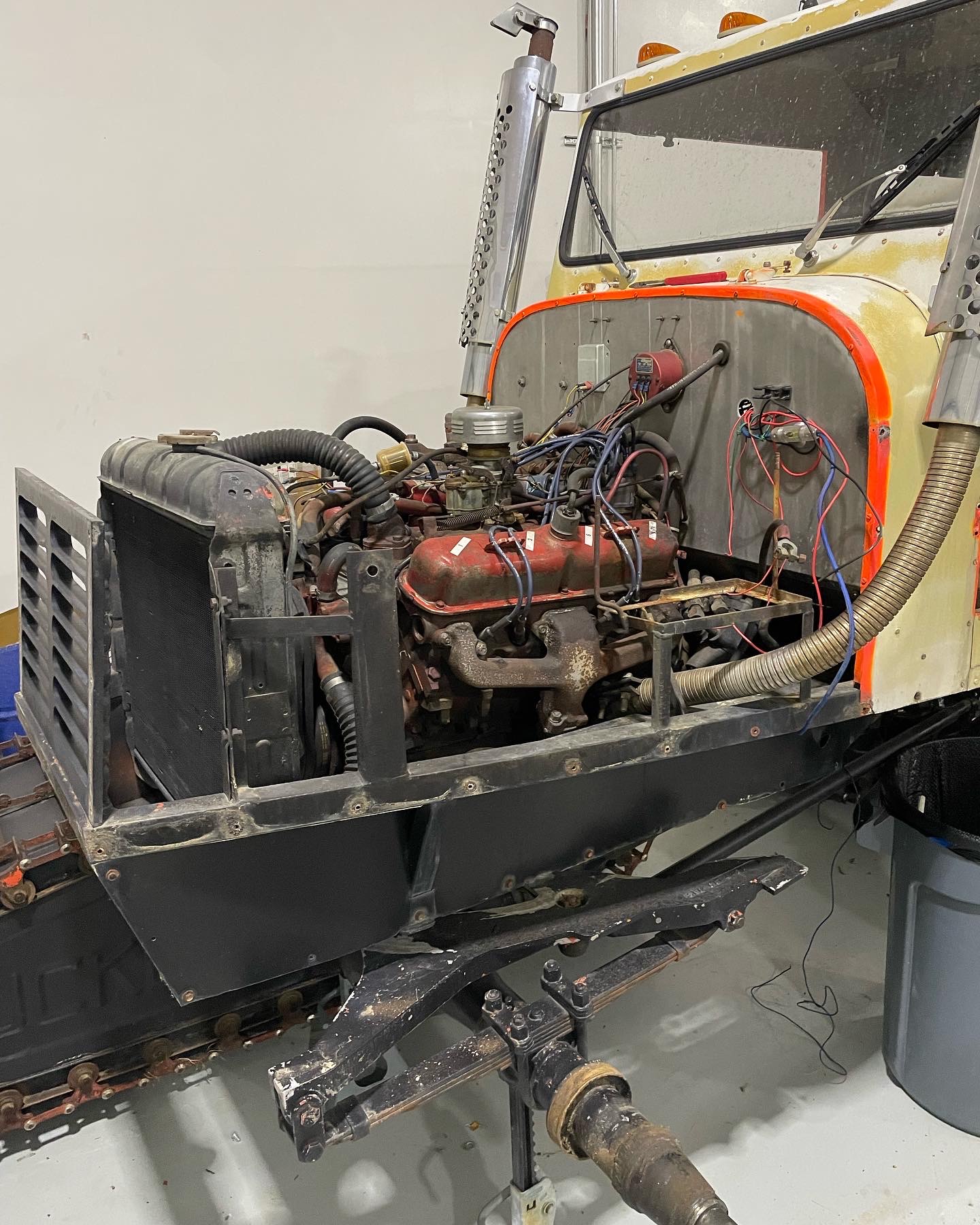

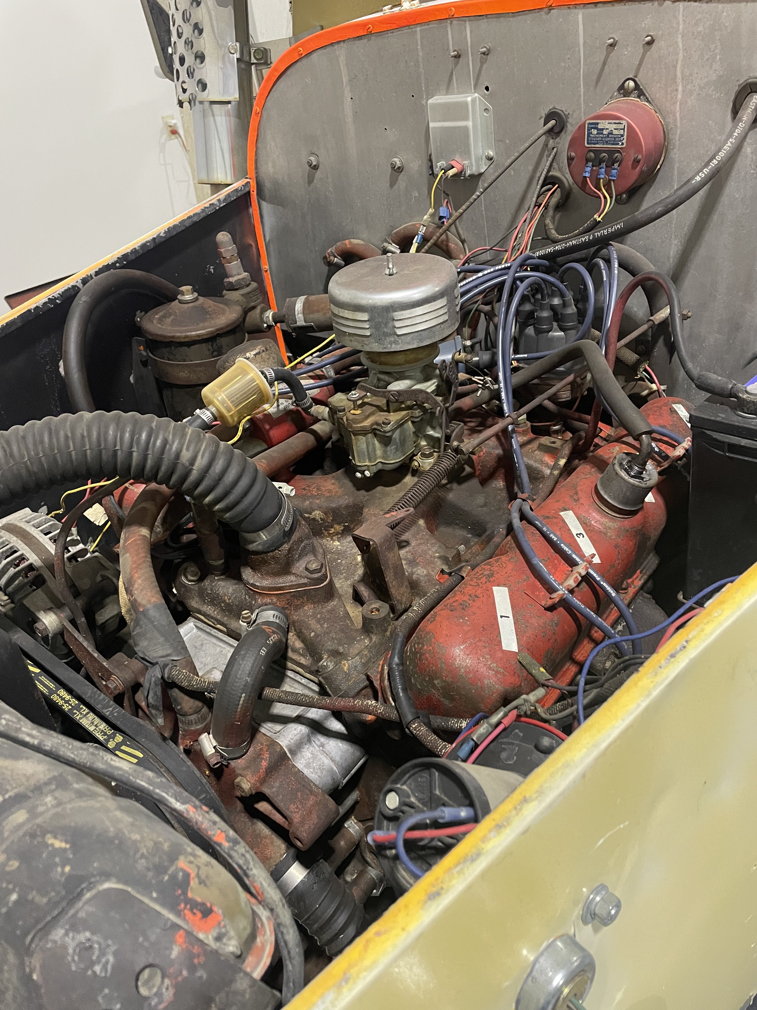

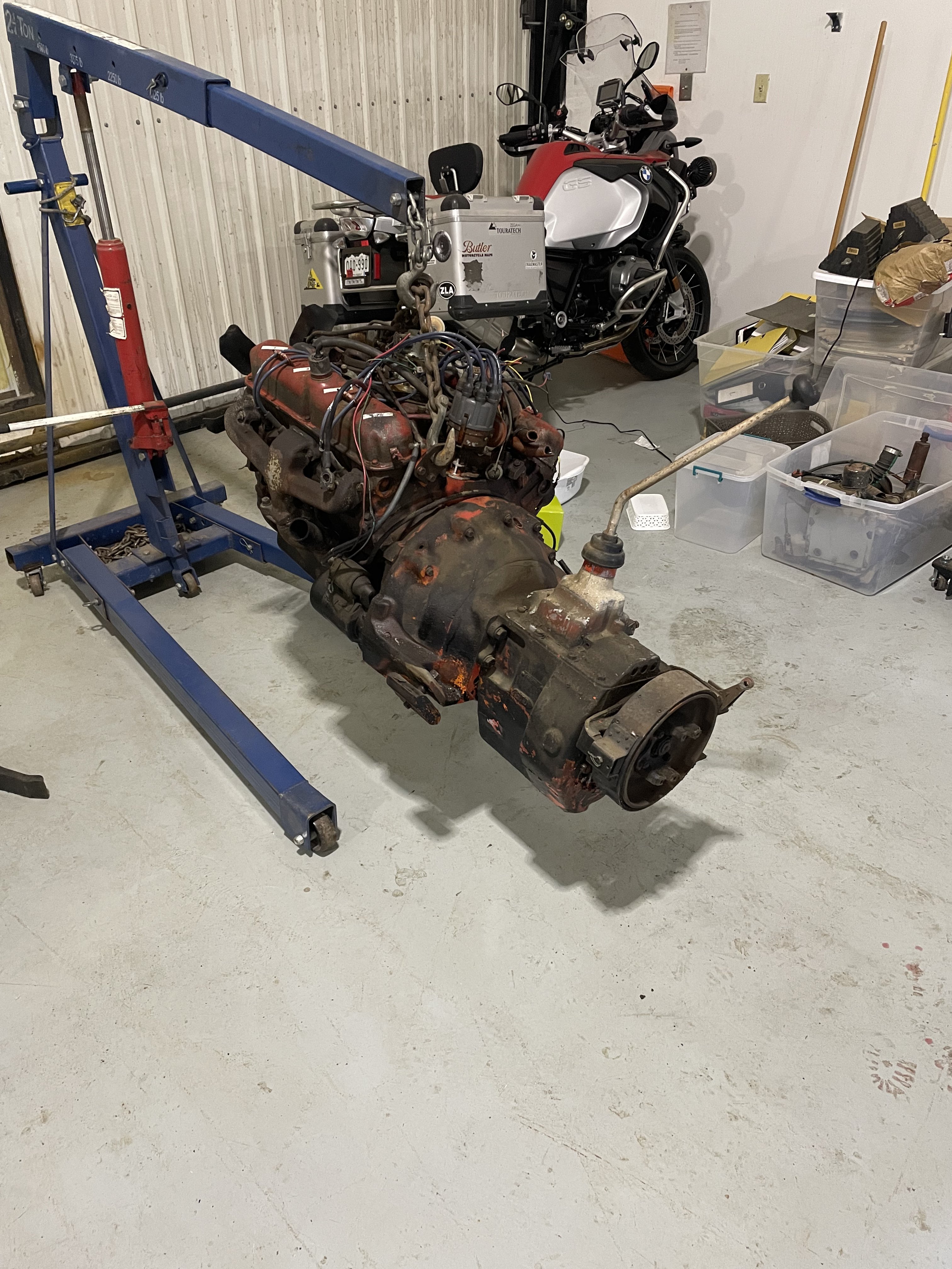

Nice machine you have there. What engine does it have?
I believe it’s a Chrysler V8 not sure exactly. My plan is to pull it along with the manual 4 speed. In its place I’m going to put a 12valve with an automatic. Some may not like it😆 but love the ol 12valve p-pump and enjoy swapping into different platforms.
Wow... you got your work cut out for you, even more than me :D A cummings or a cat is about the only engines I think would be worth a swap. Someone dropped a poly 313 V8 in mine in the 70s, I got plenty of power, I just need tracks that are up to the task now :D
Not positive on transmission yet. Probably going to go with a four speed. Open to ideas! Made more progress tearing stuff apart today. Is it better to tear every panel off and paint each one? Or paint as a whole?

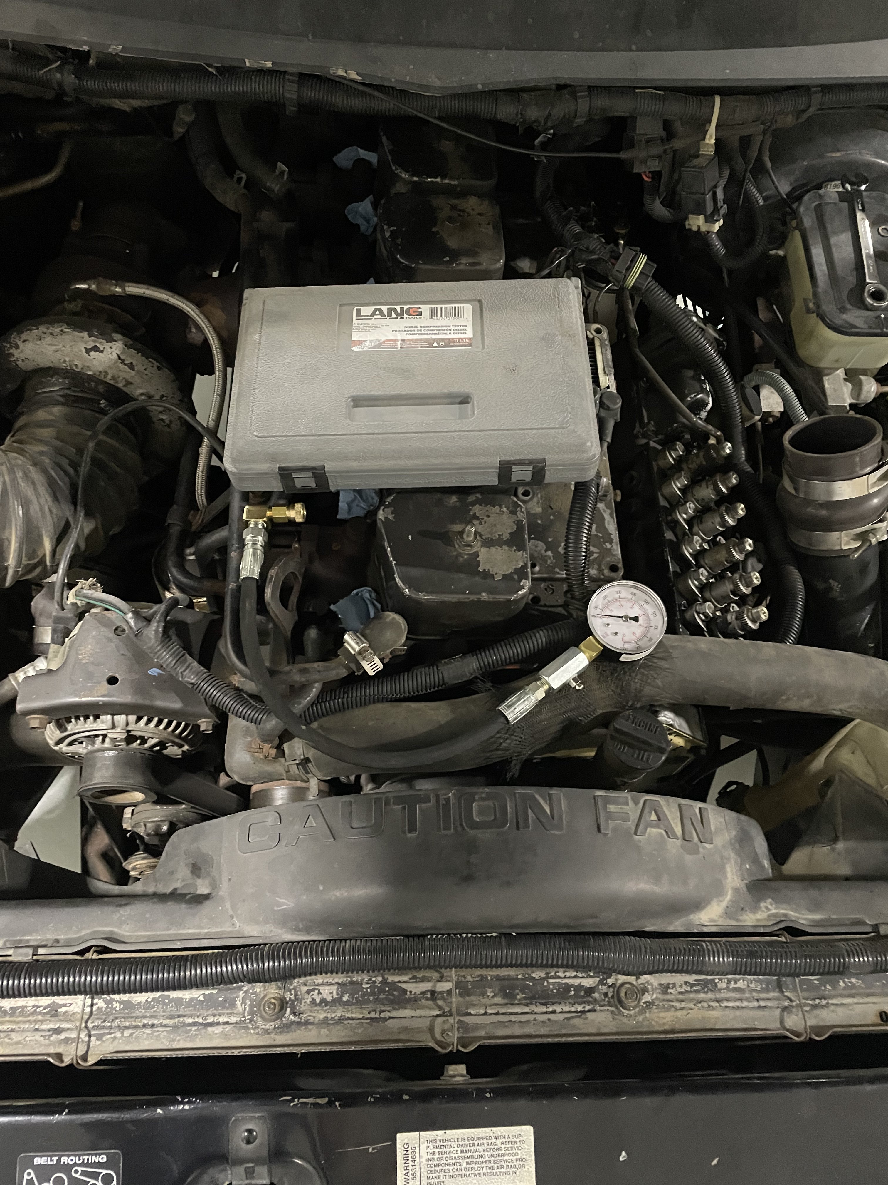

Also did a compression check on the ol 12 valve got 350 to 400 on every cylinder so think it will be ok for awhile.

Right on. This one ran ok when we ran it about 3 years ago, but would loose a lot of power when you shifted. Tracks are decent going to repair all cleats that are in bad shape. Rollers seem to be pretty good with a bit of grease and love. Pontoons are going to need to be opened up and repaired. Can hear crap rolling around in there when I move them around.
Painting each panel while you can get at the entire surface area is usually better....
Not to try to talk anyone out of anything, but just sharing some food for thought perhaps.
My '89 1644 had a Chysler industrial 360 and I rebuilt it to 400+ hp, and 400+ ft/lbs. A couple considerations in my case;
I considered swapping to a cummins but didn't want the added 600lbs of weight that comes with it, on the front end. How big of a factor that is for you would depend on the snow conditions for your use case I think.

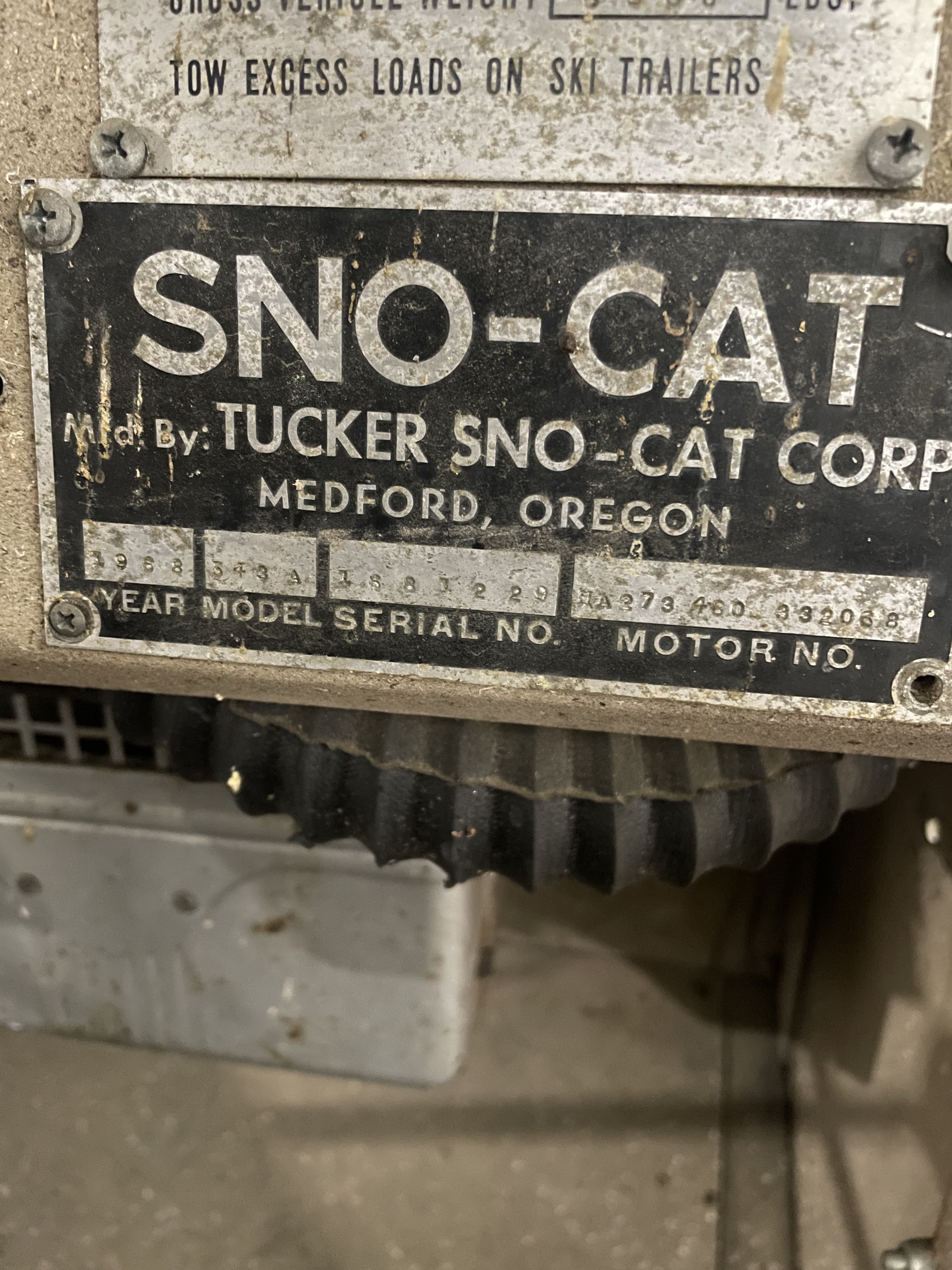

When I pulled the stock engine I had gusset to frame cracks near the engine. Tucker said that's not uncommon to see on this era cat, and that they just repair them, as did I. I'm not an expert but would guess the frame on a A-model cat that weights several thousand pounds less than my C-model, won't be heavier built. Also my cat had the Allison Trans, the heavy transfer case, and 70 diffs as stock, hence better capability of handling the added power. I also added the new style belted tracks and drive gears, which would be designed for more hp/torque than pontoon tracks. Again just a guess and there are certainly people here who can tell us if I'm wrong.
I'll admit that, generally in our snow conditions here in the west that one can only supply so much torque before track slip anyway, so how big of a deal is it? Idk 🤷‍♂️ But if it were me I'd hang on to the engine/trans if original. Tucker can probably tell you from the serial number if it is.
Great find on the 543 by the way. Welcome, good luck and have fun with it.
I've been quiet, but agree with 1BG. I believe the old tech running gear (from engine mounting to transfer case to the rollers) will be overwhelmed quickly by the torque from the 12v. The transfer may as well be built out of unobtainium since you would have to buy another machine to replace it. The rollers are $40-50. Each. They do not like speeds over 10-12mph and start to wear quickly beyond that. So, if you are looking to get somewhere quickly, that is the wrong rig. Depending on the past maintenance schedule for the machine, if it not greased religiously, those rollers probably already have some wear and it will only increase exponentially with speed. A newer rubber tracked machine (or running gear from one) would be better suited to handle your upgrade. As for loosing power/speed between shifts, start it in the gear you want to run in instead of shifting.
All of that being said, something like a smaller 4B (or similar) would, and has, worked great. My .02

The value of that cat will be preserved as is and be more power than needed with some easy servicing.
Diesel mod will be a limited market for resale and running the machine that fast will be costly. The mod will decrease value and overkill for the overkill already under-hood as designed.
That being said I split Jacks playing blackjack sometimes just because I can and it’s my money.
Fun ahead either way!
I will agree with the input of others on the WEIGHT THING
The Mopar is about 500 lb and the 12 valve is in the 1100/1200 range.....A 4BT will tip the scales in the 750/800 range.
The added weight on the front 5th wheel and axle assembly is really gonna be a negative .....Then the added weight of a tranny that can hold the diesels torque and stay together......
Aside from the extra stress on the frame and running gear......the handling characteristics of the machine may well suffer a lot....
On my project I ditched the big block Ford for a small block chevy to get rid of the extra baggage.
If the idea of a diesel is a MUST HAVE......I would go with a lighter package......Maybe an Isuzu ??????

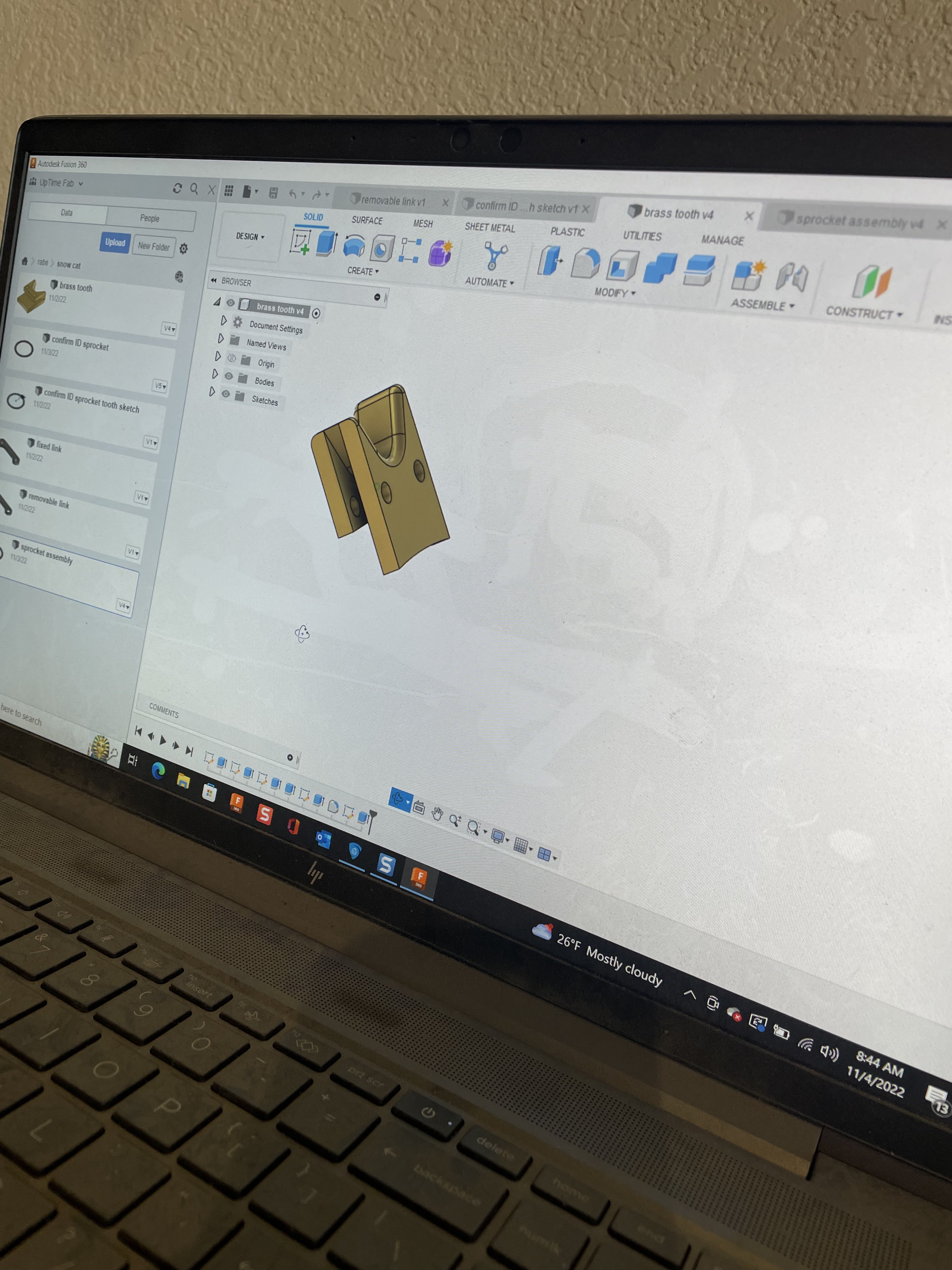

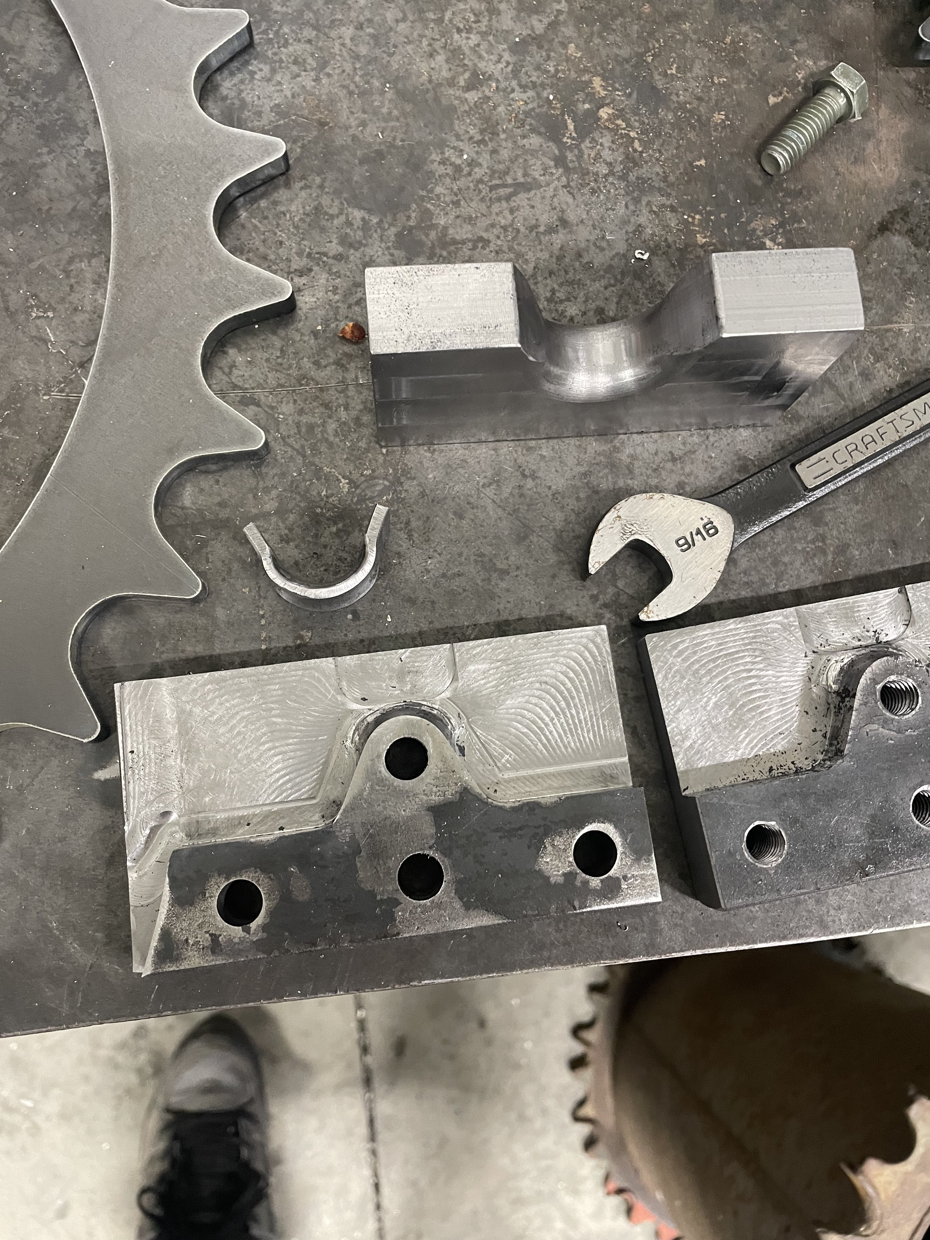

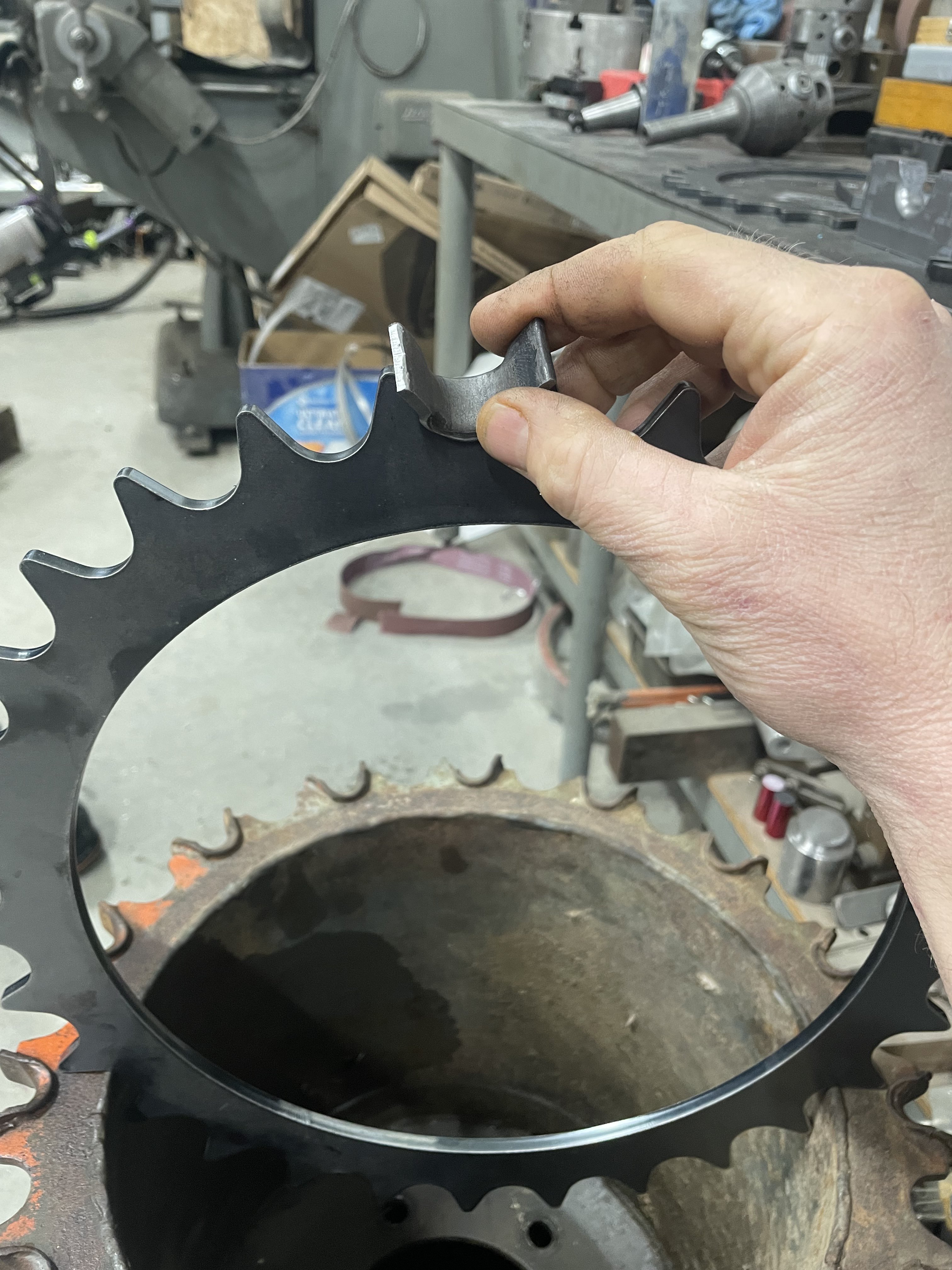

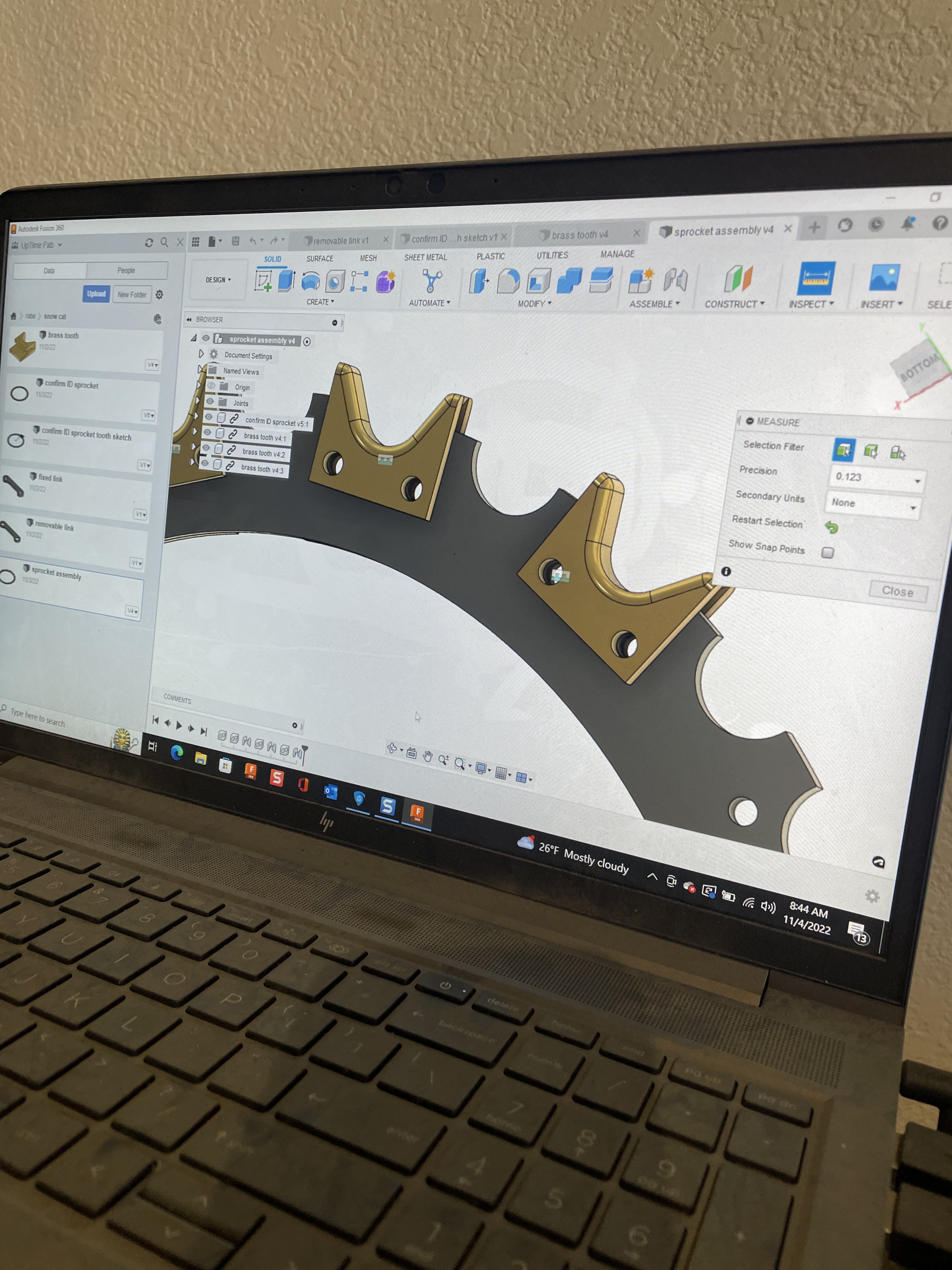

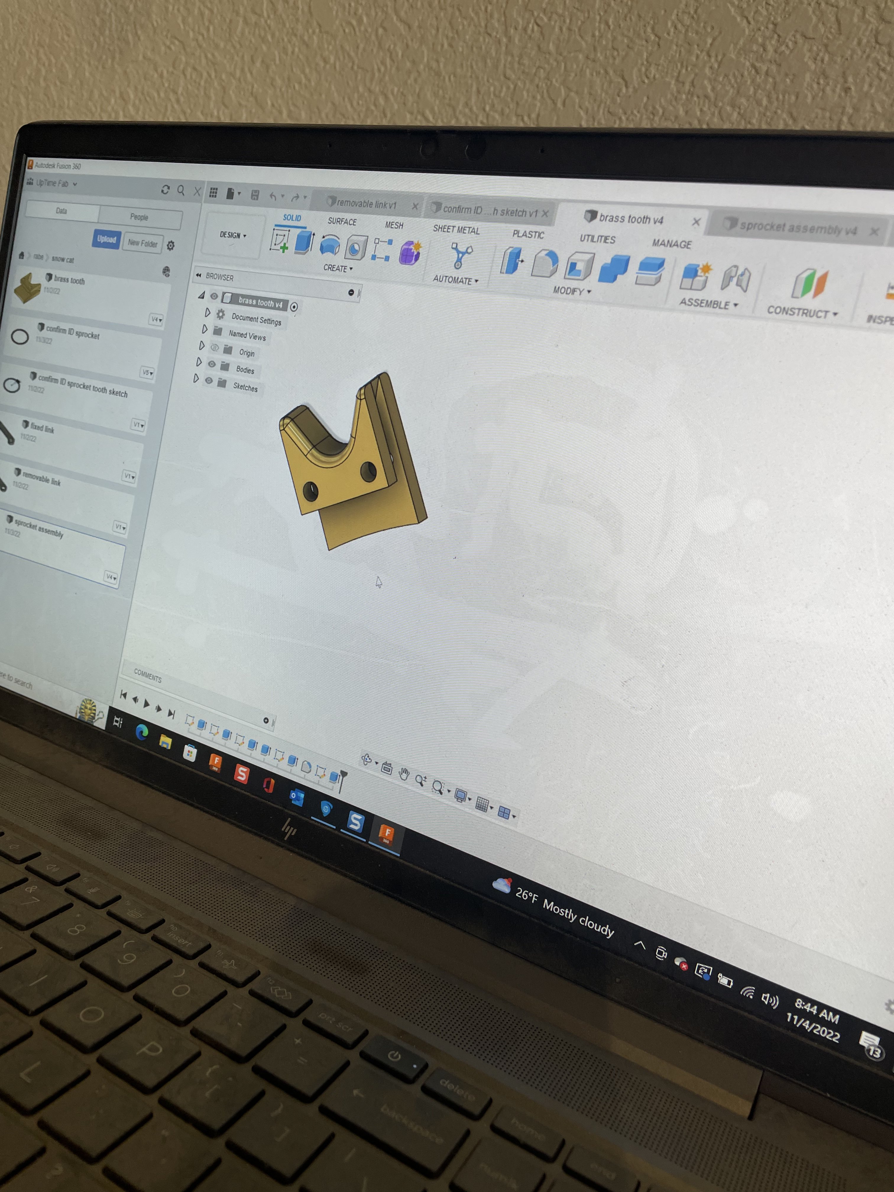

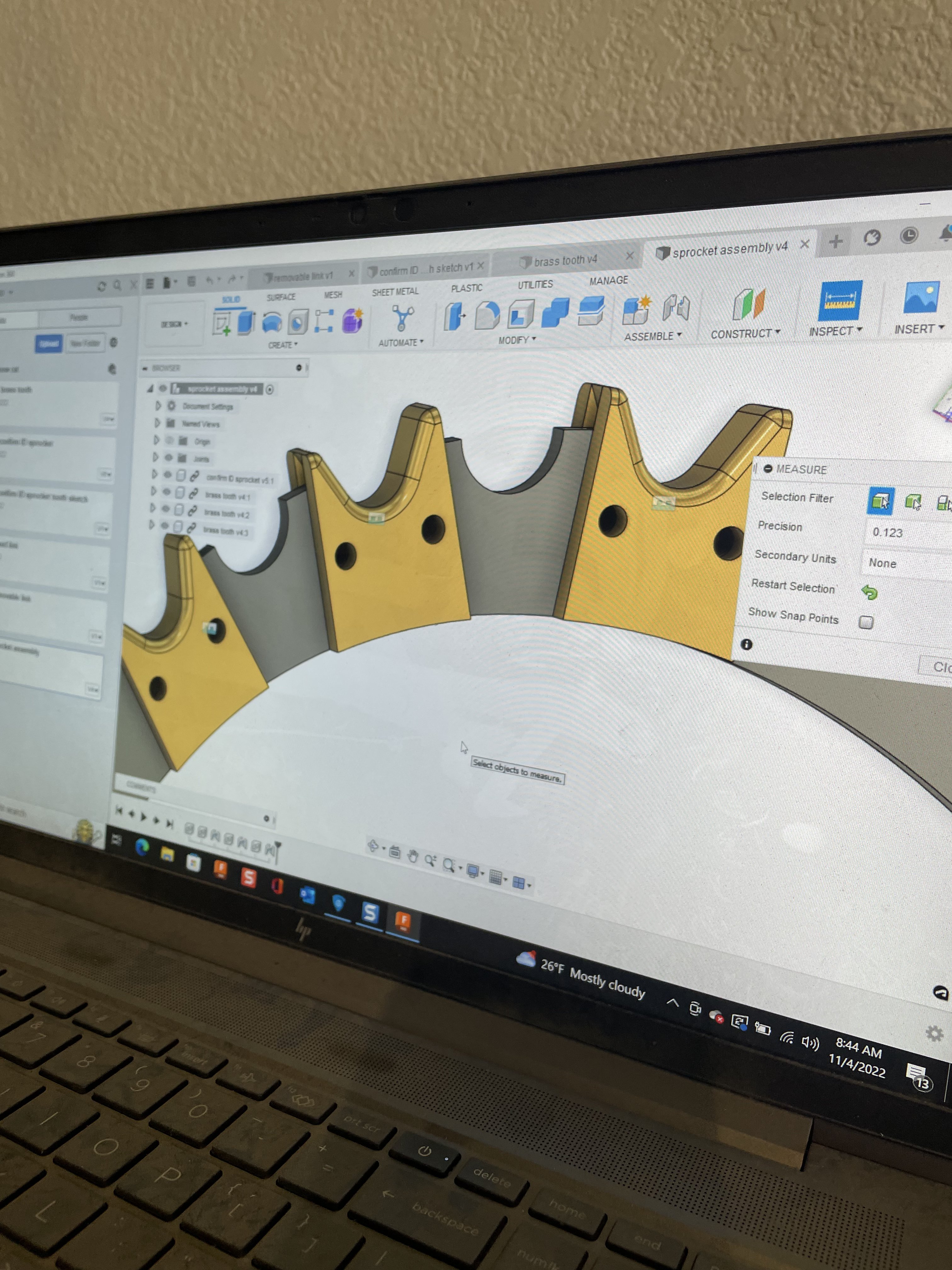

My buddy Mike and I came up with a plane for a replaceable tooth on the sprockets. He is writing the program for it now once’s it’s all together we’ll do some testing with it to see if it will fit on the cleats good when it’s together. Going to use oil impregnated bronze to make the tooth. The idea is we can replace them as the wear. Not sure if anyone has tried before?

If you just repair the steel as is make some weld in teeth your kids kids may have do it again one day.
Think about how long they took to wear out the first time.
If the rollers are free on the links and adjusted correctly should be much wear.
So what's on there now is worn out to the max. All teeth are worn through and adjusters are to the max. Going to rebuild all connecting links also due to everything being so worn out everything is about .020 oversized from what would be stock. Once I do this I believe will bring all adjusters back in and will be able to adjust back out as stuff wears. But my kids kids won't probably have snow at the rate it's going :) But we did just get some nice snow in Colorado yesterday!

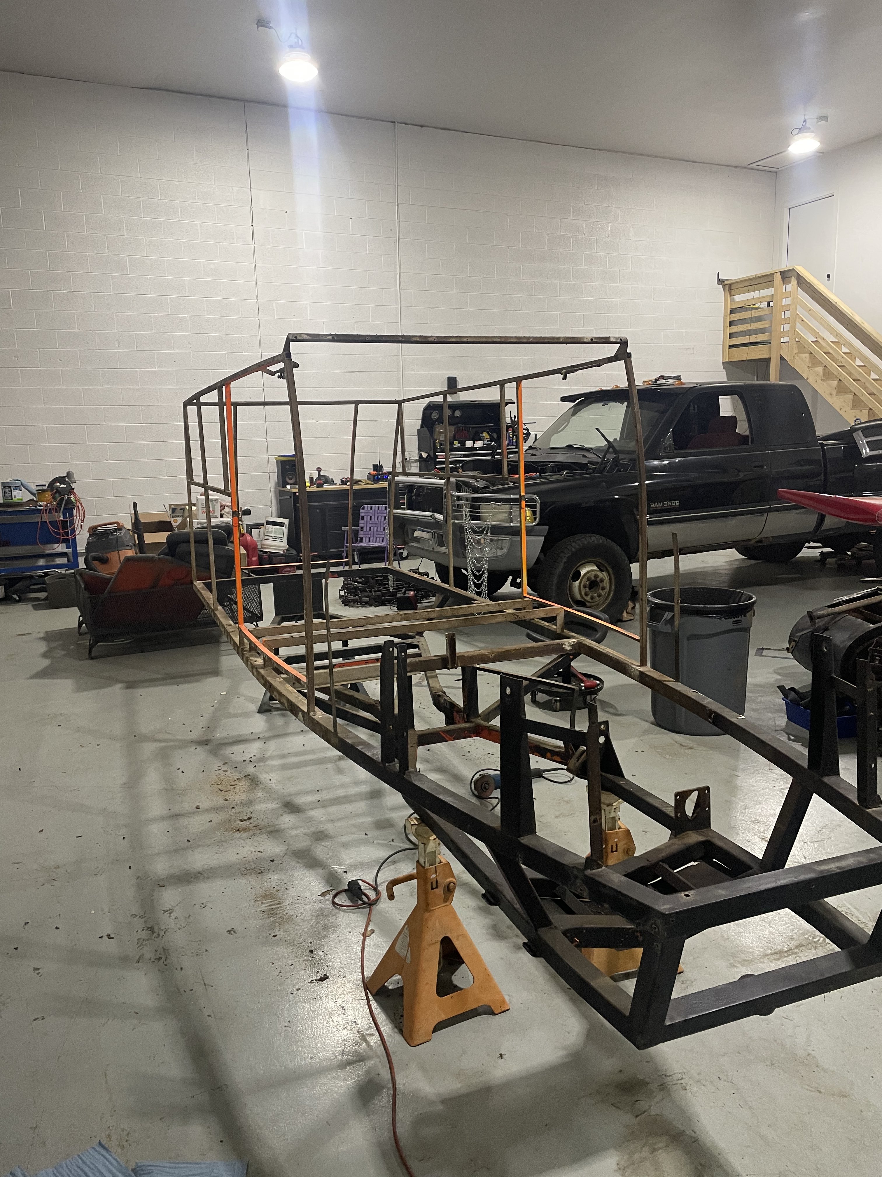

In case anybody was wondering.

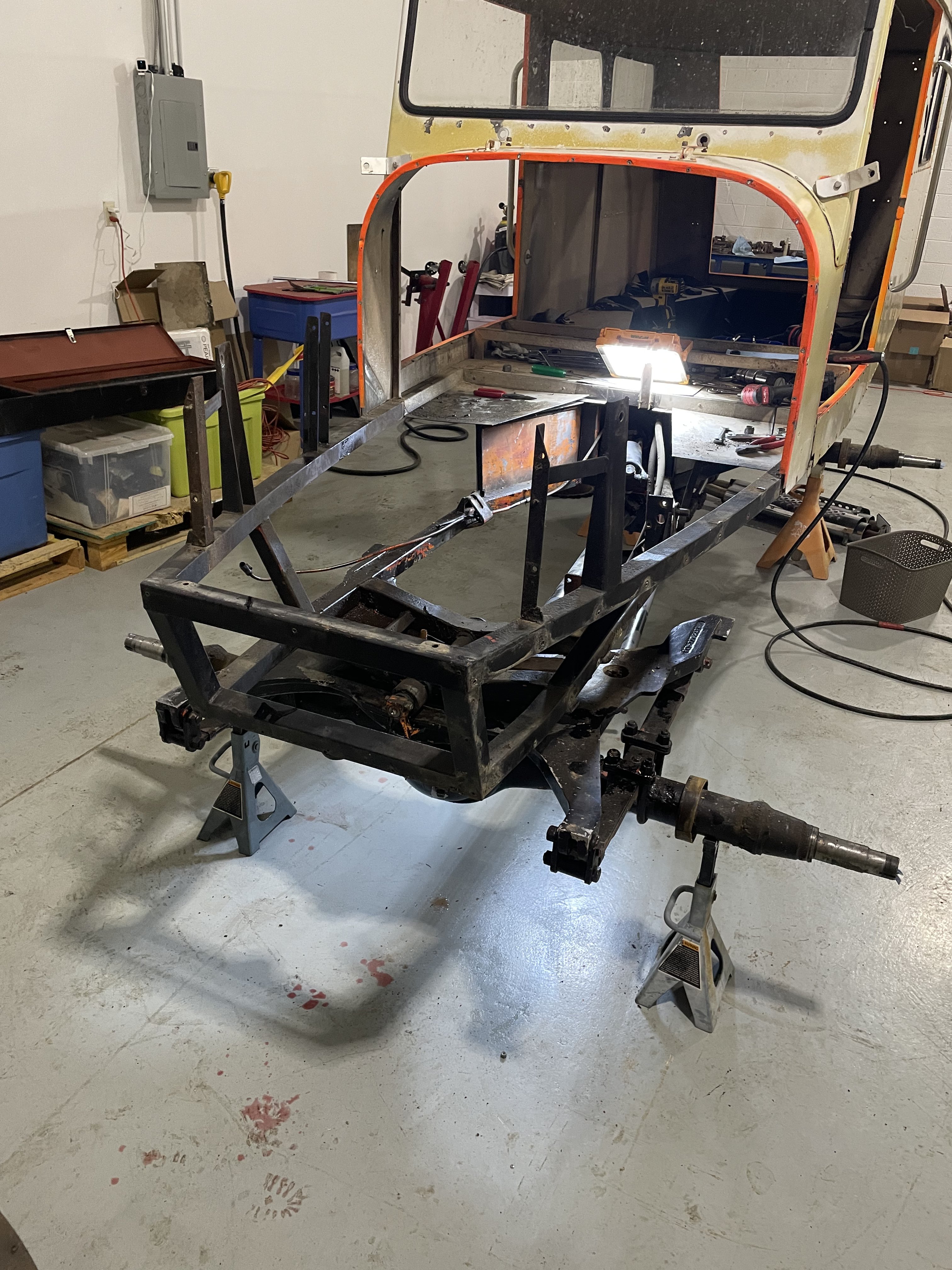

Check the bottoms of that upper frame. Bet you can punch holes though the metal.
Much moisture and water accumulates inside and rots inside out.
The 53 and 68 I work in both had that issue.

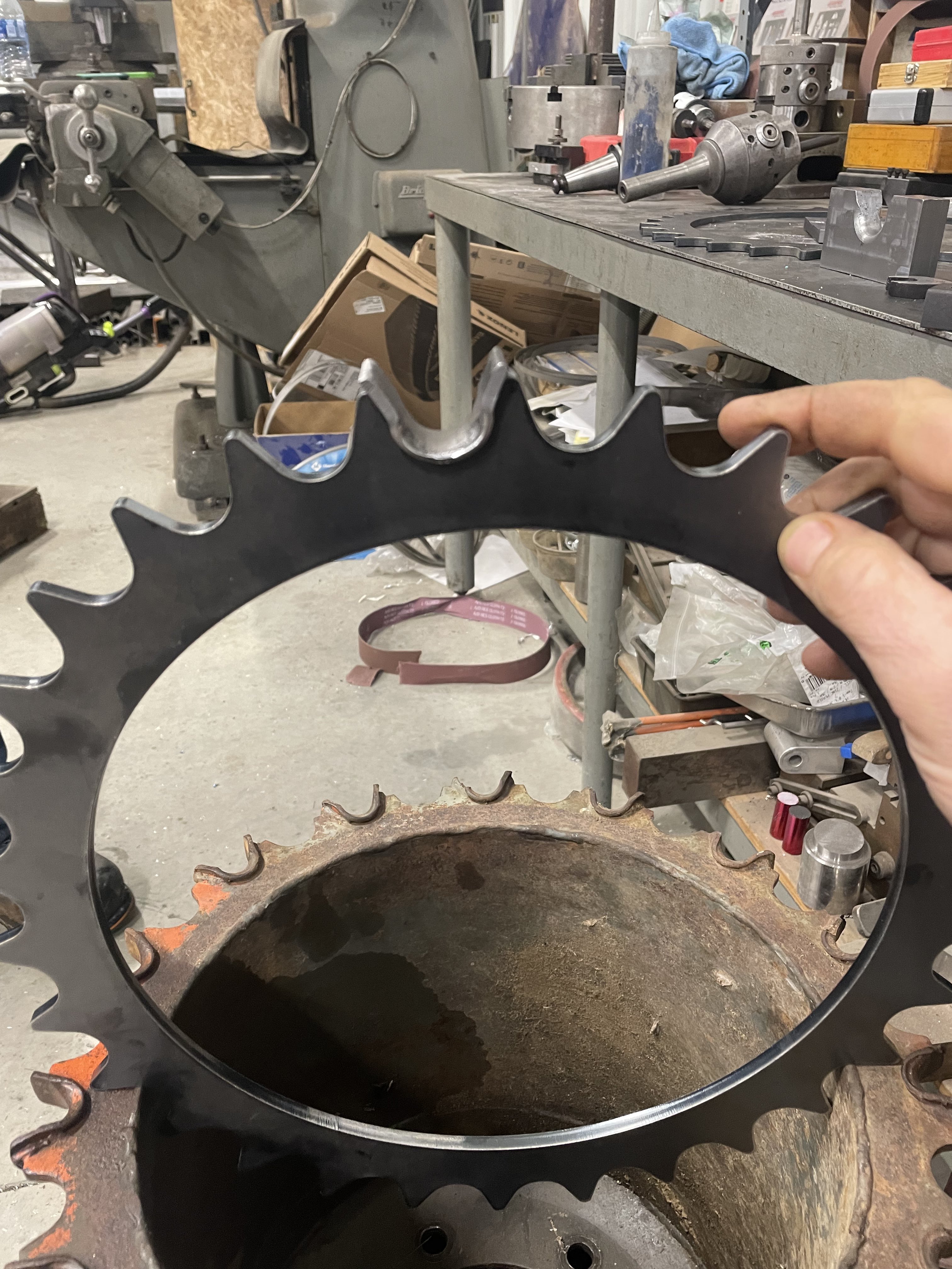

Got to the bones of the old Tucker finally. Also took input and went with original tooth. We made a tool and die set to stamp out new teeth. Working pretty well.
