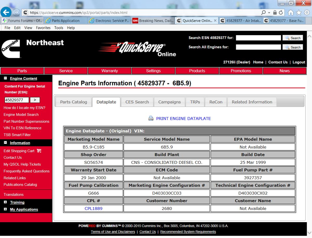

OK guys - the engine is 6BTA #45829377

Engine Parts Information ( 45829377 - 6B5.9)
Fuel pump is a P3000
Advertised HP: 185 @ 2500
Torque Peak (lb-ft): 549 @ 1500
High Idle: 2781

The 6B does have a provision for a grid heater under the after cooler - at least this one does. First thing to check is part #9 to verify you still have a good ground. If good you will need to back track to the power solenoid (not provided by Cummins, so it's not shown on my end). If both are good it is quite possible the heater has crapped out which wasn't uncommon.
Heater Voltage: 12
Heater Amperage: 190
Studded cap screw 3920344 on #5 cylinder valve cover. Mounting location for ground wire is on stud on #5 valve cover.
