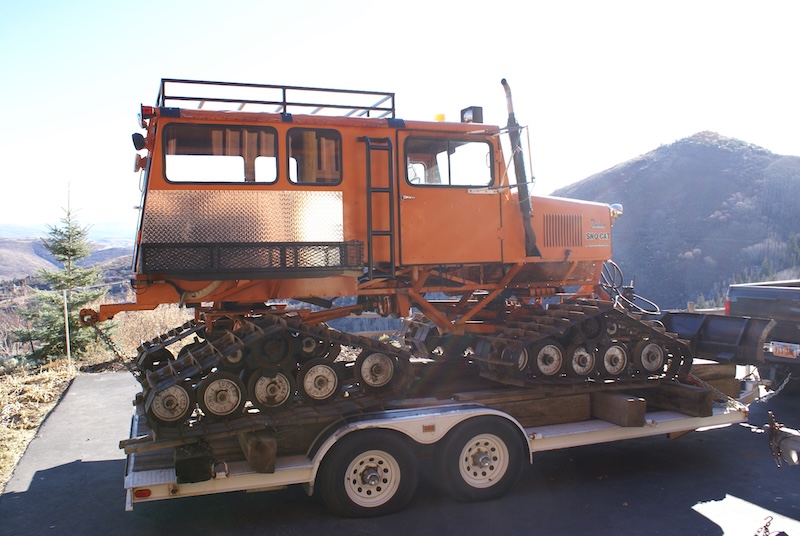

2009: Tucker number two: 1979 1642 (This became the "Vail Cat”).
2009: Tucker number three: 1980 1543 with long front tracks (This became Thundercat).

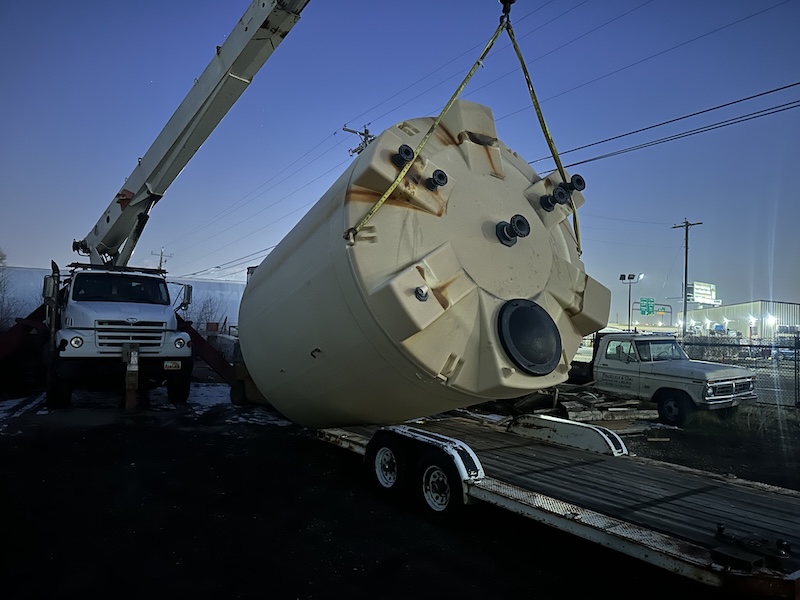

Back in January The Gorilla and I hauled a 10,000 gallon poly tank to Colorado on the same trip we picked up the ugly green snowcat for some modifications. When the tank was being unloaded, the crane’s winch cable snapped and the tank came crashing down on the fenders. Those fenders had many battle scars already, and the tank crash spelled their end.
Here’s the trailer with the tank being loaded on it (January 2025).

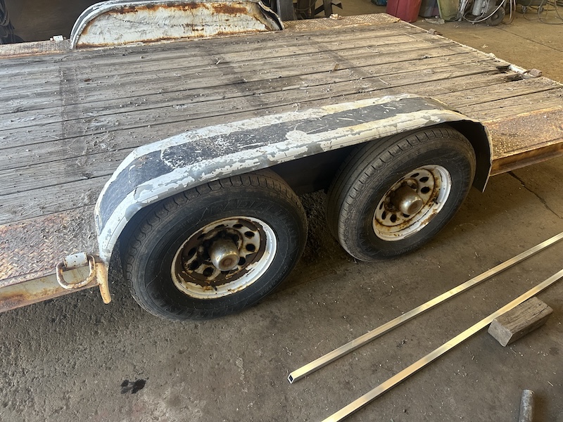

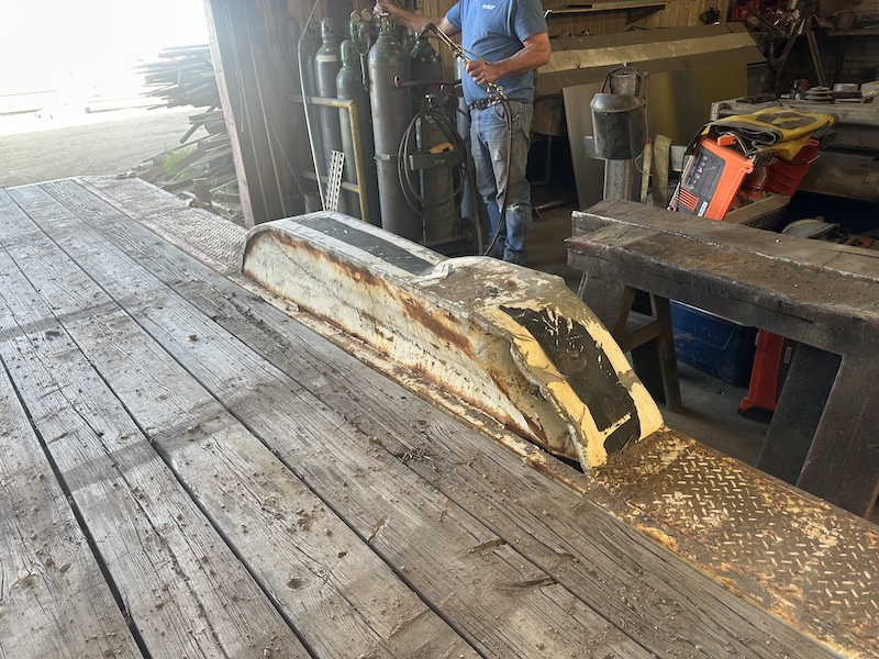

Scott and I talked about making some replacement fenders from steel channel, which would be much, much stronger than the original fenders. That would be a significant improvement and very cost-effective, but that would still require the use of cribbing for the mystery Tucker. A fair amount of discussion... and we hatched a plan to convert the trailer into a flat, deckover style. Yes, I suppose one could say “Those knuckleheads, they never learn”.
Here it is just prior to modification. You can see the damaged fenders and some rotten deck boards. Note the rust and the wheels. But that trailer has provided 17 years of great service, and that’s after nine years with the original owner.
Another pic. Note The Gorilla holding the acetylene torch. I can just picture him using The Evil Chadster's MUAHAHAHA phrase as he salivates at removing the fenders. But truthfully, he is amazingly precise with that torch.
Turn Scott loose with an acetylene torch, and things come apart... fast. The fenders were gone in maybe 15 minutes, max. The trailer’s wood decking, which dates to the trailer’s manufacture in 1997, desperately needed replacing, so that was removed in pieces. Nothing surgical about it; long pry bars and some leverage blocks pretty much broke all the deck boards loose from the trailer. (The remnants were cut into short lengths for wood stove fuel.)

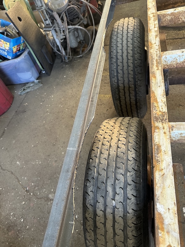

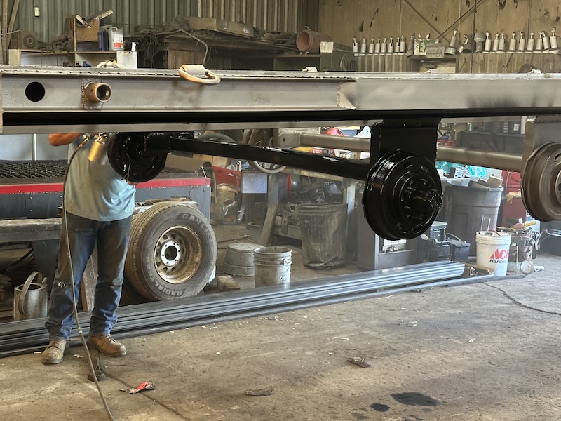

The trailer has two 5,000 pound torsion axles. Torsion axles have what I'll call a lever arm that attaches to the axle at roughly a 20º angle from horizontal. During manufacturing one could position the arm pointing down, for more ground clearance and a correspondingly higher trailer deck height, or position it angled up, for less ground clearance and a lower trailer deck height. They were positioned up on this trailer.
After a fair amount of kicking around the best way to modify the trailer, we decided on several changes to the axles. We wanted to shorten the axles to bring the tires closer to the trailer’s main frame. By flipping the axles upside down we could re-orient the torsion lever arm down and that would get us four inches of the height we needed. (The lever arms point to the rear so flipping the axles upside down also means turning them around when installing them.) The axles were cambered and flipping them upside down means they needed to be cambered the same amount in the opposite direction. When they were originally built they used a length of 3” square tube and bent the tube in a press. We cut several inches from the axle’s length in the middle, and Scott positioned a short length of 2 1/2” square tube inside the cut ends of the axles. They were moved into position and carefully checked for alignment while simultaneously positioning the axles at a slight angle to create 5/8” of camber. Then he welded the axles and the splice tube together. By using the splice tube he was able to get a full penetration weld for maximum strength.
I'm a welder “wanna be”, which means I possess limited skill. (I can picture Scott reading this “Limited? Try none!”) Scott would make the root pass and I was tasked with the cover pass. A good welder makes welds that are both strong and cosmetically appealing. Yeah, well mine aren’t so appealing, so I end up doing a fair bit of grinding. That provides an incentive to really try and make better welds.
As part of the axle mods we added a 12” long length of 10” rectangular tube to space the axles down from the frame. Due to shortening the axles, which moved their mounting plates inward, we had to add some brackets to the frame for that rectangular tube to weld to. We used 2” x 3” x 1/4” thick pieces of steel angle for the brackets.
Here’s a pic of an axle cut apart and shortened prior to re welding with opposite camber. Note the rust. Ugh.
Here’s the trailer with the first axle modified and tack welded in position. Note: If you look toward the rear of the trailer you can see the trailer’s ramps stored perpendicularly between frame crossmembers.
And with both axles modified and tack welded into position.
The next step is to weld in a length of 4” channel on both sides to bridge the gap where the fenders were. Then the space occupied by the fenders will be filled in with pieces of steel diamond plate.

Before fully welding the axles in their new position, Scott suggested loading the trailer to check for tire clearance with the yet to be installed diamond plate. He was concerned about having the axles only tacked in position with the stress of loading something heavy, so Scott put one forklift on each side in the back to support the trailer during the loading process. Then he drove the Ugly Green Snowcat up the ramps and onto the trailer.
Clearance was marginally okay, but when you consider what would happen if one hit a good sized bump, as well as what would happen if all the weight were on only one axle, we decided more clearance was necessary. CHUGSzilla was unloaded and Scott cut the tack welds, repositioned the axles one inch lower, and finish welded the axle assemblies in their new position.
Diamond plate was then welded to the trailer where the fenders had originally been.

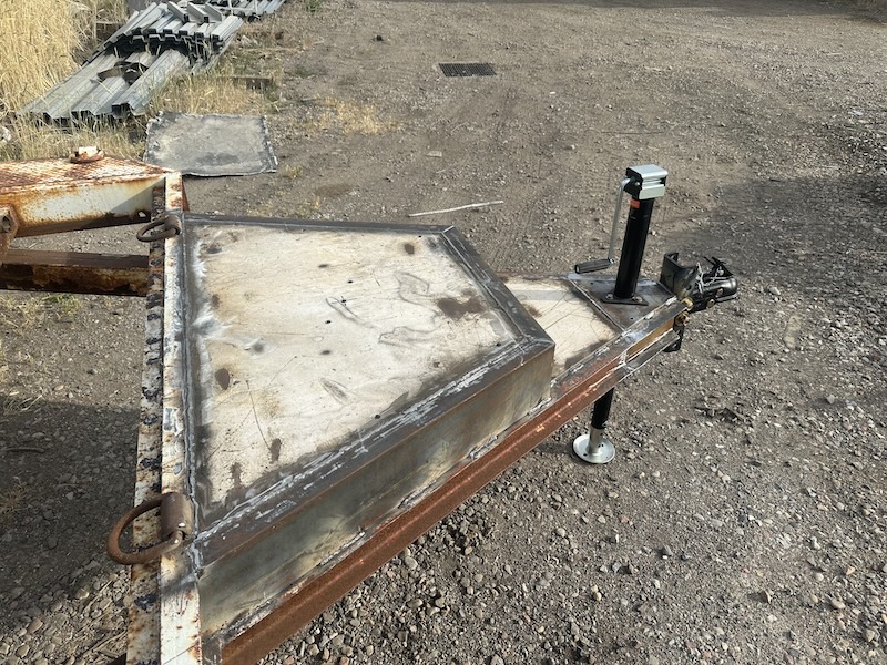

I was content with the hitch. “Nope, it’s too high for most vehicles" (my tow vehicles have been lifted a bit, so it's not a problem for me). So, we cut off the existing hitch and I bought a kit with a piece of drilled, bent steel channel and a ball hitch that can be mounted in the different positions. Because the front of the trailer is higher, he wanted to replace the tongue jack, so I ordered a new one. I had suggested mounting a lockable box to carry tie downs etc. I was thinking of a simple rectangular box mounted under the trailer on the side. Oh no, that didn’t pass muster with The Gorilla.
He wanted a triangularly shaped tongue box. (Okay, that’s doable, but he was just getting started.) He wanted to cut off the existing steel plate on the tongue, then add some 6” channel to raise the tongue box, add a new top plate, as well as some supports underneath, and mount the spare tire under the tongue. But the tire couldn’t be simply mounted. He wanted a spare tire winch setup similar to what comes on full sized pickups these days. So everything was ordered.
Scott believes the original trailer tongue structure was modified after the trailer was originally built. There are two lengths of rectangular steel tubing that form the tongue’s V-shape, and the modifications consisted of welding 4” steel channel to the outside of the rectangular tubing for added strength. Except they stopped the reinforcing channel short of the end. Why? Scott thought where the channel stopped was a weak point in the tongue, and so pieces of 4” channel were added to eliminate that weak point.
Here you can see the pieces of channel added to reinforce the tongue, as well as the new hitch setup.
Here is the raised section of the tongue that will support the triangular tongue box and mostly conceal the spare tire. Note the frame crossmember has been slightly carved for spare tire clearance.
And the mostly finished front of the trailer.

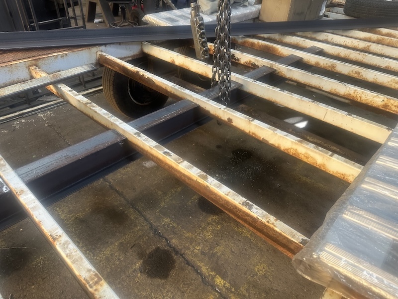

The setup to carry the ramps would be a piece of 6" x 10 I-beam, and two lengths of 5” x 3” angle. Note: I-beam is specified by the height of the web and the number of pounds per foot of beam. Thus, a 6” x 10 would have a height of 6” and weigh 10 pounds per foot. The I-beam and lengths of angle would be notched to fit around the frame’s existing deck support cross members and welded to them. We’d make a hinged door to cover the ramp access window.
The new aluminum ramps are 15” wide and 3 1/4” high. The plan is to cover the top of the ramps with some rubber so the mystery Tucker’s steel grousers don’t chew up the aluminum during loading and unloading. We decided to allow 4” for the ramps within their support framework.
As I mentioned above, the 6” I-beam and 5” lengths of angle needed to be notched to fit around the trailer’s deck support crossmembers. Careful measurement and layout of where the notches need to be, should have resulted in the new frame members fitting well. Except, Scott was teaching me the finer points of using an acetylene torch. In a previous post I said he was amazingly precise. Well, he is… and I’m not. So, we had to spend some time with an angle grinder cleaning up my less-than-stellar attempts at notching with an acetylene torch. Readers to my posts may recall I often say “Scott is the brains and talent, and I’m the one with the bonehead ideas”. This is exactly what I’m talking about!
Once we had the fit adjusted to an acceptable degree, we used the shop’s bridge crane to hold the I-beam, and then the angles, in position for tack welding. Then some tweaks and final welding. He did some, and I did some. Sadly, it’s not hard to tell who did what. But if someone wants to inspect my weld quality (or lack thereof) they’ll need to crawl under the trailer to do so. ( Yeah, good luck with that.)
Here's the center I-beam supported by the bridge crane.
The ramps fit well and the next step is to fabricate and install the access door for the ramps. They weren’t cheap, and nice aluminum ramps are a tempting target for thieves, so Scott suggested making the door lockable.
The installed I-beam and angles with the window.
One ramp partially extended.
Both ramps stowed.

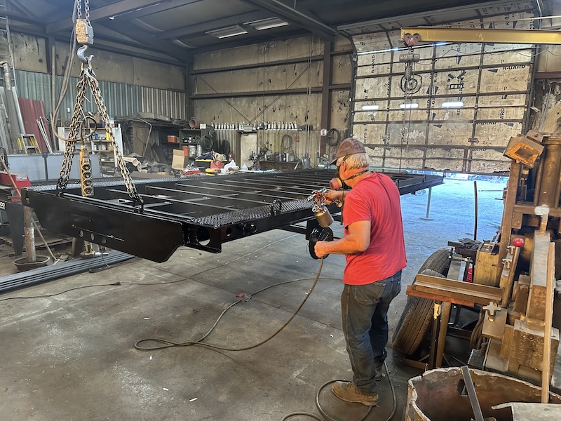

I bought a direct to metal (no primer required) catalyzed polyurethane paint from Sherwin Williams. Pricing is bizarre. I didn’t think one gallon would be enough, and when buying less than a gallon, the cost is much higher, so buying two gallons is roughly the same as 1 1/2 gallons, and buying 5 gallons isn’t much more than buying two. So… I bought five.
As I had previously posted, the plan was to hang the trailer from the two cranes in Scott’s shop. That is a slick way to paint a trailer! We could raise or lower the trailer accordingly for optimal positioning. As is our general practice, I’m the chemist, and he’s the applicator. That seems to work well. I’m mixing the next batch while he’s spraying. We basically put two coats on everything, and had to do some touch up in some areas, so they got more. How much paint did we actually use? About 1 1/2 gallons. Here are some pics.
The blasted trailer hanging from the cranes.
The start of the first coat. Note to redsqwrl: NOT GREEN!
The Gorilla applying the second coat. These pics do a great job of illustrating how awesome the crane setup is.

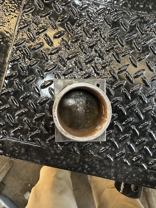

The hub covers are plated steel stampings and there is a rolled rib about 1/4” back from the edge that fits into the hub. Scott likes to get a piece of scrap steel tube that locates on that rib. He found a piece of tube and then used an angle grinder and stone to slightly enlarge the ID so it would fit the new hub covers properly. He then welded a scrap piece of plate to the opposite end. I started to tap the hub cover driver to install a hub cover but it wasn’t cooperating. Scott then asked for the hammer and proceeded to whack it much harder. That worked, and I did the hub covers on the opposite side. I was genuinely surprised by the force required to install the new hub covers. I am 99% sure the wood block technique would have crushed the hub covers.
Here are a couple pics of the Gorilla-bilt hub cover driver.

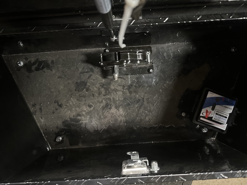

Here’s a pic of the inside of the new tongue box. You can see the spare tire winch and the breakaway battery.

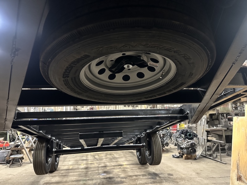

The spare tire viewed from below.
And a side view. You can’t even see there is a tire mounted underneath. (The Gorilla deserves all the credit for this concept and execution.)
