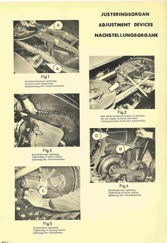

I've been working to try to get several Users Manuals into a format that can be posted, but the files sizes are simply too big. But some information is missing from some manuals and included in other manuals. This is an exerpt from Paul Cooper's 1963 manual that applies to most years (the track adjustments would apply to the early models but not the later versions).
The first page is the photographic description of the adjustment, the following 2 images are the written instructions that go with the photos.
Again, thank you Paul :tiphat:
