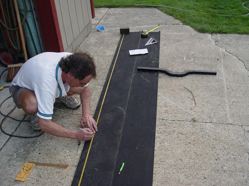

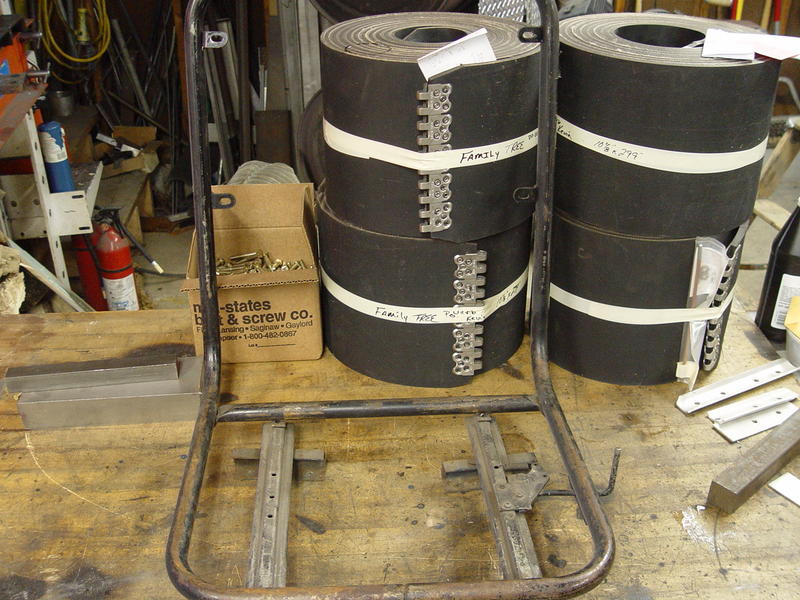

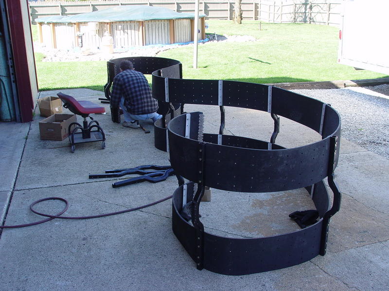

I know the belting co. that I dealt with is quite a ways away from you guys in the west, but the belting Co. here in Michigan that worked with me on selecting the proper belt for my cat, were quite helpful and experienced in cold weather belting. My original belt on my 601 was a 4 ply, the new belt for my 601 is a 3 ply (but it is the same thickness) as the old 4 ply and they say it is MUCH better belt than what was made as a 4 ply back in 1963. My top covering is "I think" is 3/16, bottom covering 1/16.
I wish I would have taken pics of there factory, because they had ALL KINDS of belting, and rolls of belting that were as every bit as big as a Thiokol 601 that they move around with overhead cranes. I was quite impressed watching them making or (cutting) my belting to size and installing the Stainless Steel lacing. I can dig up the info on them it anybody is interested in contacting them, they are in Westland Michigan.:thumb:

Weatherby,
Thanks for the reply, and the suggestions.
I noticed in the photos you used a different [and more robust] track lacing system than I've seen installed on Tuckers.
One belt supplier in SLC recommended a belt with a 3/16" top cover and a 1/16" bottom cover, which is what you got. IIRC, Boggie recommended "balanced" covers of 1/8". Do you recall why you selected covers with those specs? Also, was your belt supplier DP Brown?

Yes, my belt supplier was DP Brown. I can't recall why the top and bottom coverings are offset however, they did say the three ply belting that I am using is much more of a superior belting in all respects, compared to the original four ply made back in the 60s
They had "I think" three or four difference lacing styles. My style was the heaviest offered for that size of belting, it came in plated steel or stainless. Also the laceing are connected together by way of a piece of "cable" not a steel (pin or rod) kind of interesting.
