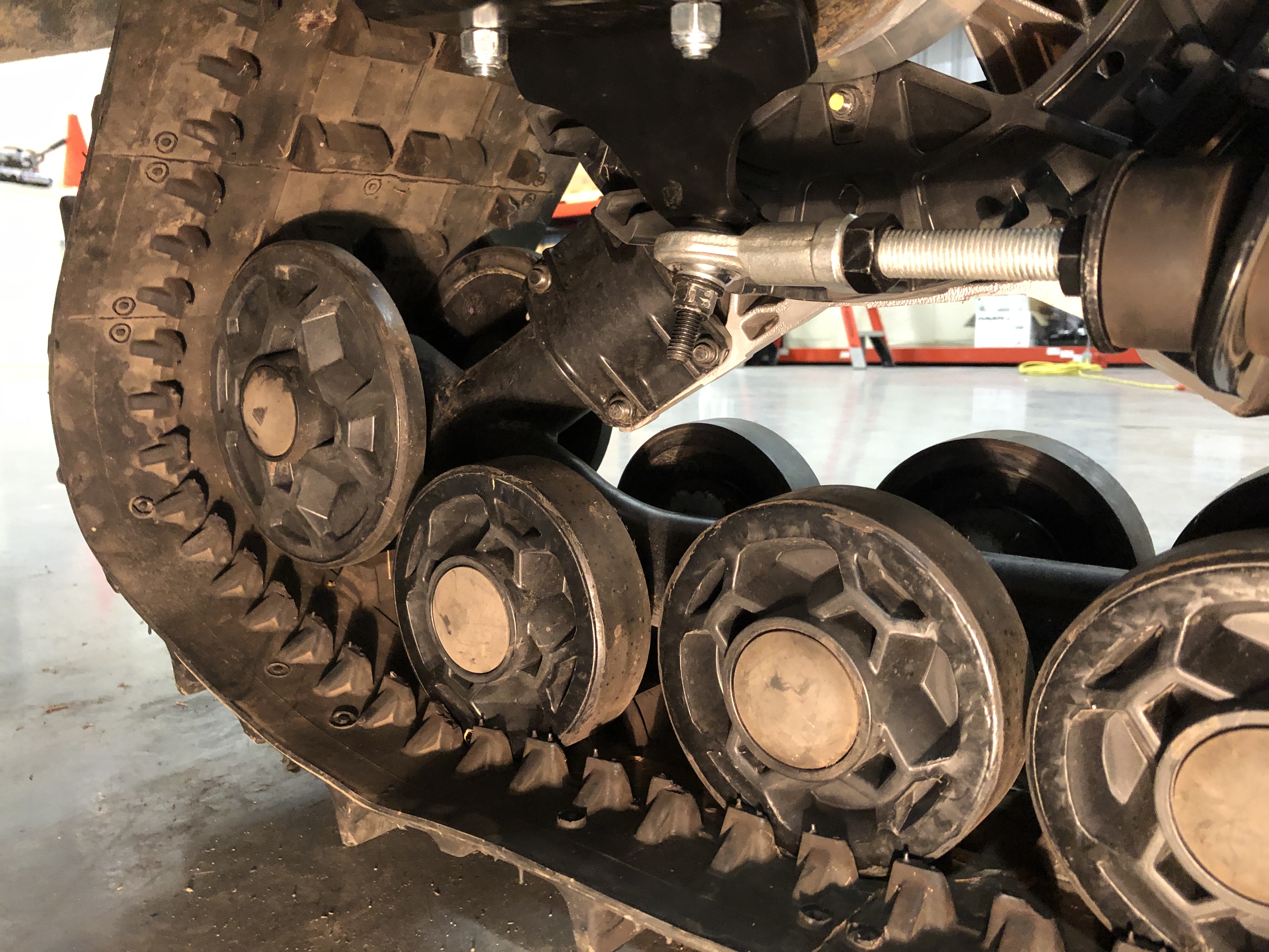

Pretty much done. Usadapters.com provided the 156-137 mm plates with the 10mm studs. The rear was an easy bolt on. I had to add some spacers inside the Heim joints as the Polaris is 10mm and the CanAm is 12.
The fronts were a little trickier. The CanAm steering limiter is quite different from the Polaris. I drilled a new hole in the plate and countersunk it as the top needed to be flush to avoid interference with the control arm.
Added a spacer inside the Heim joint.
I did learn something. Metric and SAE countersinks use a different angle. My local hardware store only had the SAE version bit. So the bolt for the limiter is SAE. Everything else is metric.
Hoping to get it out on the snow soon.
